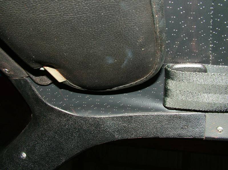

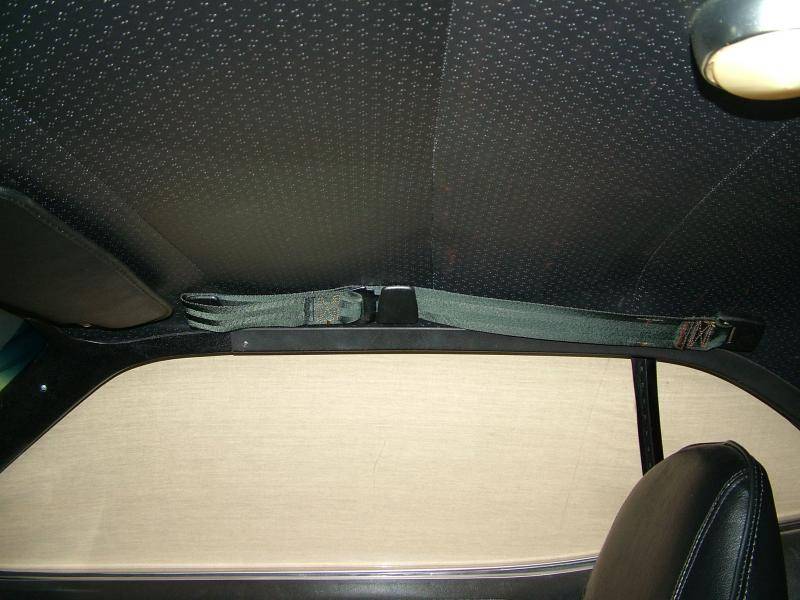

Does anyone have a picture of the rear seatbelt retractors for a 71 challenger? I also need the location for the shoulder harness on the roof. I could use the measurement from the rear clip to the mounting hole. The headliner and all trim is in already.

Here are some pics of the passenger side. There are two belt holding clips and one anchor point. The first clip is 8" from the windshield top edge, the second clip is 9" from the first clip, and the anchor point is 17" from the second clip. Hope this helps you out.
