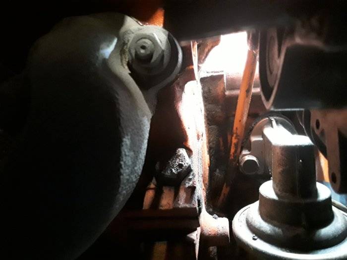

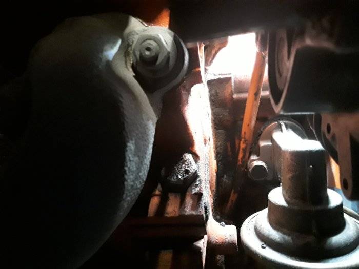

On my 71 challenger 340, its bent slightly back towards the head. I took a photo. This tube has never been removed.

I just reinstalled mine yesterday and it was already bent since it was used before. The bend is a little higher up from the base. It is a very slight bend. It doesn't have much clearance from the fuel pump or timing chain cover.
