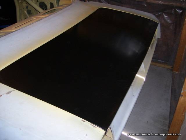

Myrtle Beach SC

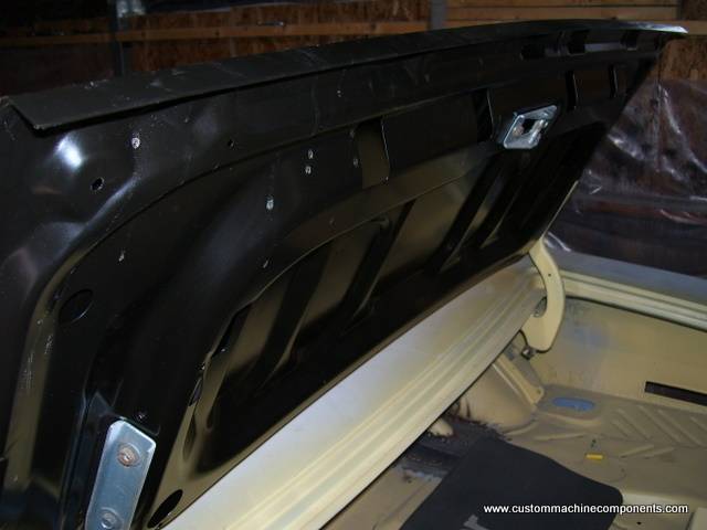

I bought a new AMD trunk lid from Elite Custom Autobody., Fits nice , good quality,only minor tweeks. I now have one less body panel to finish. I ordered it on a monday and had it on a friday. Awesome service

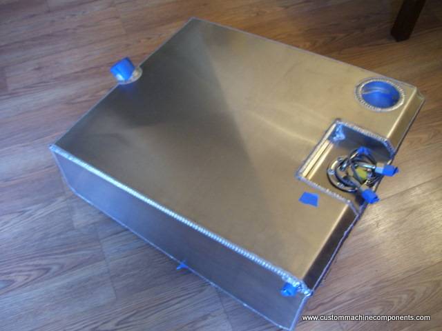

Nice. What are you planing to use for a gas tank?

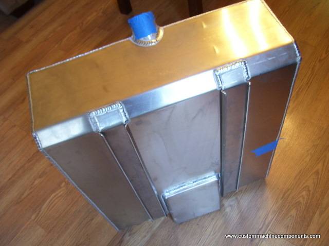

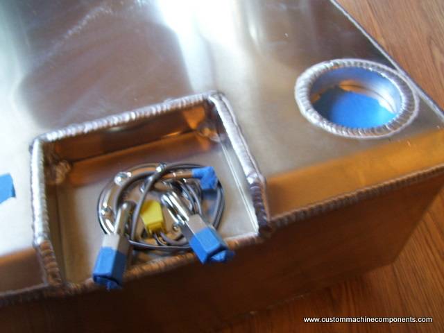

I have a Hot Rod City Garage custom Baffled Aluminum gas tank with the walbro in tank pump. It uses the stock straps , and filler tube. I will have to have a return line so I plan on using a filter regulator off a C5 corvette to complete the fuel circut

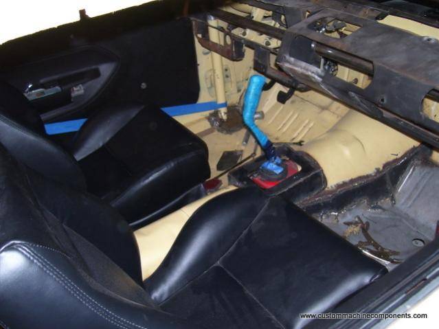

Myrtle Beach SC

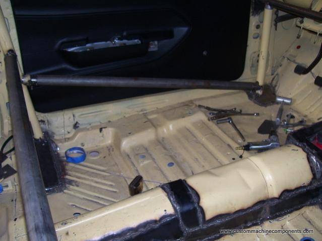

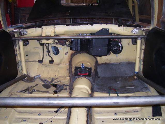

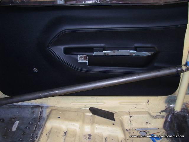

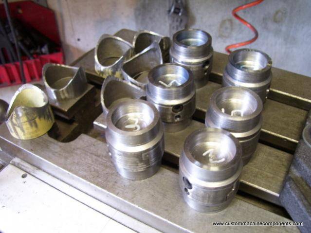

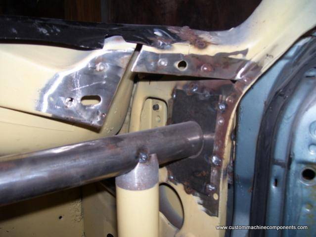

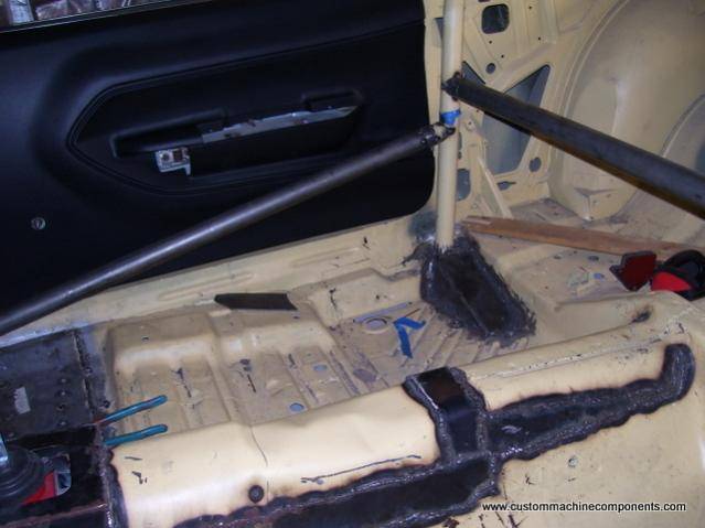

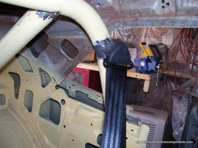

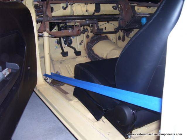

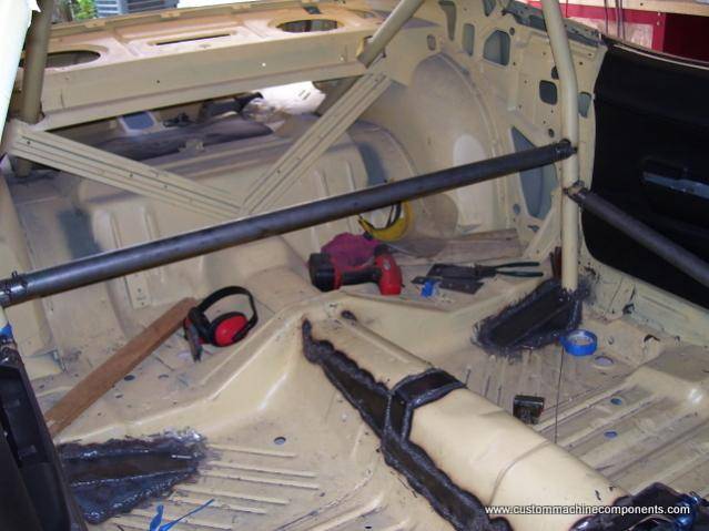

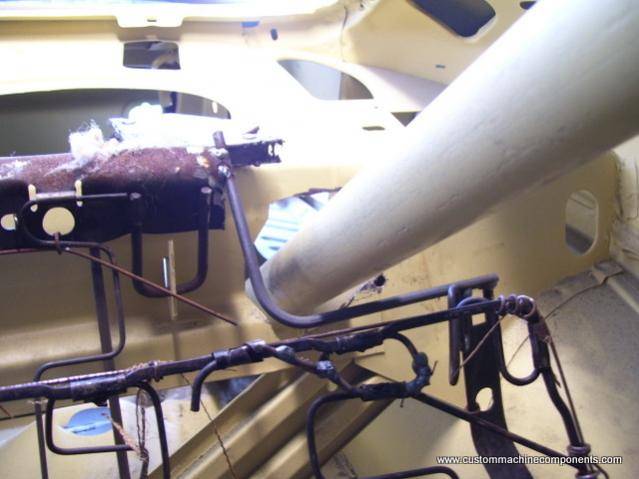

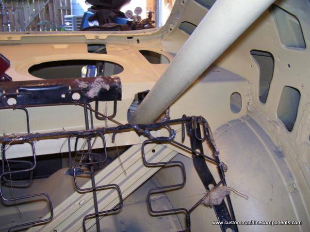

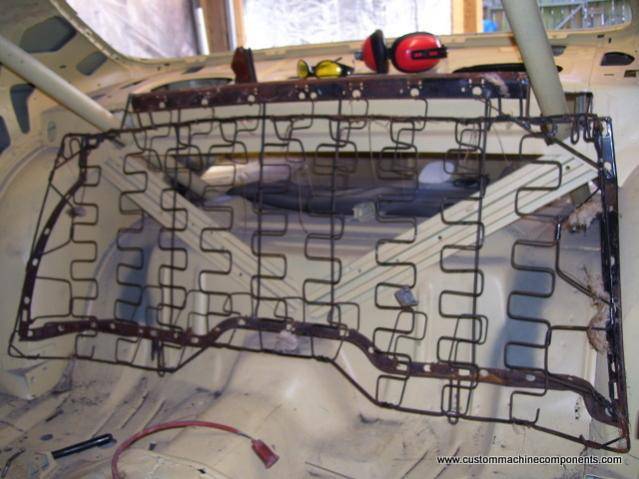

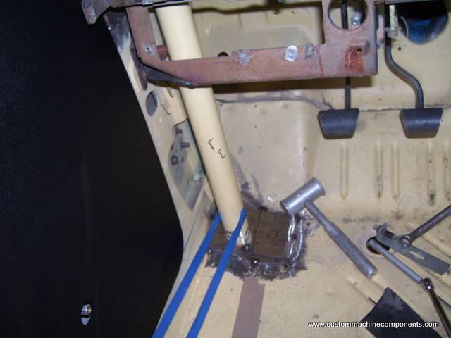

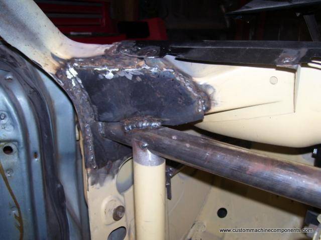

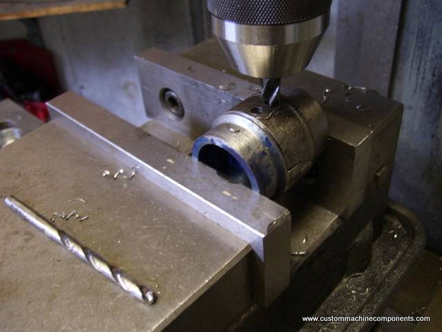

I moved to finishing the roll cage, I wanted the rear cross bar and side bars removable. After looking at some cage bungs ,I decided on making my own. I was careful to make sure the bars didnt interfere with the seats or door panels.

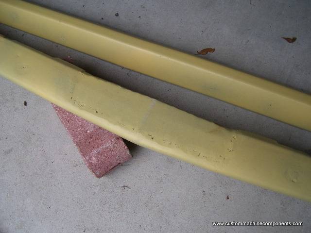

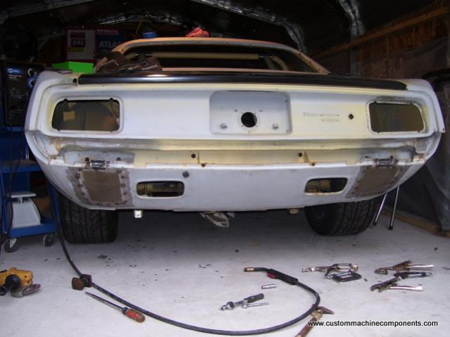

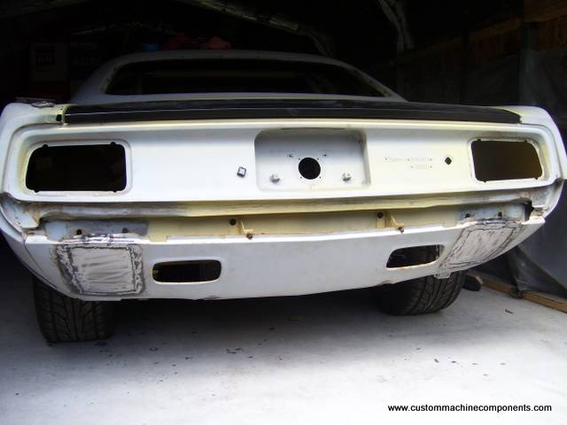

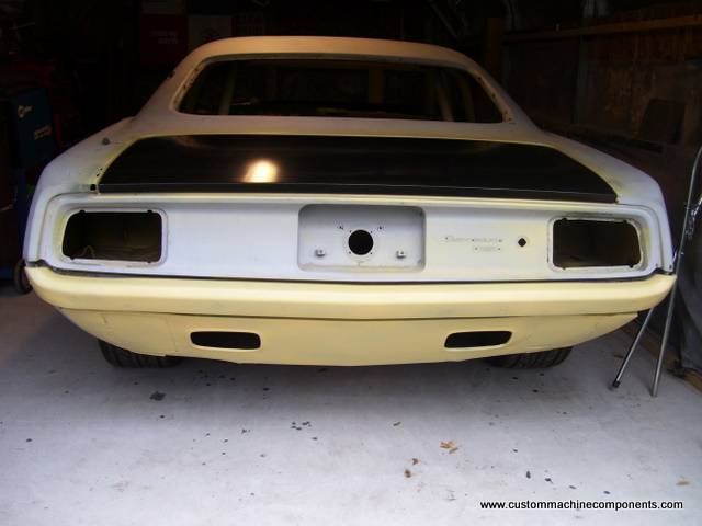

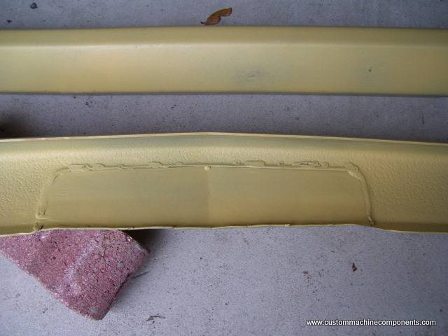

Since I dont have leaf springs anymore , I decided to delete the rear bumper gaurd and shackle area on my rear valance for a cleaner look.

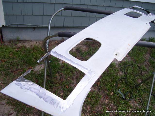

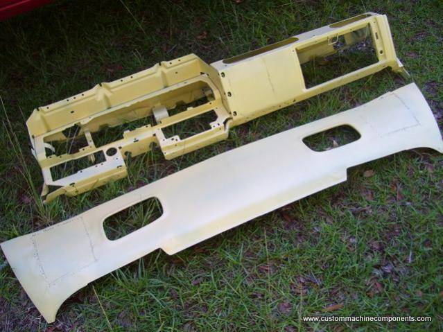

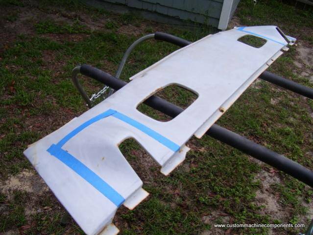

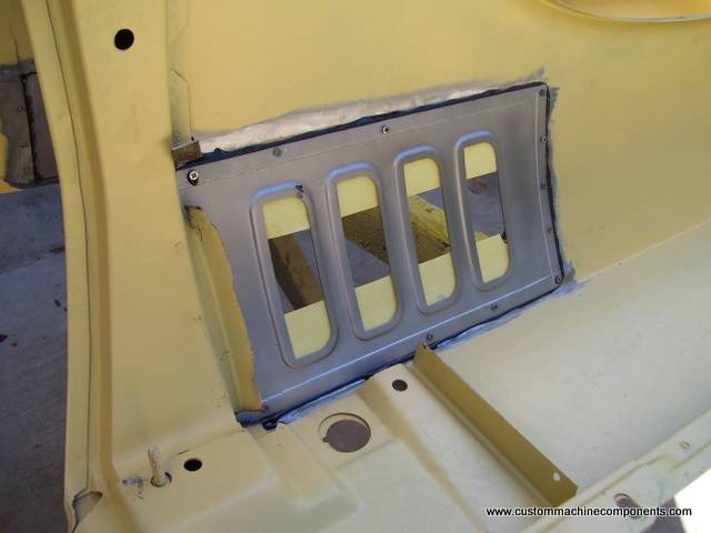

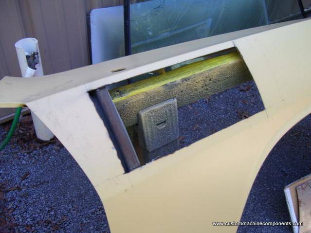

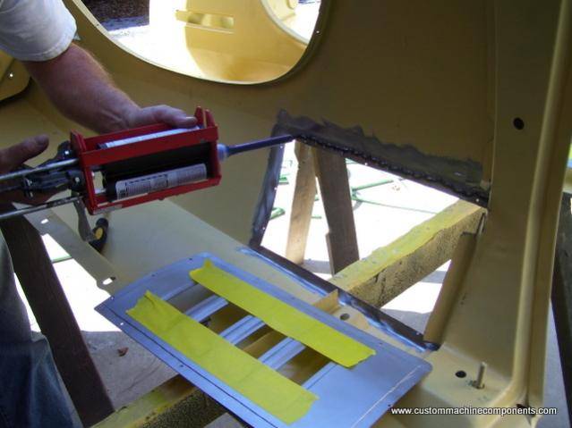

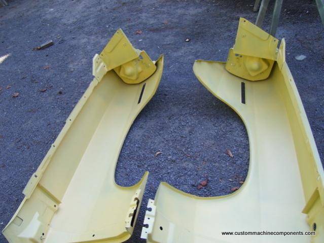

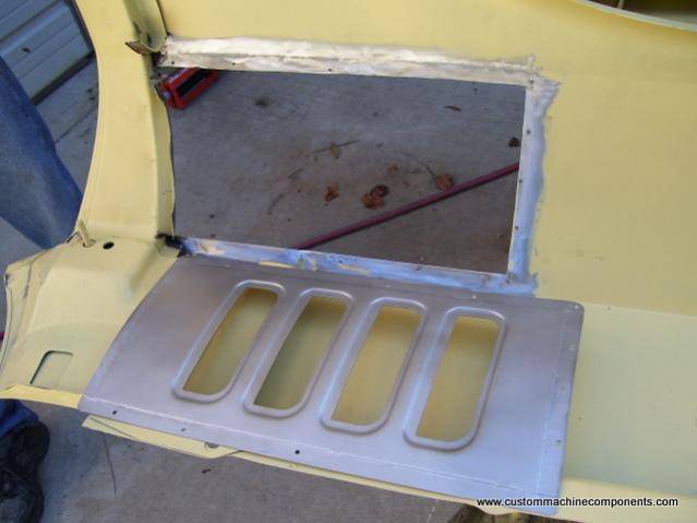

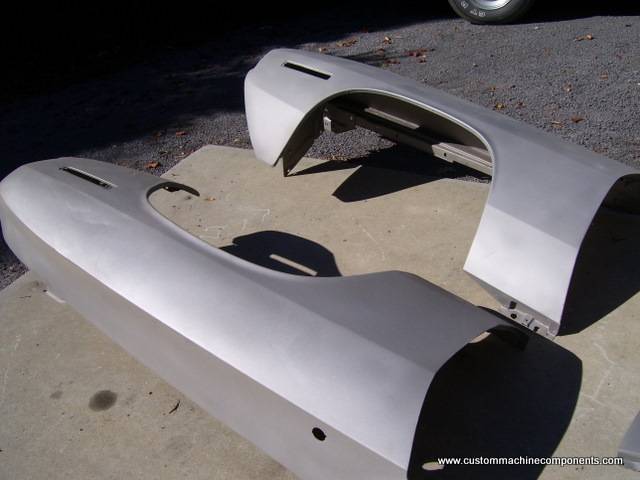

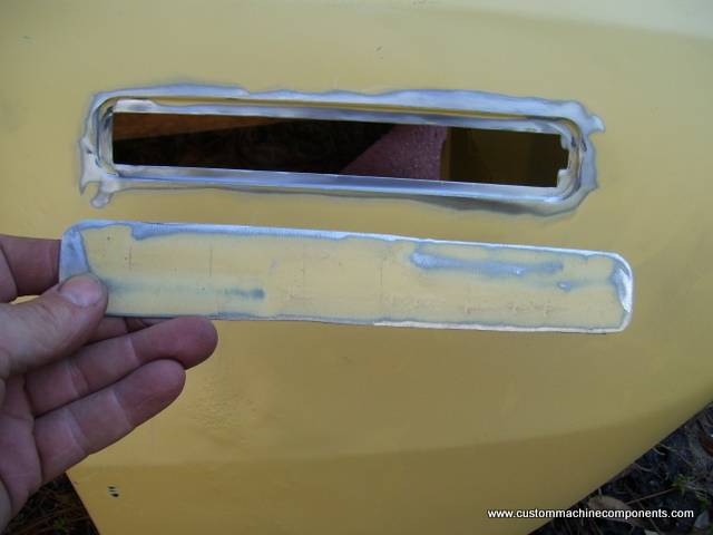

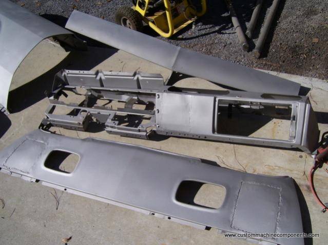

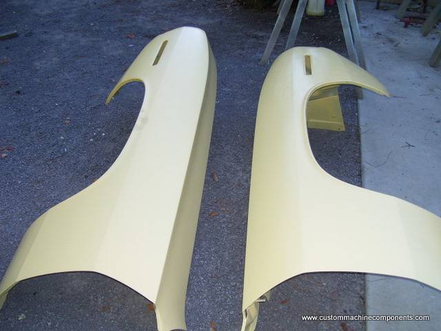

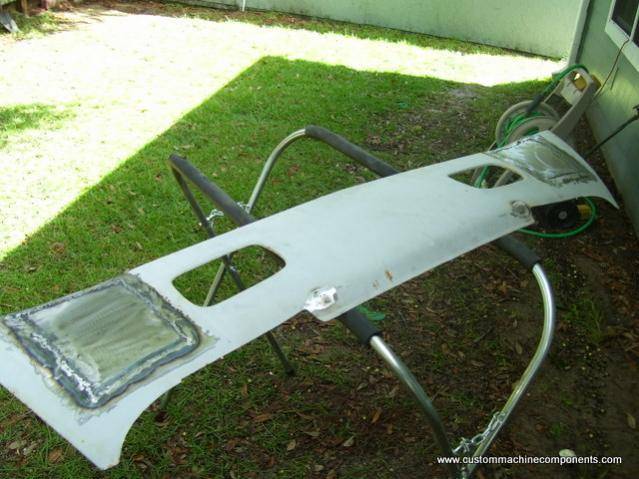

Media Blasted fenders, Rear Valance , dash cage, and header panel. Everything was treated with epoxy primer. The fenders then were cut out for the gilled sections. after prep, they were glued in with SEM panel adhesive to eliminate warpage and welds showing through the black paint in the sun.

K Pax
Nice work, I especially like how you did the rear valance.

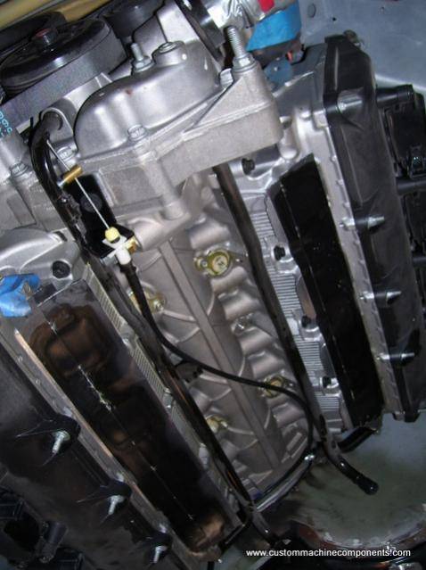

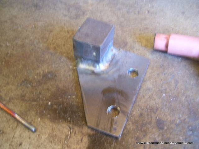

Myrtle Beach SC

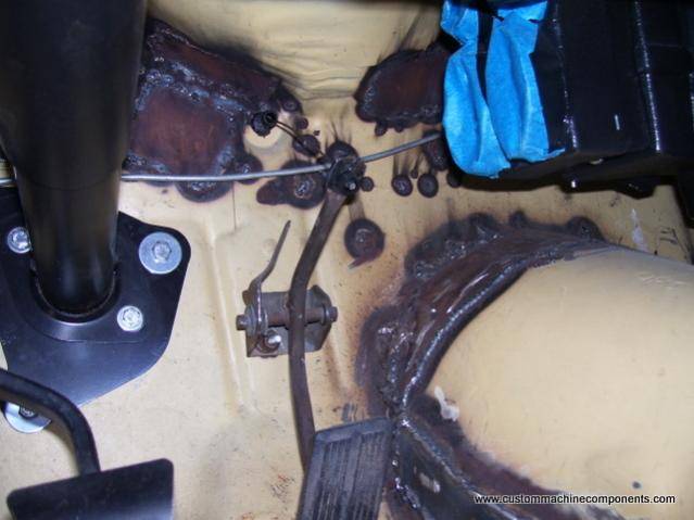

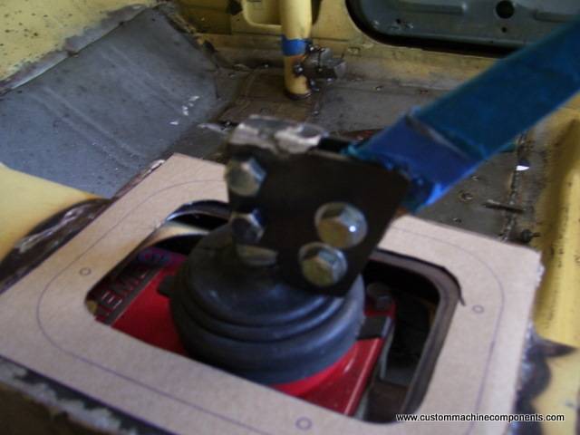

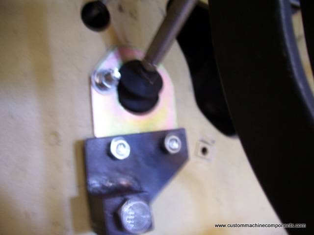

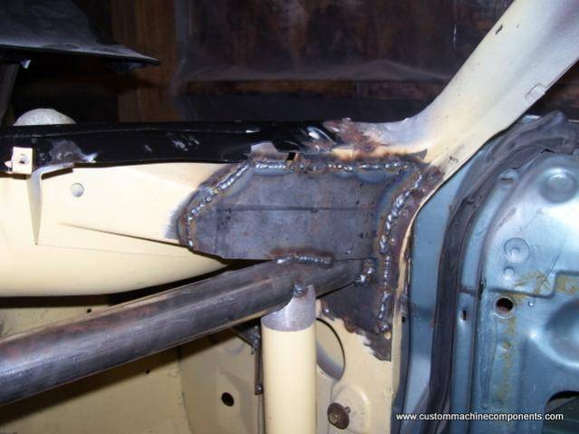

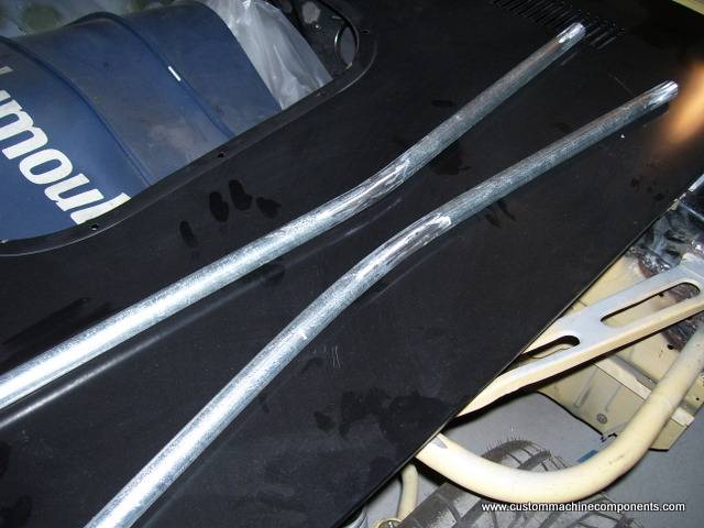

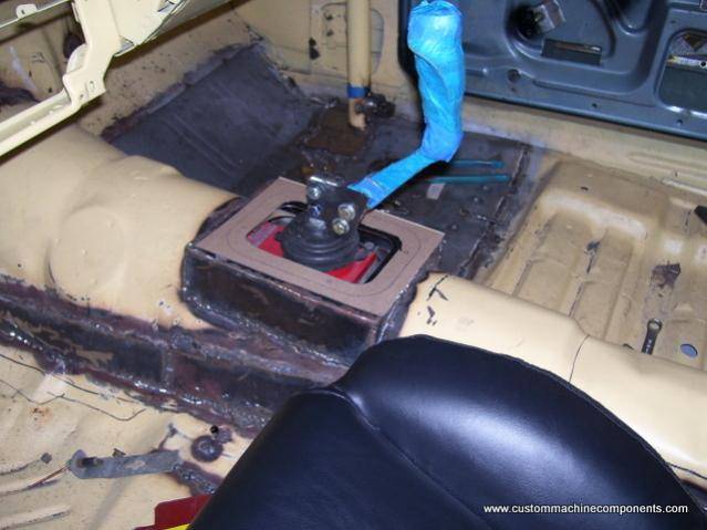

I made some wiring tubes out of som 1 inch conduit(so I can hide most of the wiring uder the hood). Other items complete was a shifter braket to angle the pistol grip shifter back 25% for a better feel , A custom made ajustable stop for the hydraulic clutch and mocked up the gas pedal and throttle cable for the fuel injection.
73 kooda
Apr 8, 2011
110
Las vegas,nv NATIVE

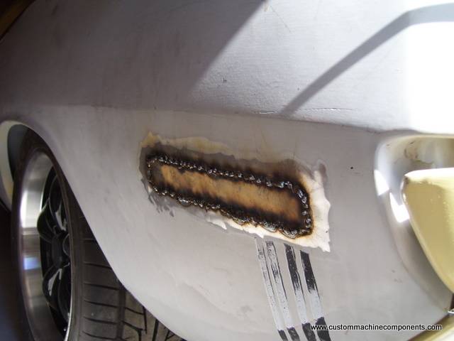

Looks like you got your wire speed a little high.... Car looks amazing!!!im guessing your using a mig. What kind of welder do you got?? Awesome work...

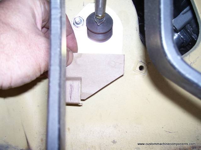

Myrtle Beach SC

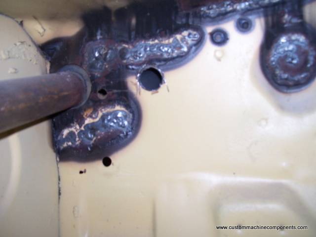

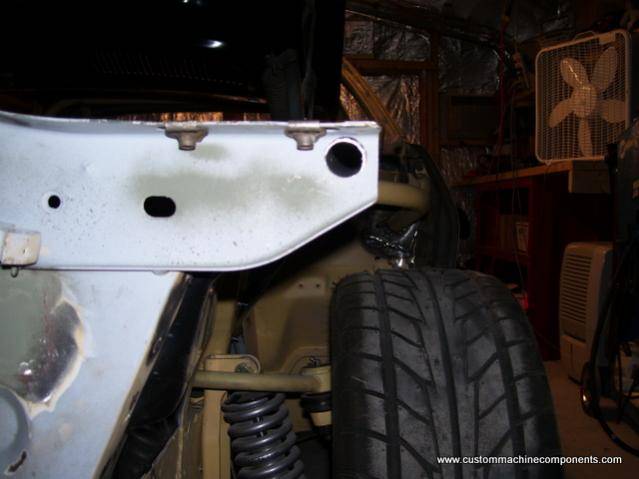

I had to make some new windshield corner brackets out of 3/32 steel plate because the cowl bar was in the way of the originals. Other mods are filling the bumper bolt holes and welding 3/8 studs from behind and deleting the front buper bracket area. This give a much smoother look. I will have to shave the bumpers to tighen up the gap between the bodu and bumpers.

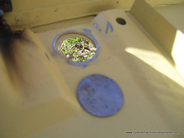

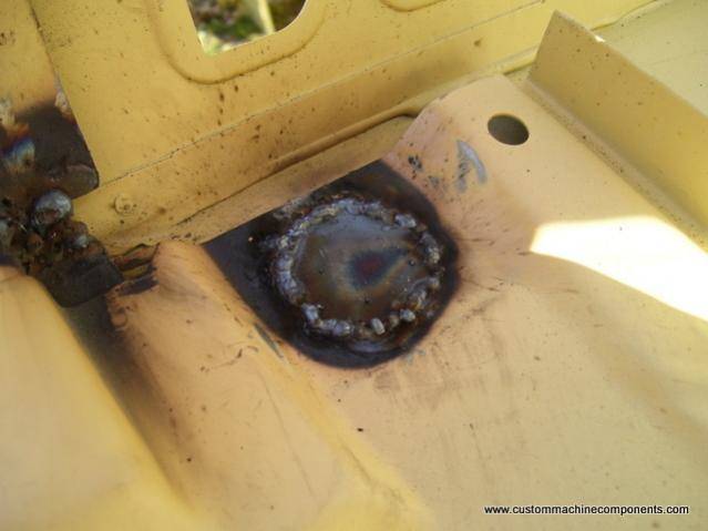

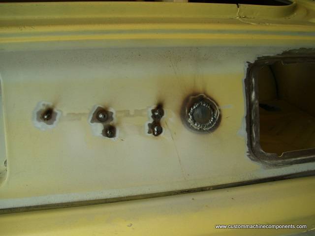

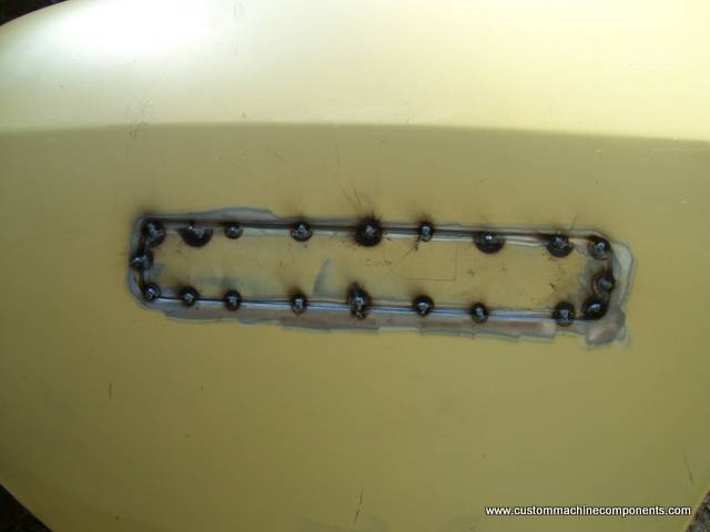

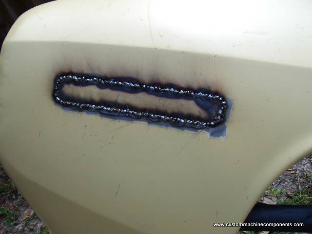

More progress on the body. I welded the side marker lights holes shut. Also the trunk lock (I plan on a remote trunk latch from a 70s Imperial) and antenna hole :3gears:

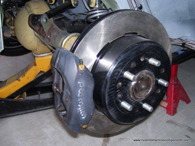

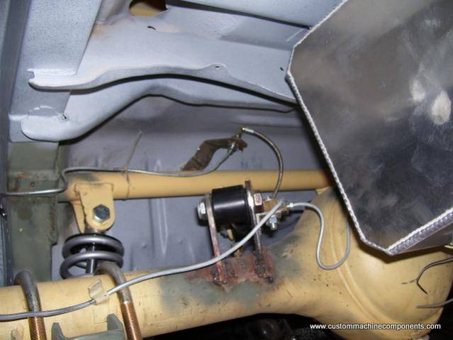

Fished up the rear brakes and brake lines. I am using wilwood Rear discs and 3/16 custom bent brake lines from the master cylinder to the rear calipers

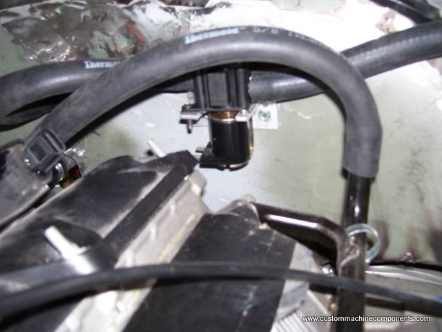

Myrtle Beach SC

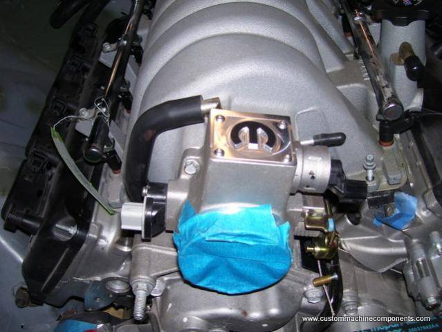

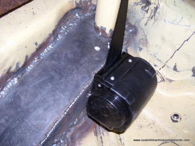

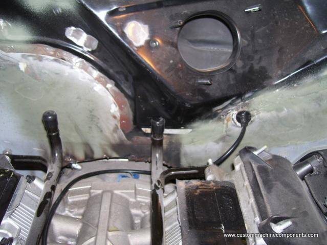

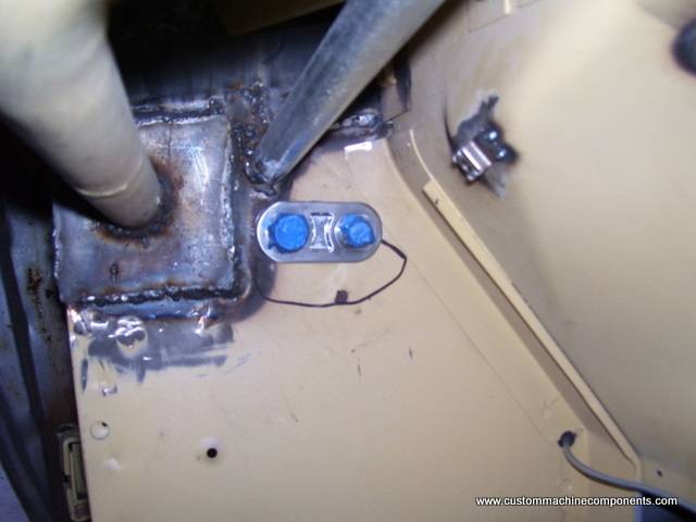

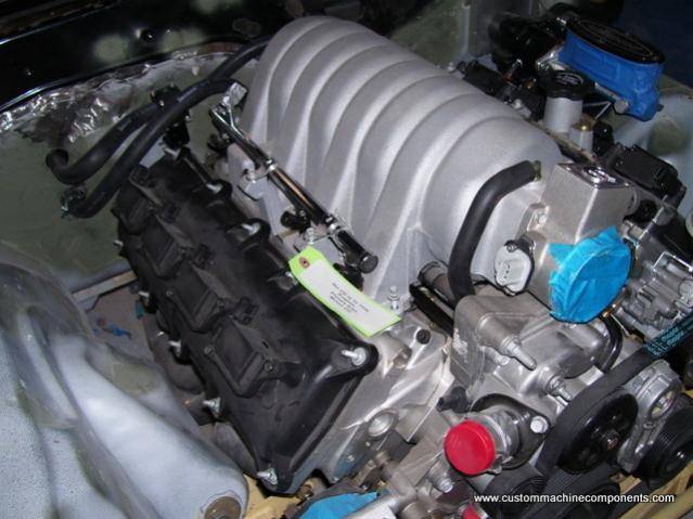

More Progress, Items installed , A/C port passenger fenderwell, seat belt harness mounts, cable mounted throttle body, and the heater water temp valve and hoses.
