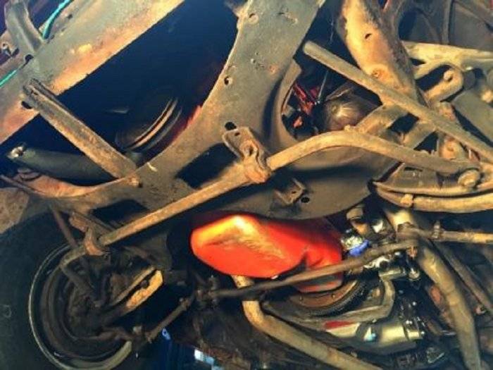

Really cool that you found factory markings on the carrier
As I cleanup and rebuild my A66 front suspension, I found paint markings on the center link, ball joint/suspension bolts and the remnants of the organosol dip line on the LCA's. Can't wait to see if any markings remain on the carrier?

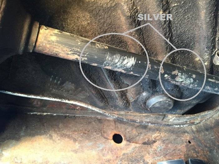

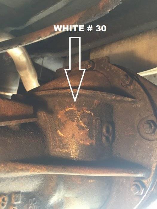

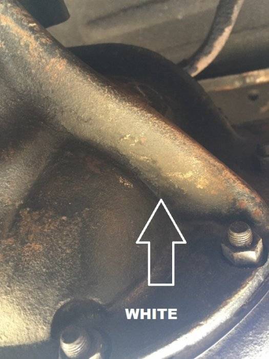

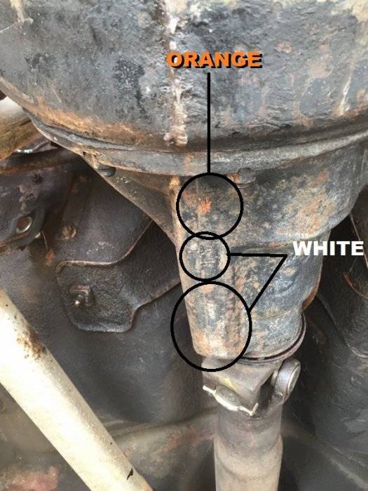

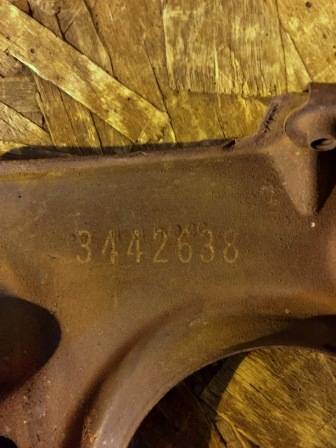

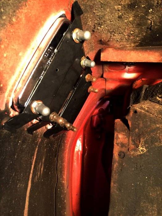

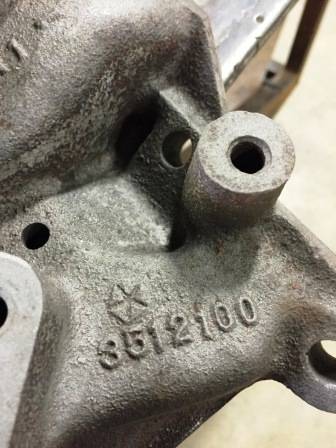

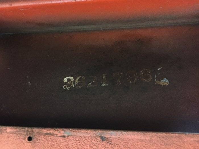

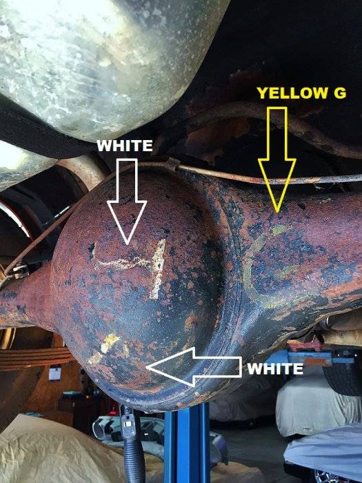

I'm hoping that there are some paint marks on the front suspension once I rebuild it, the rear carrier I added out of the AAR donor 27 years ago and its a 3.55 sure grip, the coded ratio should be a 3.23 sure grip so the paint daub colors are different. Here are a few more paint marks I found yesterday. I also found another part number located on the bottom side of the front header panel for anybody collecting details.
Thanks for looking.

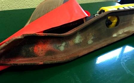

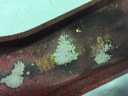

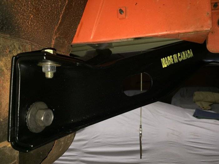

Akron,ohio

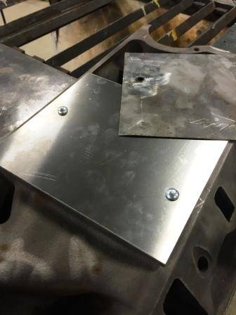

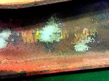

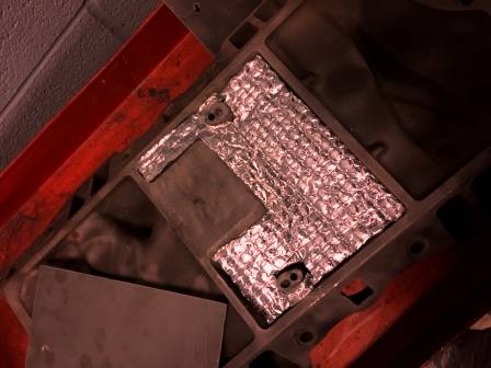

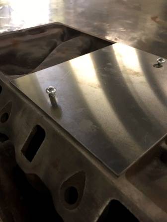

I decided to take my bumper brackets into work today and sand blast them before having them powder coated and after the first layer of overspray was removed I thought I saw some yellow letters. I removed the bracket before to much damage was done and snapped some pictures of the MADE IN CANADA paint stamp marking. I have been dealing with Sylvain at 71SG.com and he has the stamp I need to place them back on the bracket after powder coat. I love finding all these original marks. I also removed the heat shield from the intake manifold to clean out any junk and oil under there but it was very clean so I made another and slightly thicker shield out of 301 stainless steel and placed a piece of heat barrier material inside before reinstalling the new shield with some original style rivets I got from Bill Rolik.

The part # on the header panel indicates that the part was once NOS and had been replaced. I don't believe assembly line parts had stenciled numbers on them.
Cool stuff.
Thanks for that information.....I didn't realize that but now that you mentioned it that makes sense. I wonder if that means the right side headlight bracket was a NOS replacement also.

Small update...Installed a Original Grille that came with the car, I had to fix a few real small cracks. I had the bumper brackets powder coated and reapplied the correct "MADE IN CANADA" stamp marks. I also refinished the marker lights. I know easy stuff, but its all I have for now.

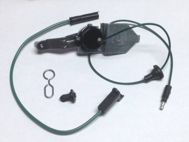

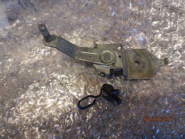

I was missing the Clutch Pedal Safety Switch so after tracking on down on the forums I had it sent directly to Jim, at JS restorations and had it completely rebuild. Here is the switch after restoration and the way he received it.

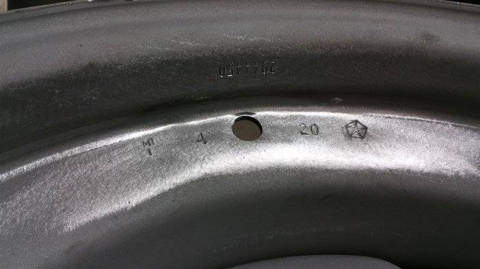

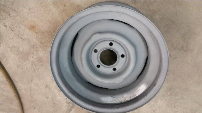

I have been in touch with Dave Wise from MMC Detroit in regards to the codes and options, He informed that the 1 in the Dom. Public was the code for Military sales. The car deserves to put back as correct as possible in my opinion, I finally have a set of date coded 2944450 wheels that are scheduled to be delivered Monday (March 20). I'm having a real tough time deciding if the Vinyl top will go back on or not though.

Its not a concern over holding up to the elements, it's strictly a visual thing. Sort of like the look of dual painted racing mirrors over the correct manual single chrome one...another struggle I'm dealing with putting back on.

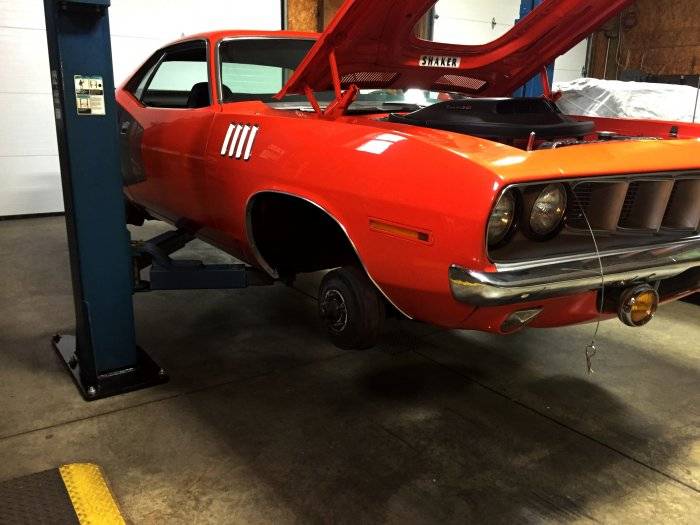

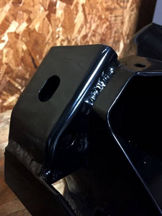

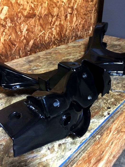

I've been doing some small but needed stuff on the 'Cuda the past couple weeks, I got the correct E body K frame powder coated, the closest percentage of gloss to factory was 75%... luckily he's a mopar guy and understood the importance of having the correct colors and shine. I also used the Tig welder and burned in the crappy factory welds and also reinforced all the seems. I managed to get the car all legal and had my specialty made plate put on the registration, I also found a guy on eBay selling side marker light nuts and they work perfectly for the few missing fender louvers studs, I heard they were hard to find so I bought 40 of them and will swap all them out when the real restoration starts.The car is anxiously waiting for the 450 wheels to get painted, I decided to upgrade to a set of the Goodyear Polyglas F60-15's, instead of the E60-15's. I know it's not the correct size ......but at least their the correct type of tires.
