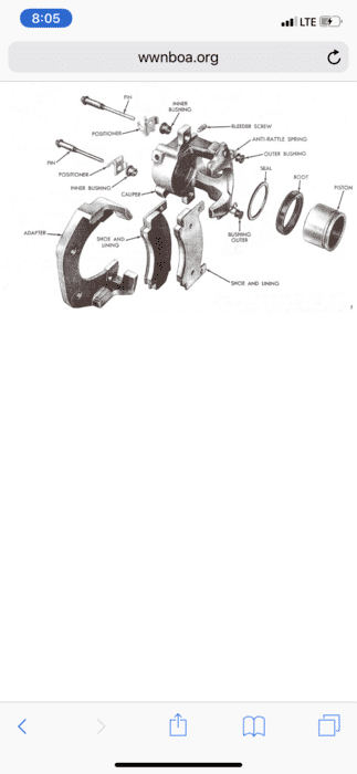

Thanks in advance, I purchased this cuda and I am doing final assembly and the front rubber brake lines are wrong. The threads are too small. The calipers I have are "big bore" is what I was told. They have the large bolts that go through the back.

This is it

Sounds like you might have B body calipers, which use the square-ended hose with the "hollow bolt". It's too early for me to find the right terminology, sorry.

The brake lines look exactly like 72 e body lines except the only difference is the threads that go into the caliper are larger

Are you sure you have the correct brake hose? Your brake lines are more than likely correct, but you probably have a hose for manual brakes.
