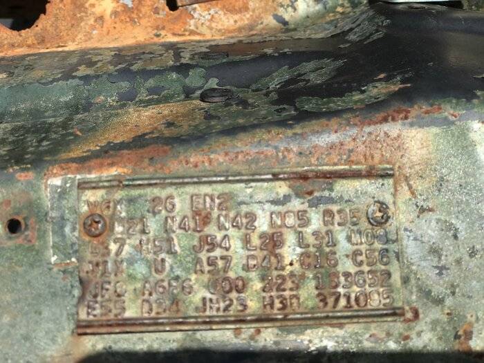

So I bought a 73 challenger today, been wanting one for 30 plus years. Found it in OK shape, everything seems to be there. Except the engine, and maybe some other minor parts. Here's my question, as a newb, but someone who has been reading up on the 73 challenger.... This car has the correct fender tag (matches the VIN how it should), and I see an A57, so I want to assume this was a Rallye, and the engine was originally a 340, according to the VIN. but there are no side scoops on it, and the dash gauges are non-rallye. Do you suppose a previous owner changed the dash gauges ? What else could I look for to determine if this was originally a Rallye. Or does the fender tag alone suffice? Thanks

Ok so I have reviewed this tag and your car is definitely a Rallye (A57), it should have the fender louvers (M08) and it had a tach N85 which I believe should be a rallye instrument cluster.

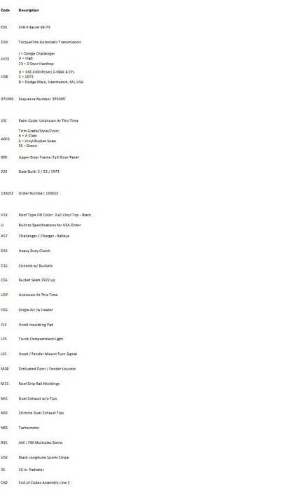

Here you go. from chrysler corporation production option code book 1972-1974 fifth edition august 2007.
E55-340 8 cylinder 1-4bbl 240hp
D34-standard duty automatic transmission
J-Dodge
H-High
23-2 door hardtop
H-340 8 cylinder 1-4bbl 240hp
3-1973
B-Hamtramck, MI (build plant)
371085-Vin sequence
JF8-Dark green metallic
A-a class
6-vinyl bucket
F6-green interior
000-full door panel
223-february 23rd 1973
153652-build sequence number
v1X-black vinyl top
U-
A57-Rallye package, sport hood, black grille, simulated fender louvers, HD suspension, rallye instrument panel-type 7, longitudinal sport strobe stripe,f70x14" WSW tires
B41-front disk brakes power drum rear
C16-console
C56-bucket seats
G37-Left hand remote/right hand manual outside mirror chrome racing
H51-air conditioning with front heater
J54-sport hood includes hood scoops on select models
L25-trunk compartment lamp
L31-turn signal light hood/fender
M08-simulated door/ fender louvers
M21-drip through moldings
N41-dual exhaust system
N42-bright exhaust tips
N85-tachometer
R35-radio-am,fm,mx -stereo 10 watt
V6X-black longitudinal sport stripes
26-26"radiator
EN2-End of codes on assembly line 2

That's Awesome ! thanks everyone, the dash is not original and the interior is Black, so I reckon someone changed this out. Man I'm stoked, good to know.

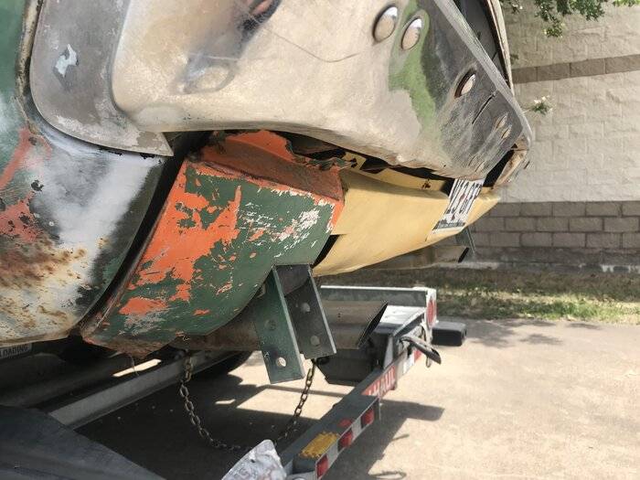

Good thing this aint my first resto! Well... E body it is. some cutting and welding, some sanding and painting. How hard can it be LOL. At least the interior is mostly all there. Not roached. Will need a Scooped hood, and for some reason, there appears to be wheely bar brackets that'll need cut off. Weird. Rear bumper lower valance is needed too. Overall, I havent felt this way about a full up resto in years !! really really excited.
