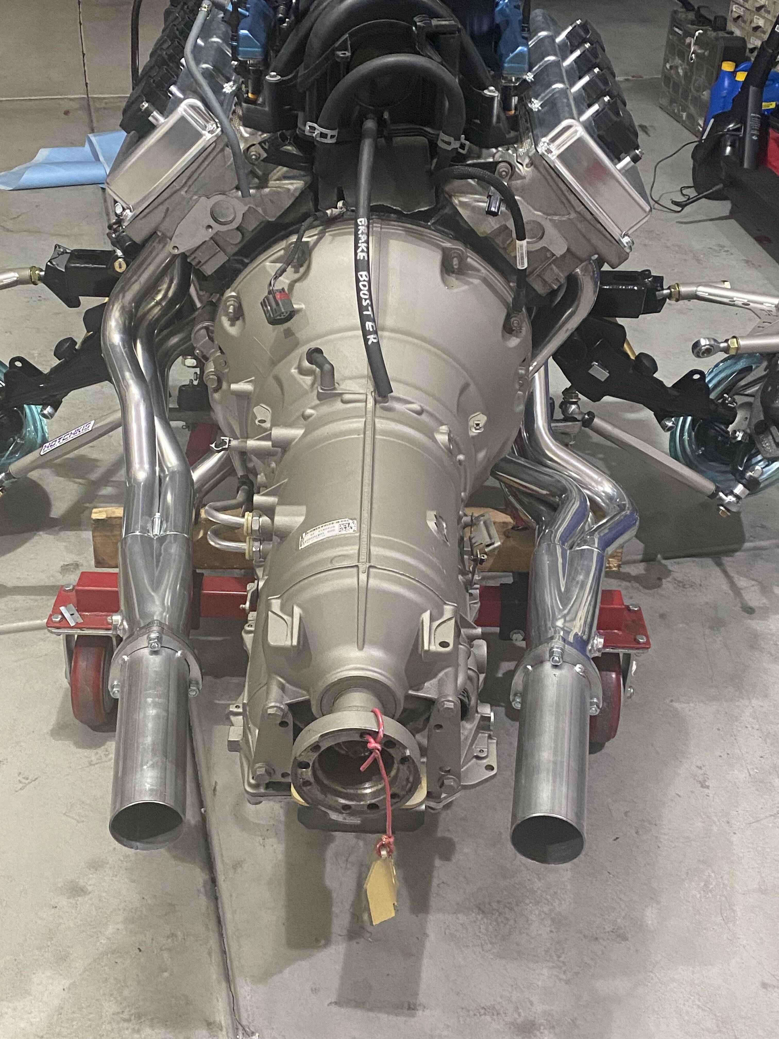

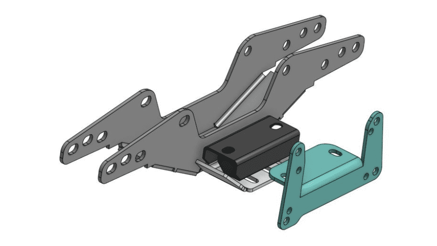

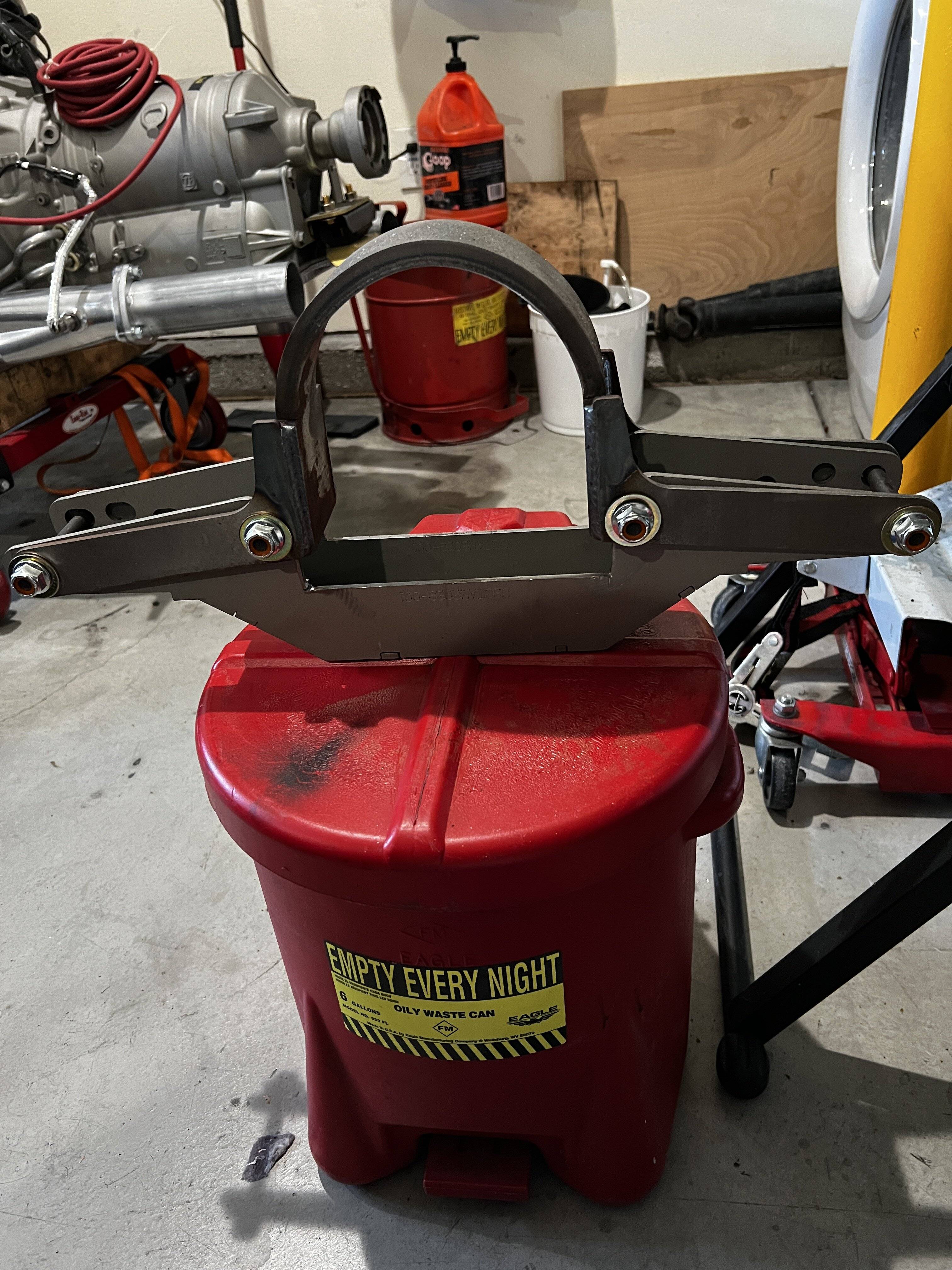

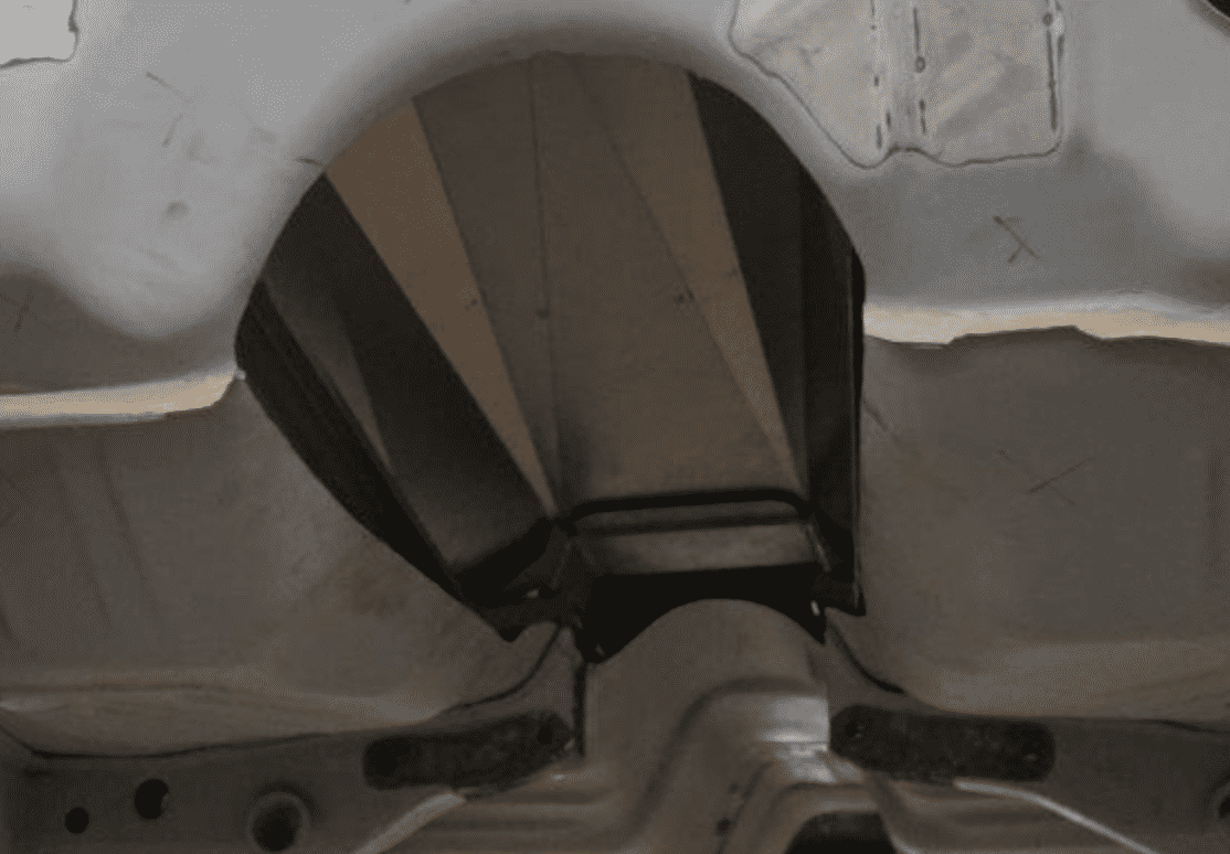

I have the 8HP70 going in my 70 Barracuda, I did have to cut the torsion bar rail to fit the trans. I used the US Cartool Trans mount and b-body reinforcement.

This is very interesting. With the new b-body reinforcement tunnel, how will the carpet fit? I've thought about doing this to a 74 Charger i have.

Not close enough to carpet yet Terry, but soon and I will post pictures in about a month to let you know

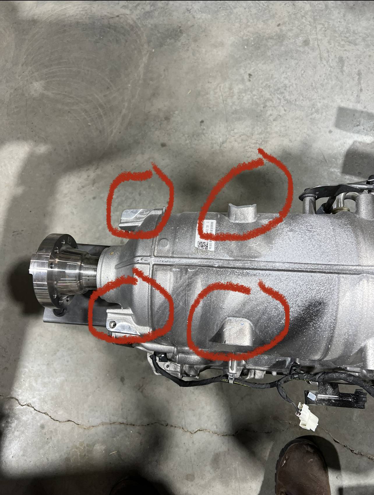

All you gotta do is get the Holley trans mounts and slightly bend back one small area on the floorpan/ firewall pinch weld in a very small area for the transmission breather as far as body mods.
Grind off the following castings circled in red on the trans case and it’ll slide right in.
If you would rather get the U.S. car and tool trans tunnel, I’ll sell you one cheap because I bought it not knowing it would fit without it.
