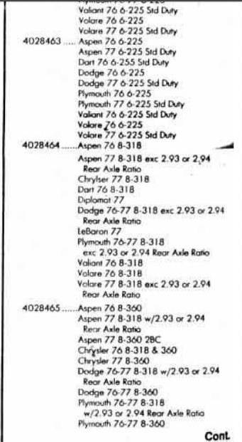

Hello,
I'm interested in buying an A904 transmission in my area. The owner gave me the following transmission numbers to identify what the transmission originally went to. I have a couple different versions of the "Chrysler Corporation Identification Numbers" to help, but can't seem to find the following number: PK402864 5200 4415 Anyone have an idea on what engine/vehicle this transmission originally went to? I believe there might be a number missing?

Could it be 4028464?
https://www.mymopar.com/downloads/transguide.pdf
