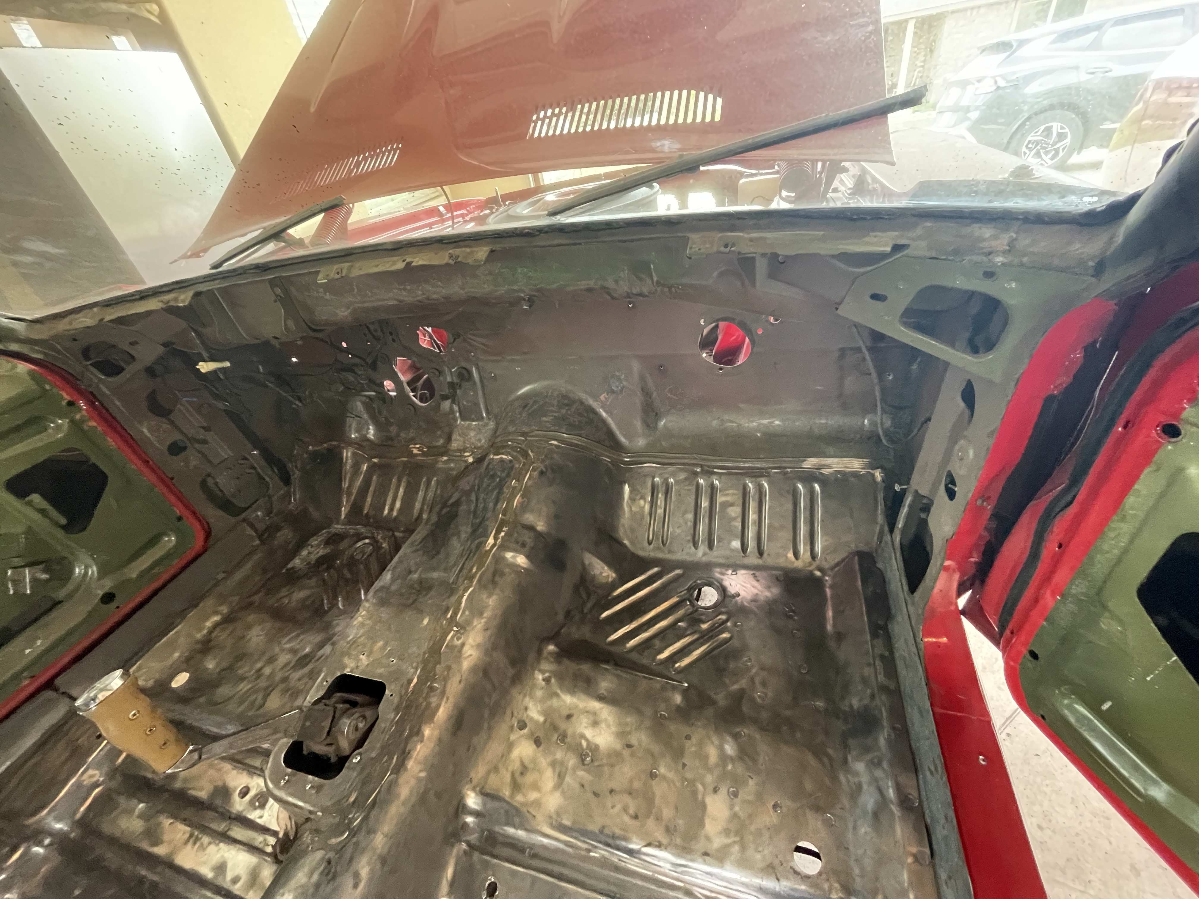

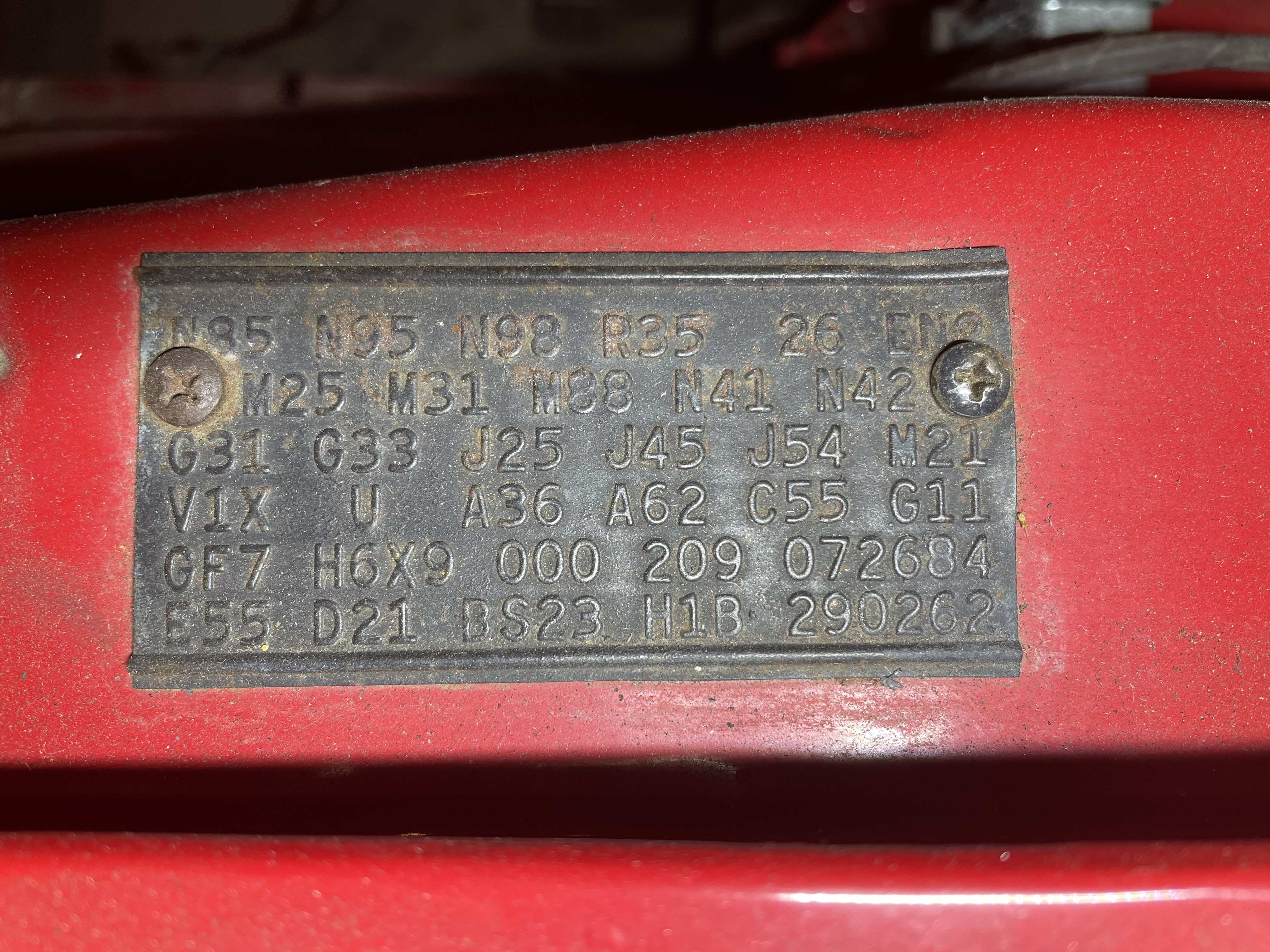

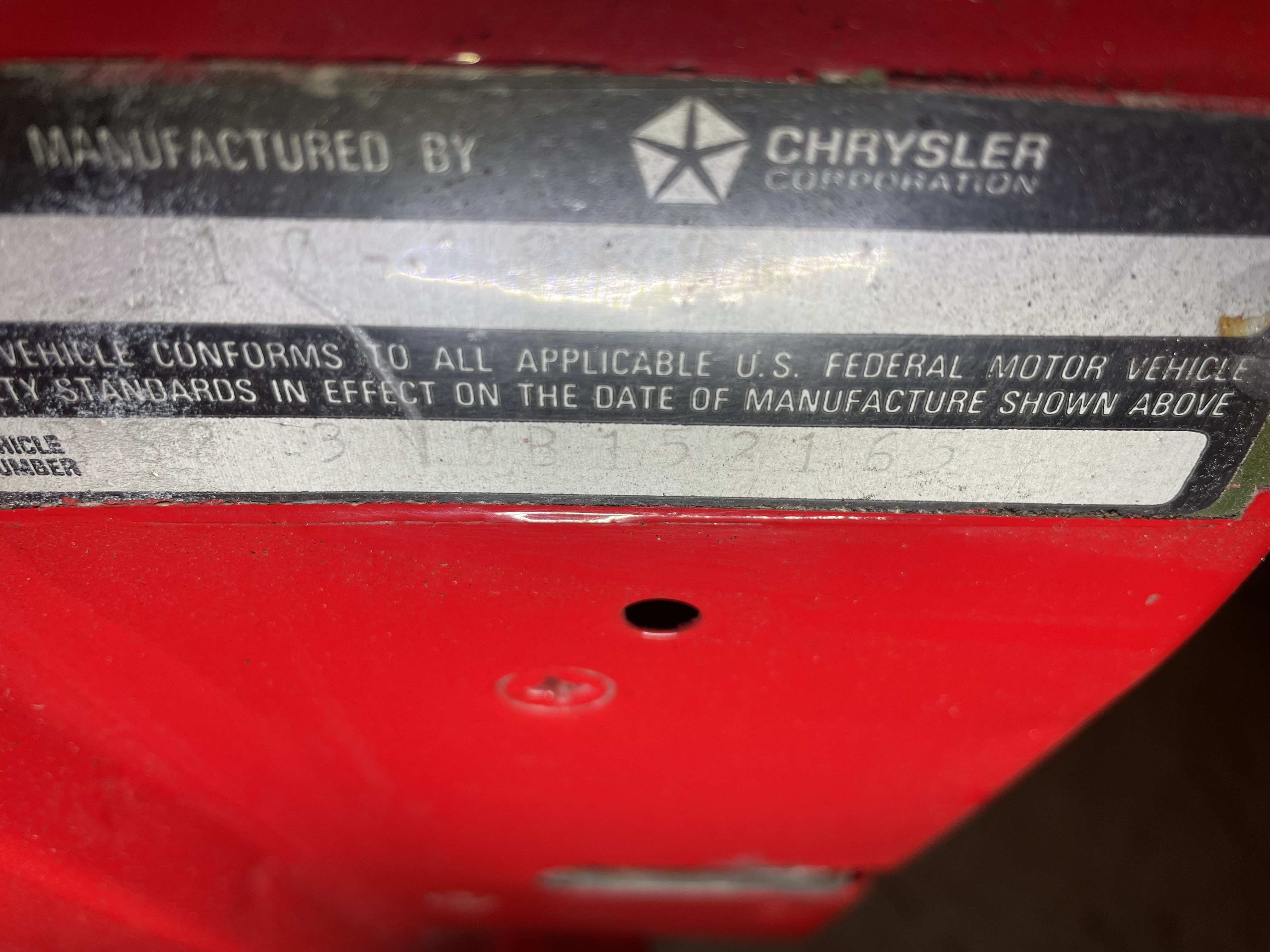

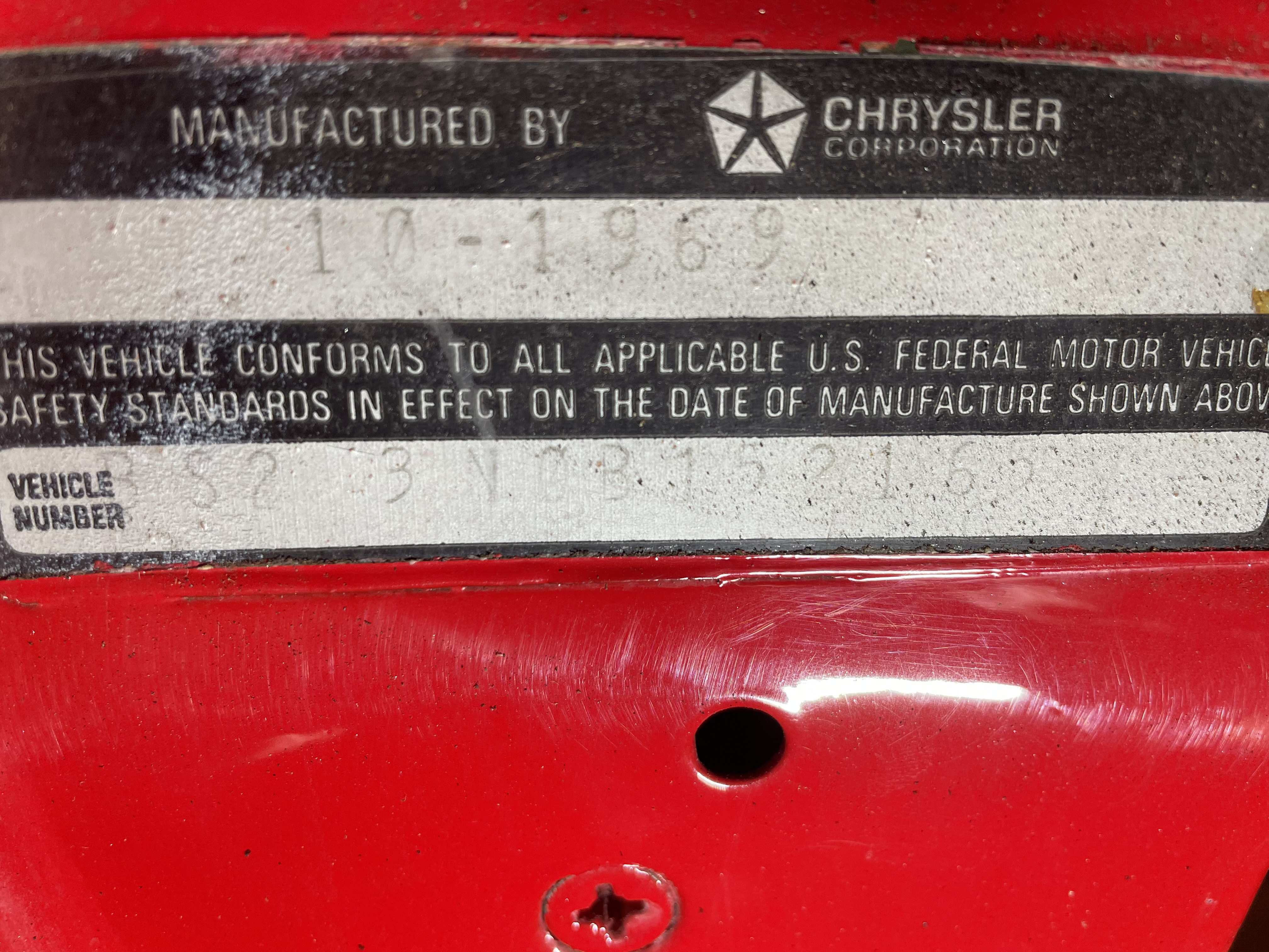

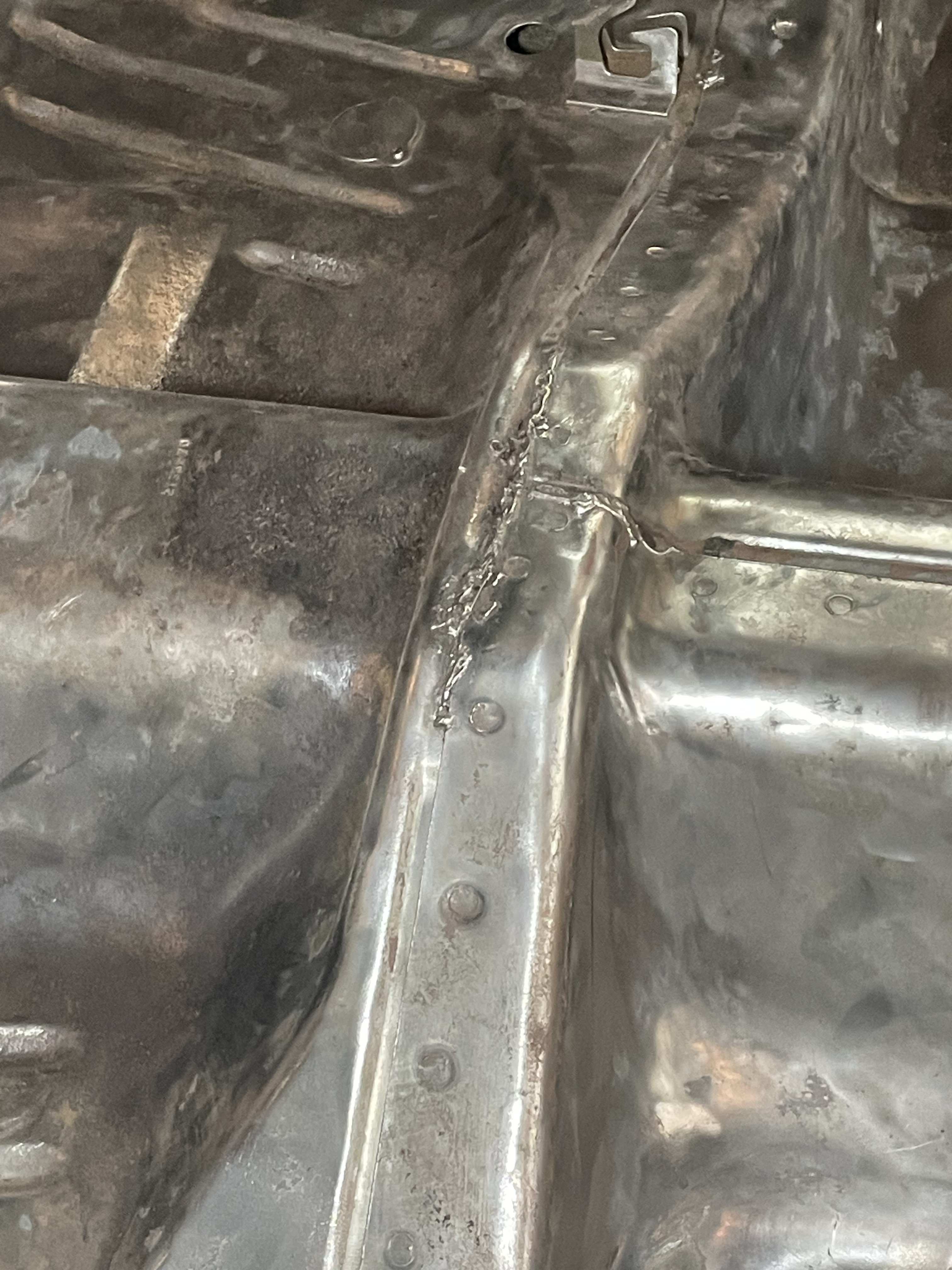

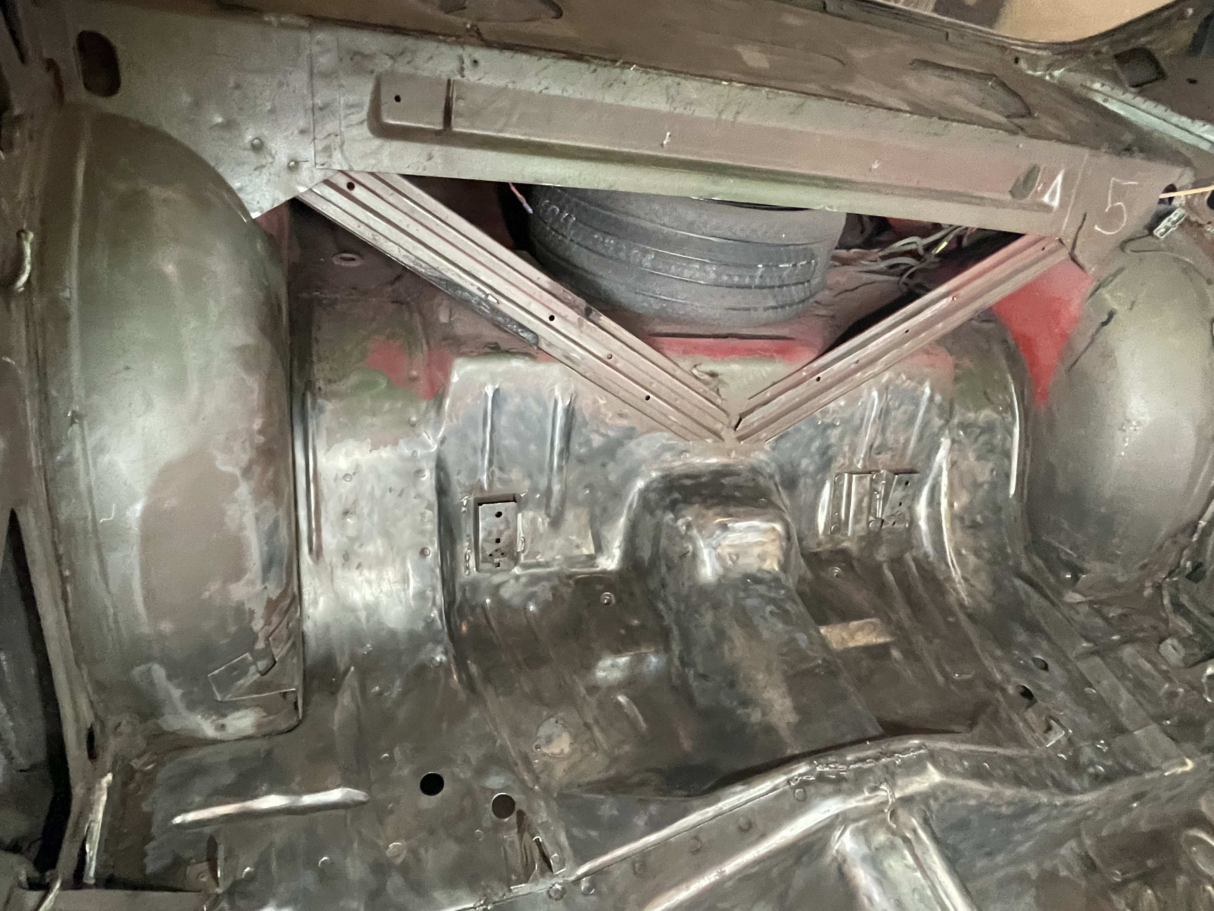

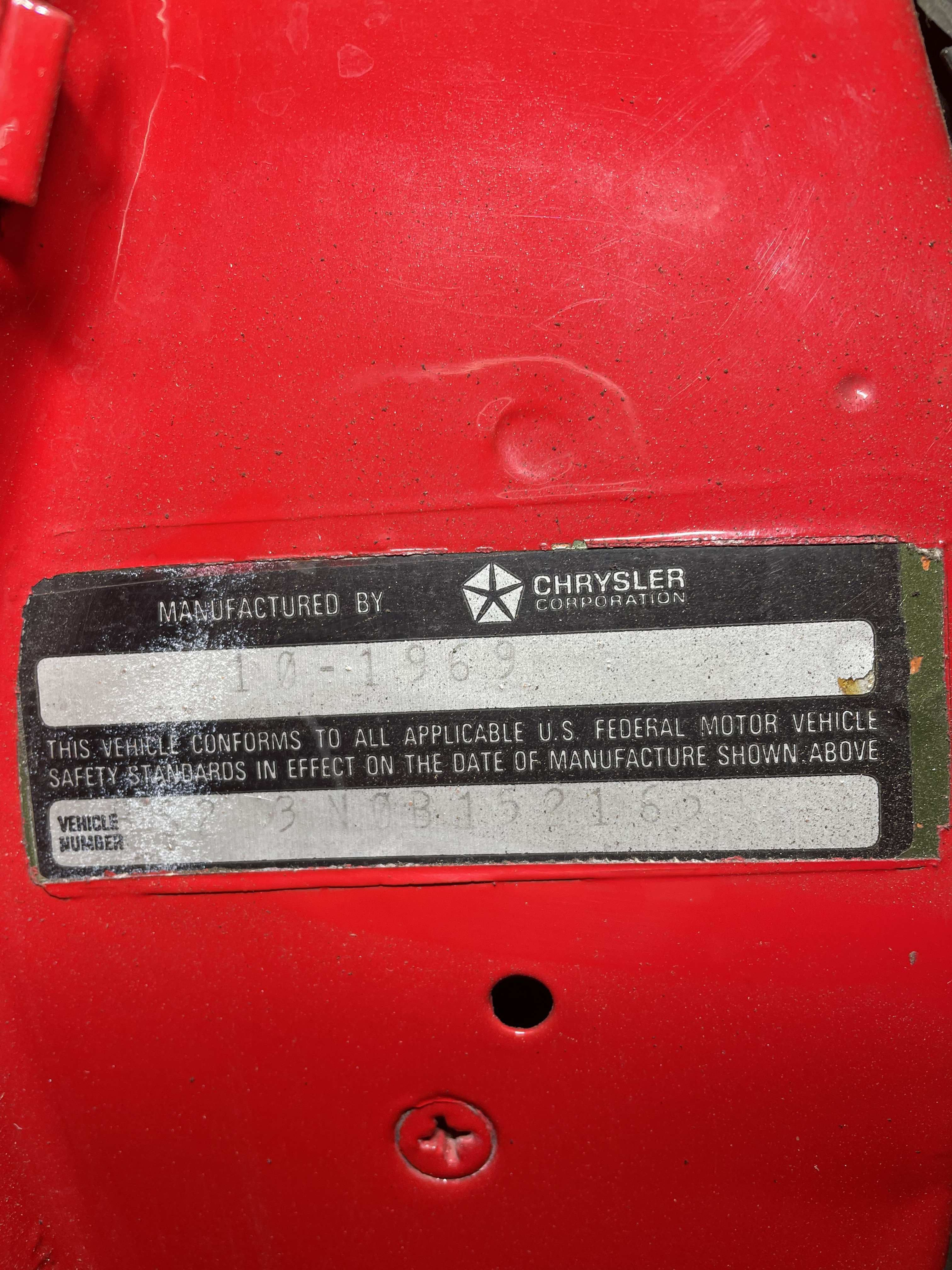

I was musing as to whether the floor pans were original in my Cuda. Turns out they are not and it was involved in an accident somewhere along its path to me. As you can see on the door code, the door is from what appears to be from a N0B car, or N is a 383 car built in 1970 in the Hamtrack plant. Is this correct?

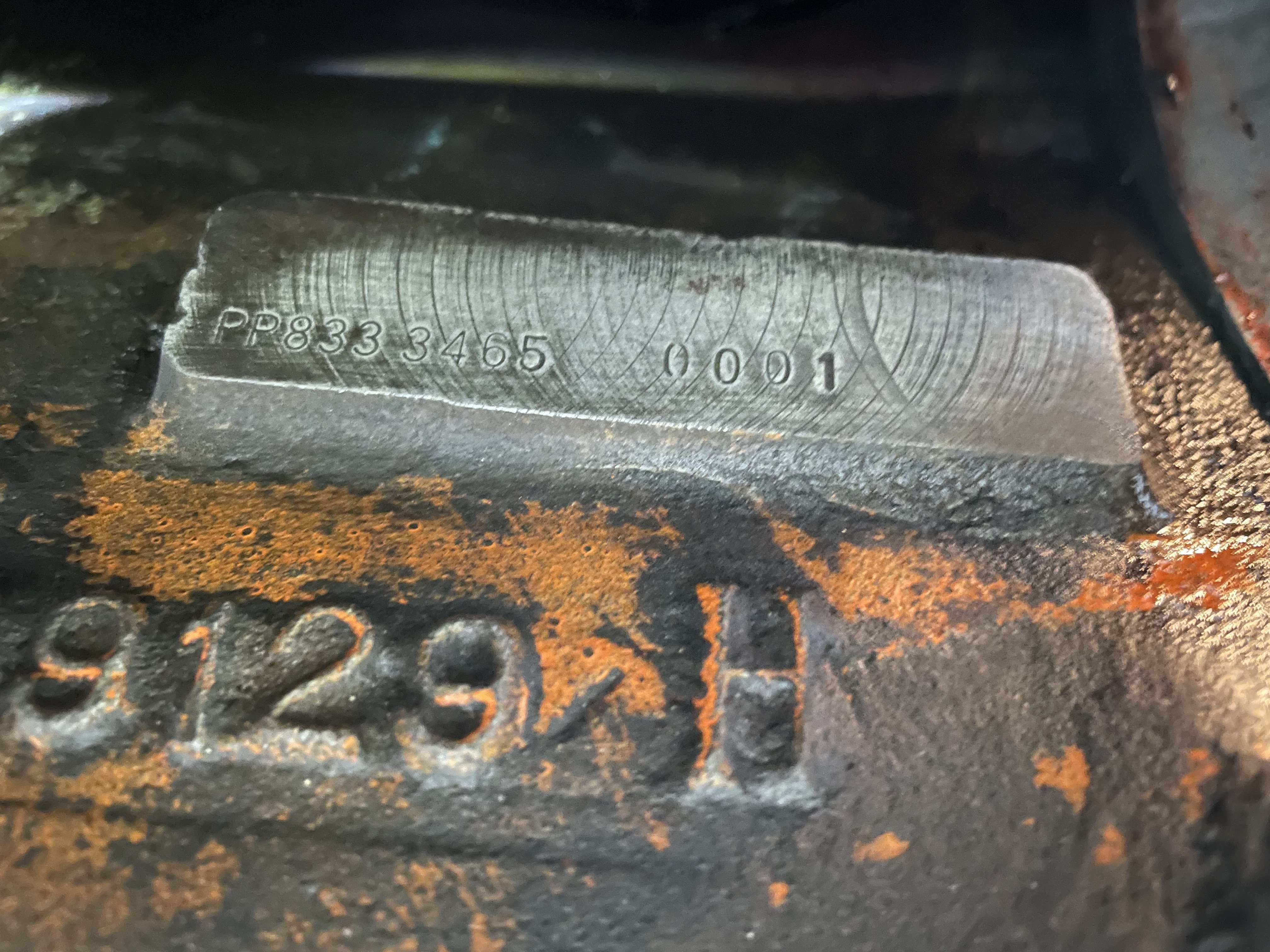

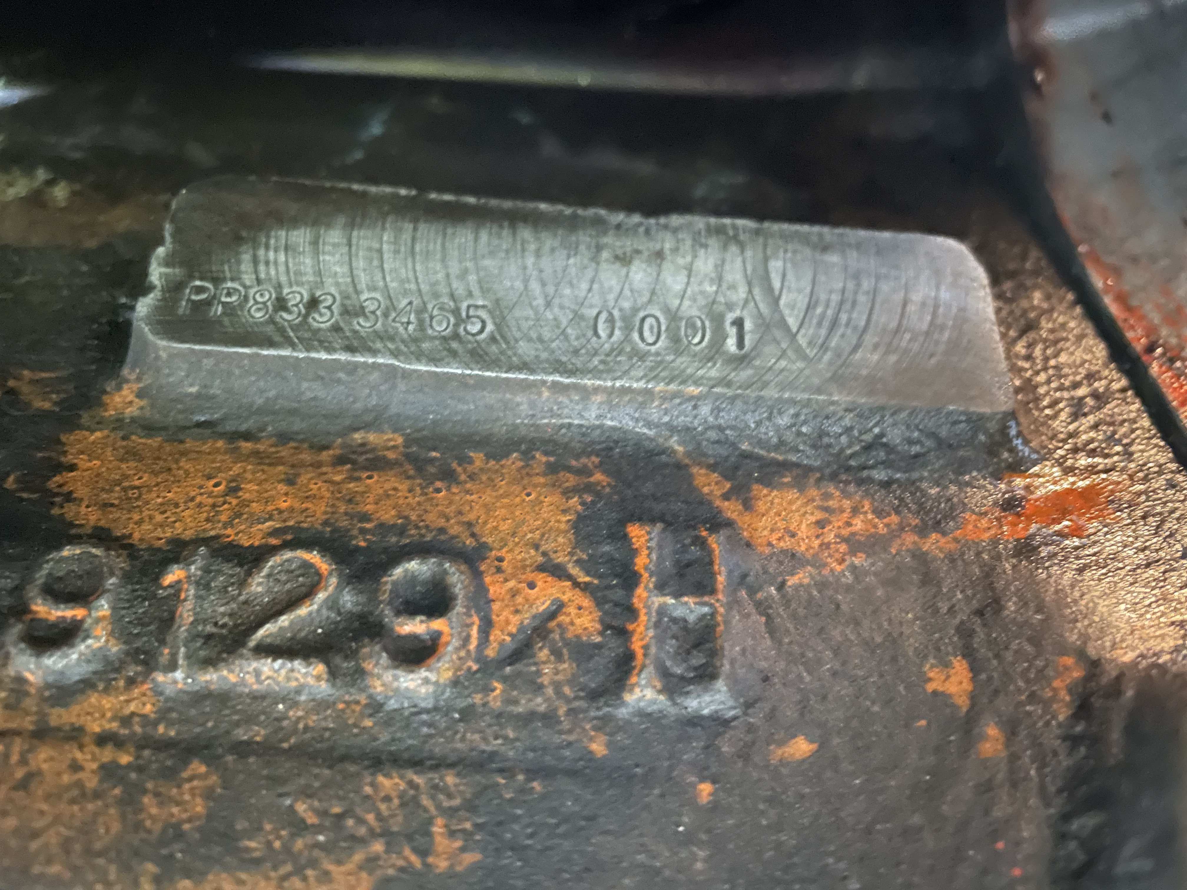

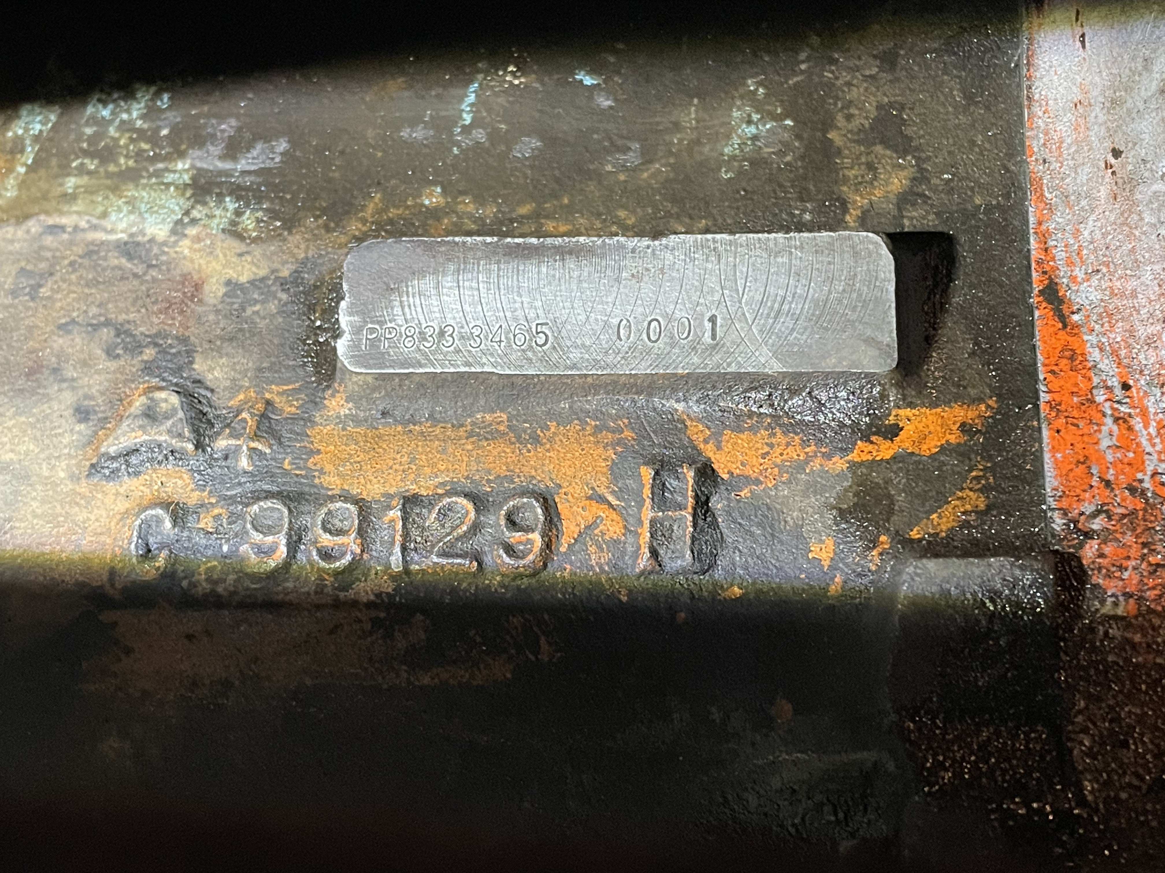

This led to another mystery as to decoding the transmission. The numbers are associated with the first transmission (0001) being built on the date 3465, or January 22, 1971 at the Syracuse, NY plant (PP). However, as you can see, there's no serial number on the transmission housing. Can anyone describe how/why this would be and if my decode is correct? Is it possible they just missed it when building this car?
Thanks for any help/advice.

Door and fender tag don't match. One is for a 1970 car, door jamb, fender tag is from a 71. 70 is 383 car and fender tag is for a 340 car.

As for the trans It could have been damaged with the floor pans & replaced from Mopar parts through a dealer thus no Vin .

BS23N0B152165 Door sticker
BS23H1B290262 Fender tag
More information is needed.
N does equal a four barrel 383.
H is a 340 four barrel.

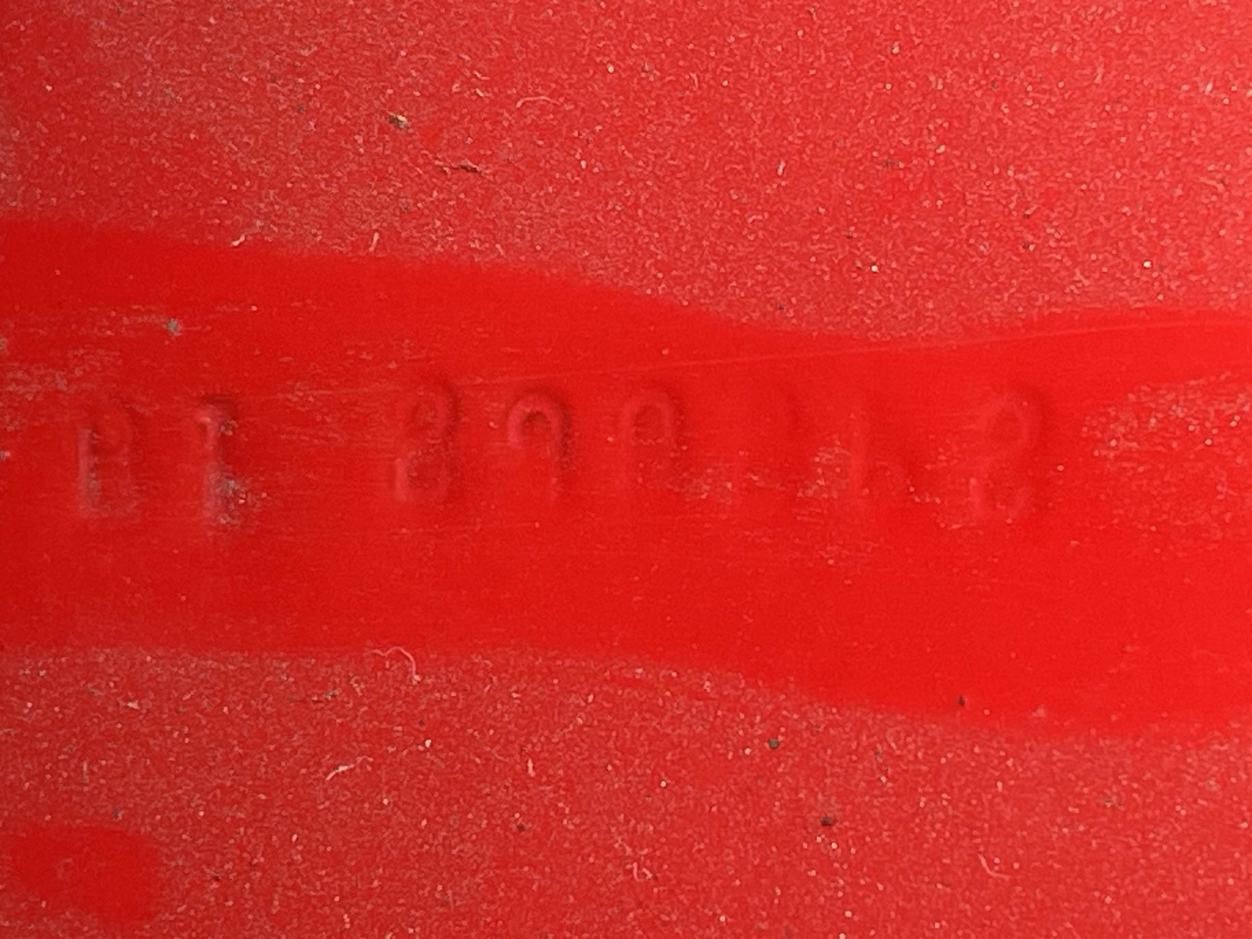

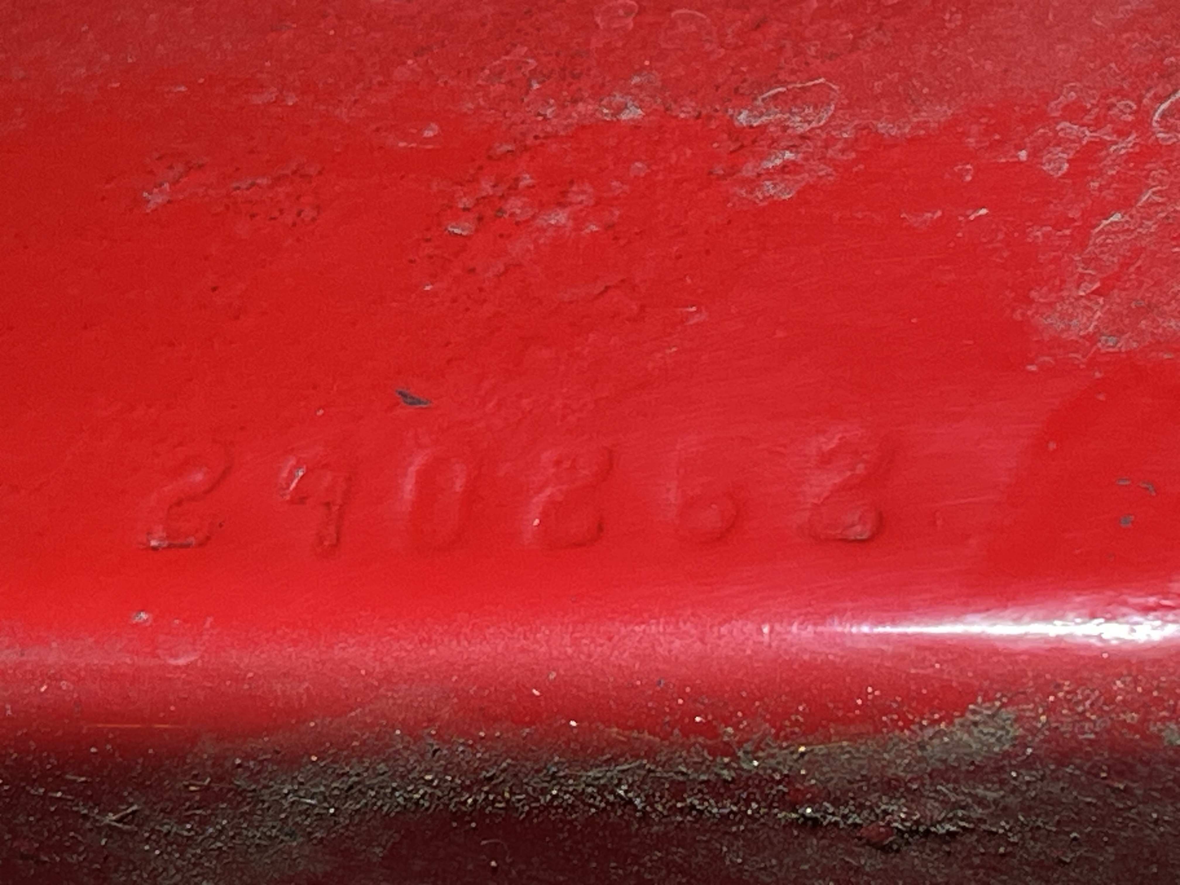

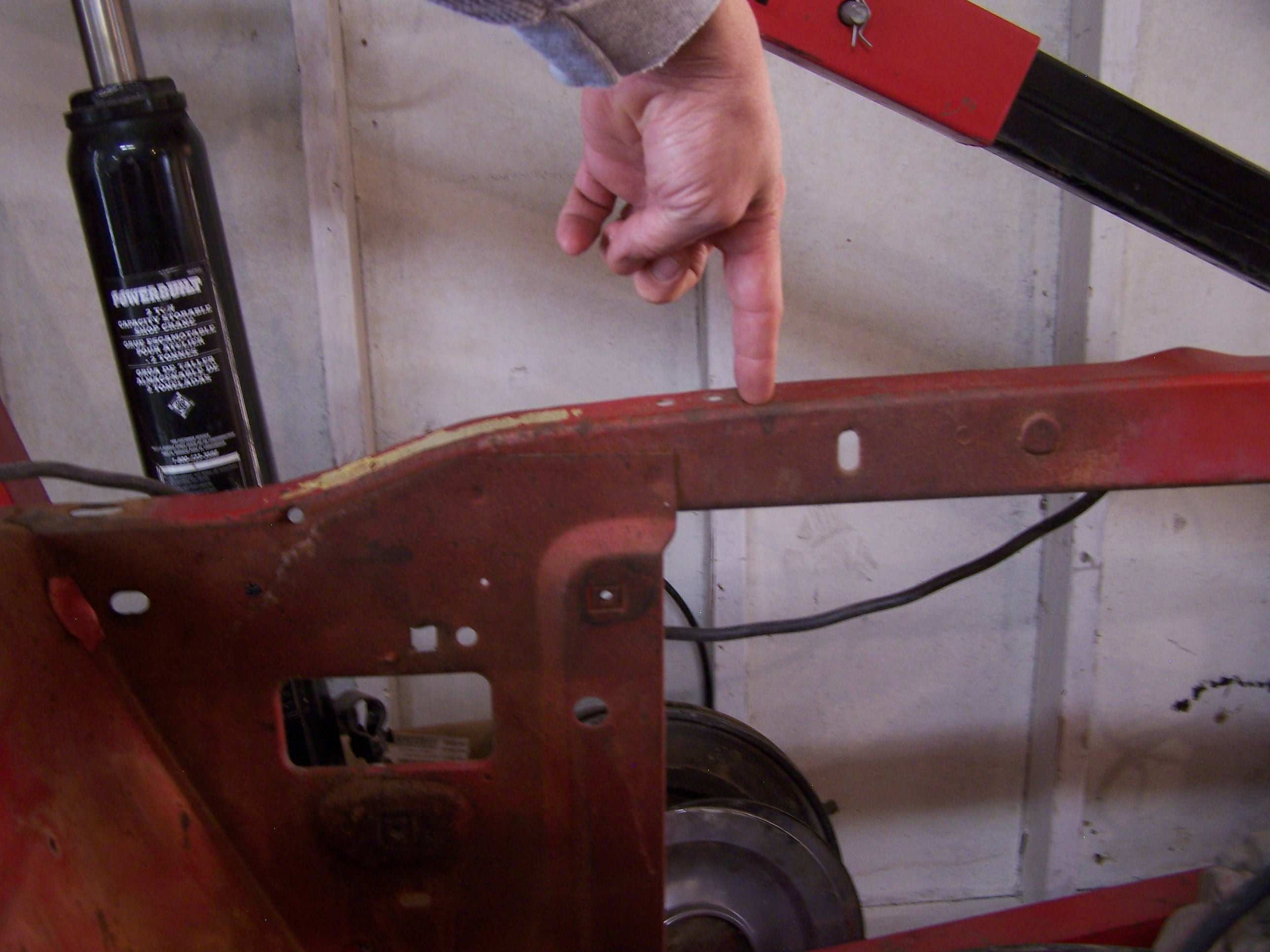

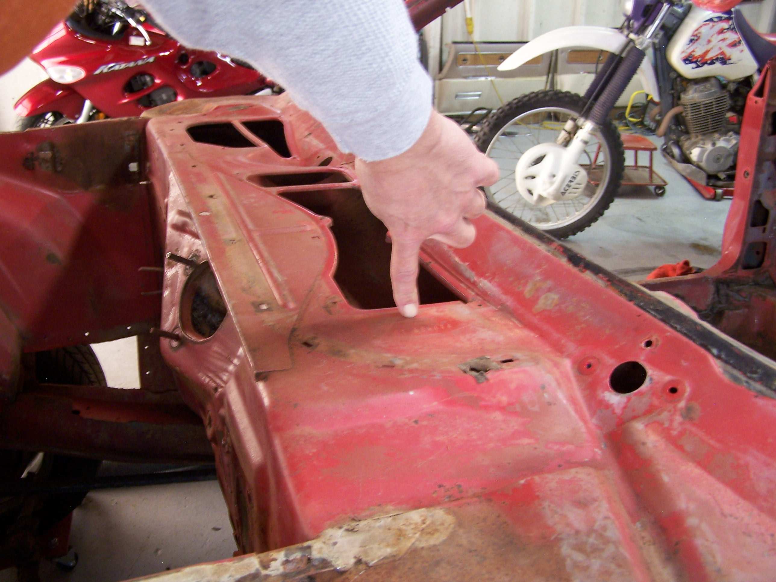

What do the two stamped areas show?
The cowl and the radiator support.

You can get a new door sticker to match the dash and title vin,if they match. ECS can make you one up.

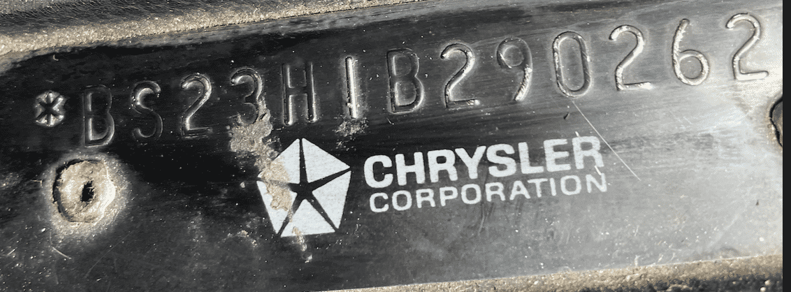

This is the proof that the body is BS23H1B290262. Post a picture of your Dash VIN (rosette-riveted to the dashpad, driver's side).
Summary:
Body is real 1971 Cuda 340 but was originally GF7 - Sherwood GREEN. Fender tag is original (plenty of details confirming that in your picture) and a 4-Speed, 3.55 Sure-Grip axle, Rallye instruments, non-console car, black buckets, tinted glass, dual-chrome mirrors, variable-speed wipers, hood pins, Calif emissions, and AM/FM thumbwheel radio. Quite a car!
Replacement title matches Dash VIN and Body VIN.
Just needs a repro Door VIN decal to round out the VINs.

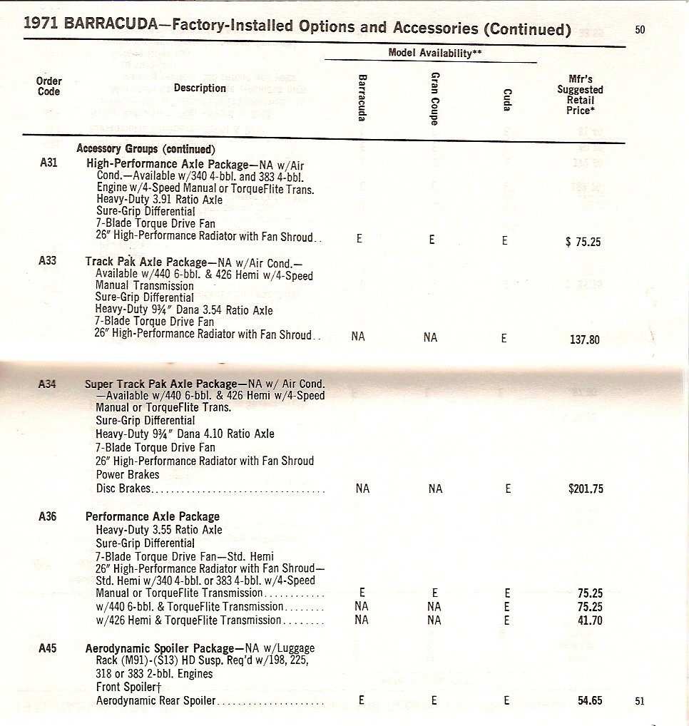

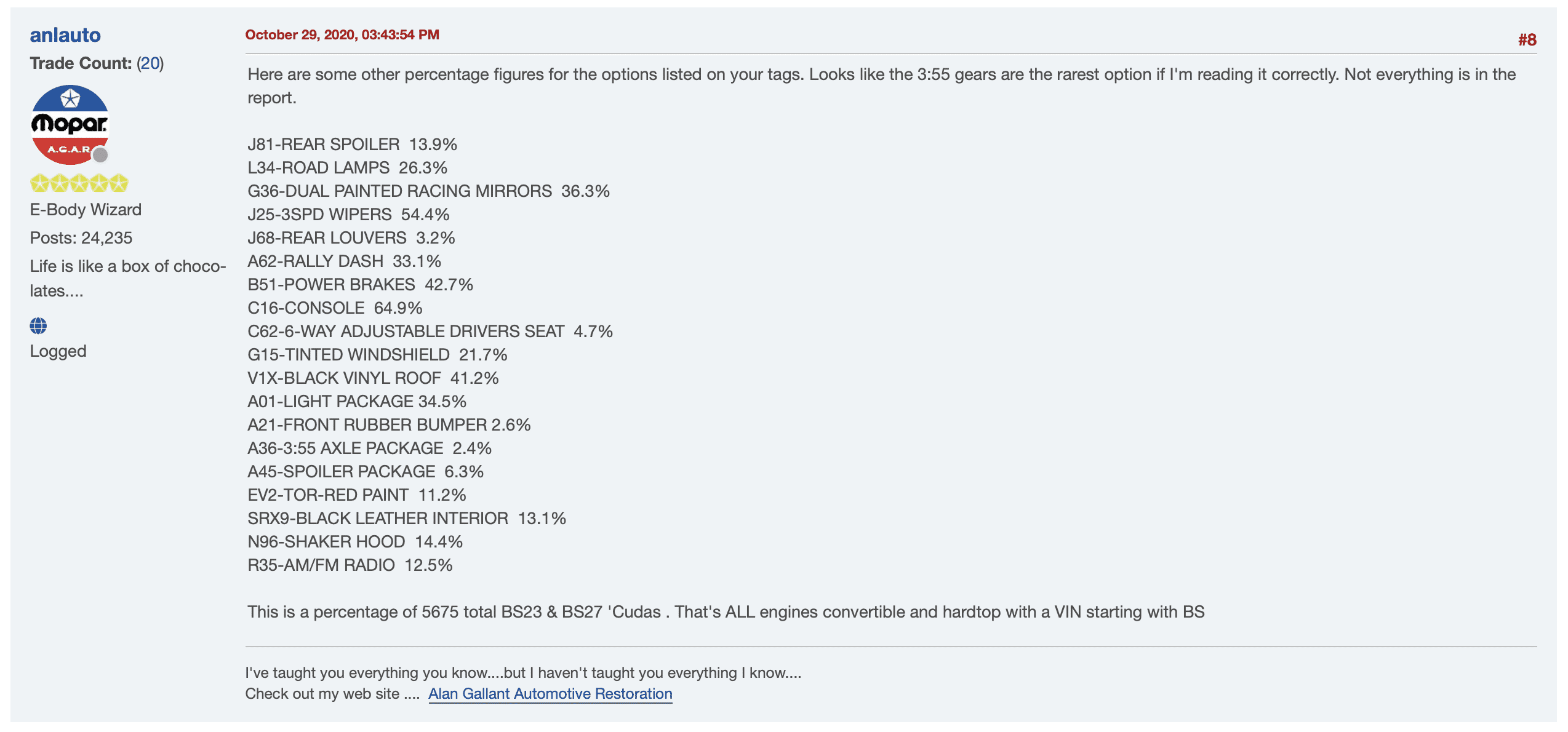

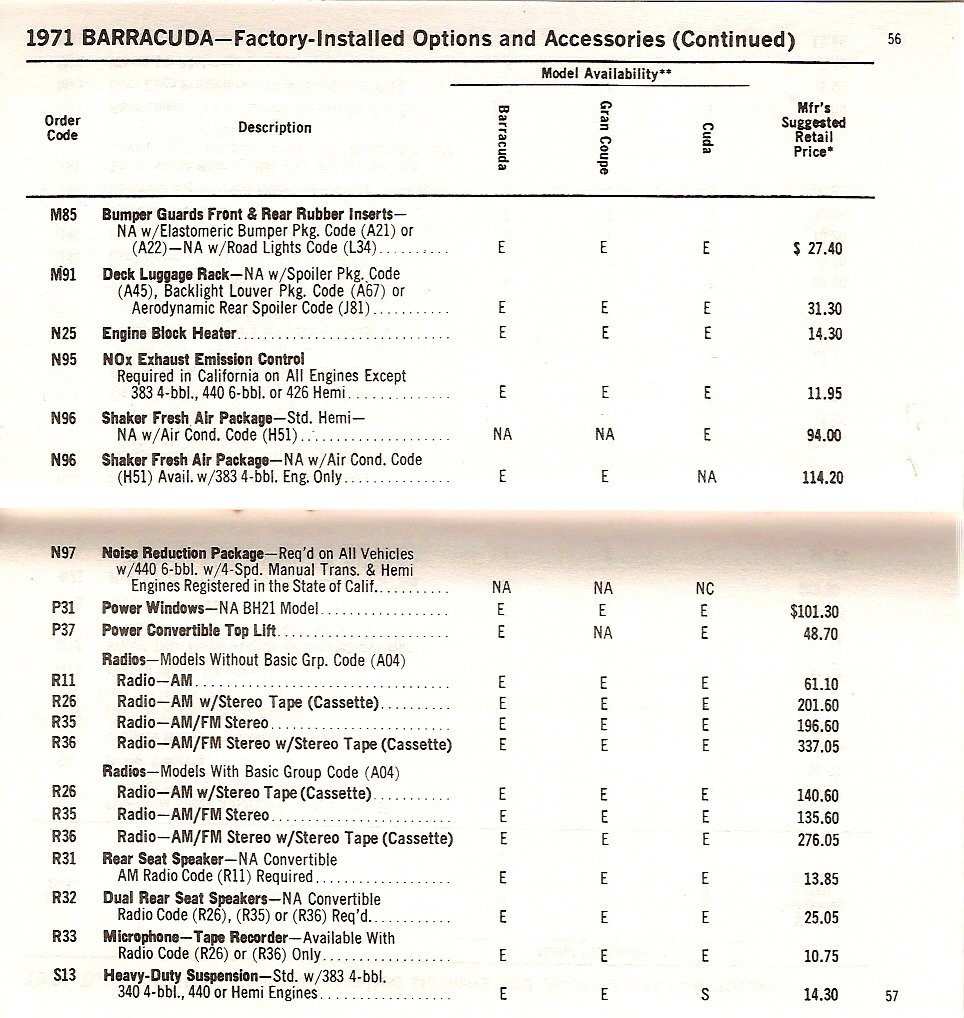

MPC, is this indicative of the true numbers of the vehicles with the AM/FM thumbwheel radio and the 3.55 Sure-grip axle?
Why was the Sure-grip so rare?
MoparCarGuy
Jun 28, 2020
829
702
Yes, R35 AM/FM and R36 AM w/tape deck radios were expensive. Sure-Grip was an expensive option as well so it many did not order it.

Additionally, the Door VIN decal cannot be confirmed for the month. Based on your Scheduled Production Date (SPD) of 209 (February 9, 1971), the actual build date could either be January or February 1971. Many cars are built earlier than SPD or later than SPD. This is the dilemma when the original Door VIN decal is missing.
Your car's Door VIN decal was could have been either 1 - 71 or 2 - 71. Without more information, most will purchased a repro Door VIN decal with the actual SPD month, in this case 2 - 71.
More info might be out there on your car's assembly line timeline. 6bblgt on the E-Bodies.org forum may be able to assist with info.
