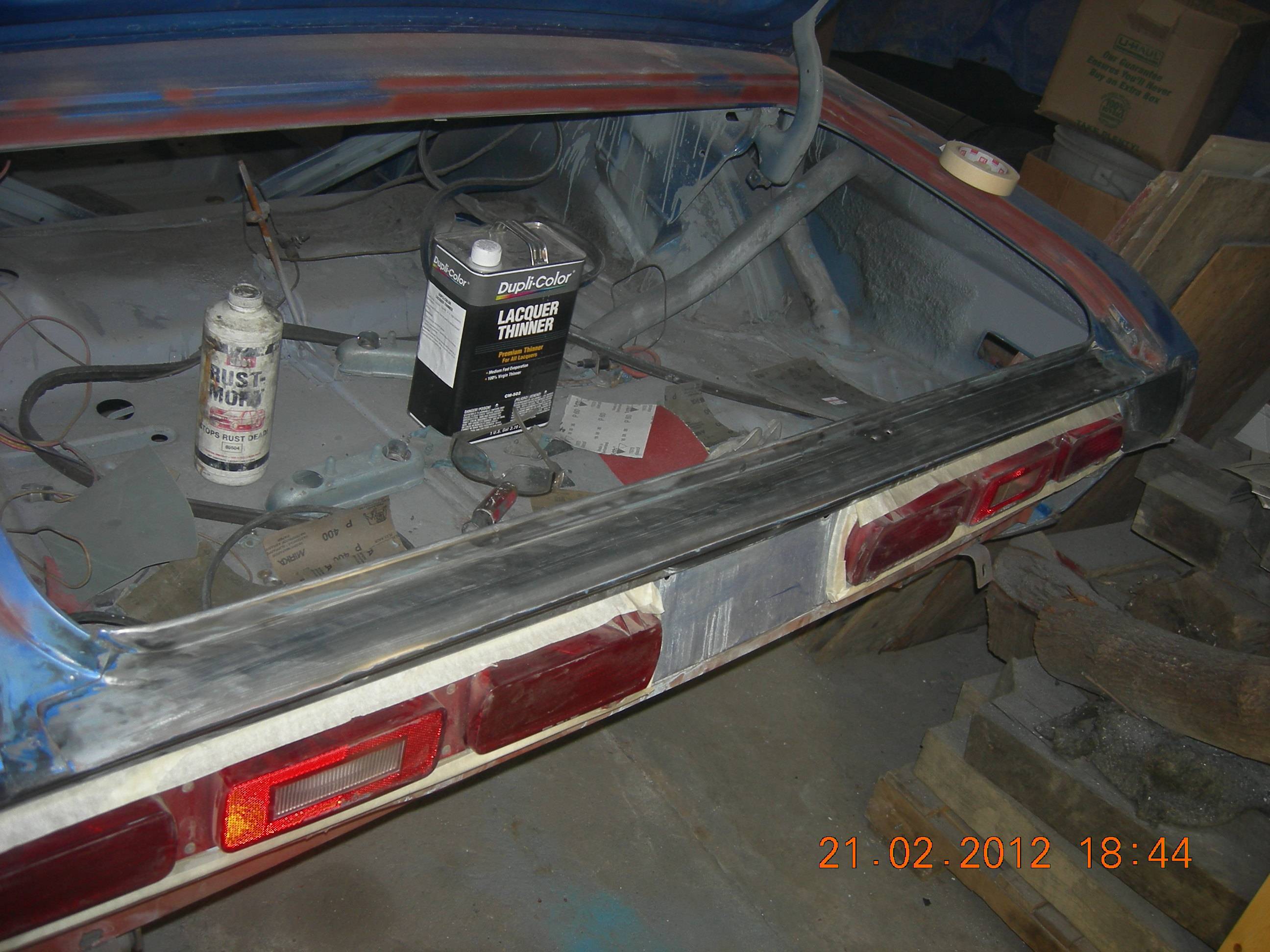

On my own 71 RT challenger. being 2nd owner since mid 70s. When prepping black portion of tail panel, there was no body color under blackout. But under the vinyl the roof was painted body color. As far as what was first I don't know. Also come to think of it there was no evidence of prime. I used lacquer thinner to clean things up and just wiped it off. can see blue on the edges.

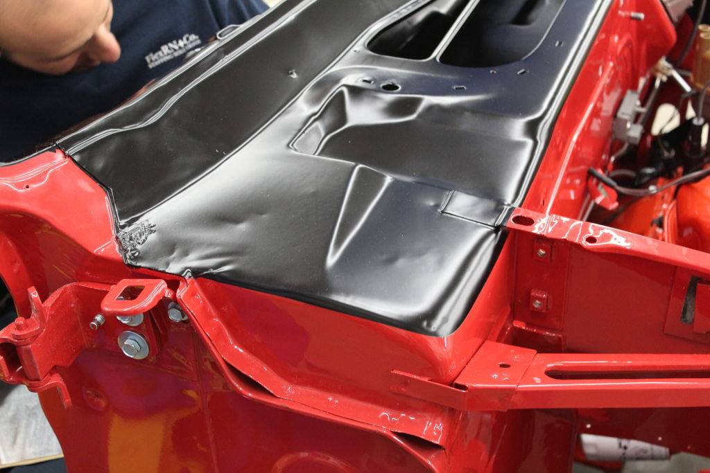

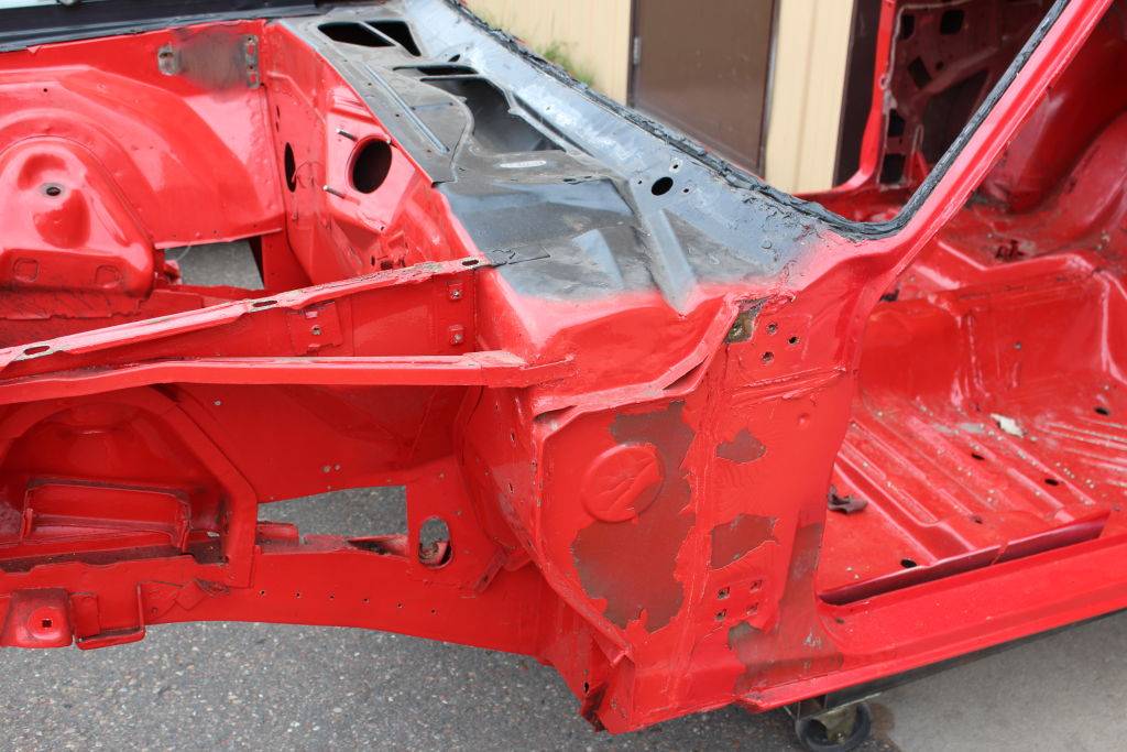

What paint on that upper cowl area is that organasol also the tail lamp panel
ctaarman
Nov 8, 2016
104
24
AARs had multiple coats of organosol on top of the body paint. crudely edged with a masking tape. Also sprayed on top of the hood pin backets inside the engine compartment along the fenders. ( Most painters screw that up).There is no flat black I know of that can duplicate the slight crinkle of organosol. I've heard zome folks trying some sand in flat paint but have no experience with that as I was able to find some NOS organosol a few years back.
