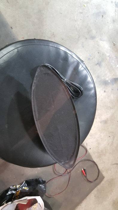

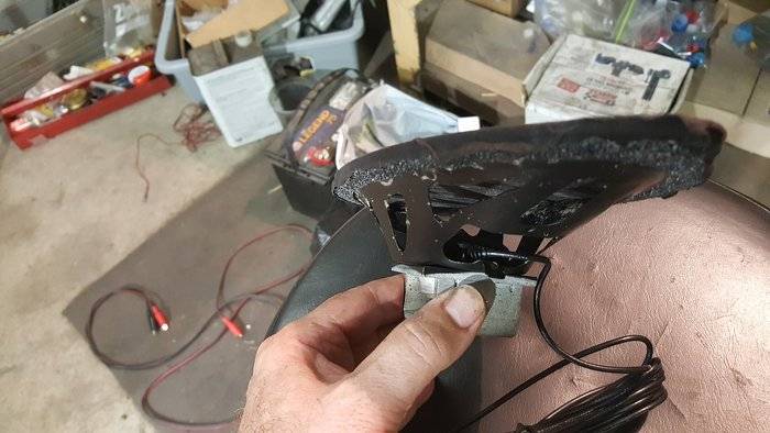

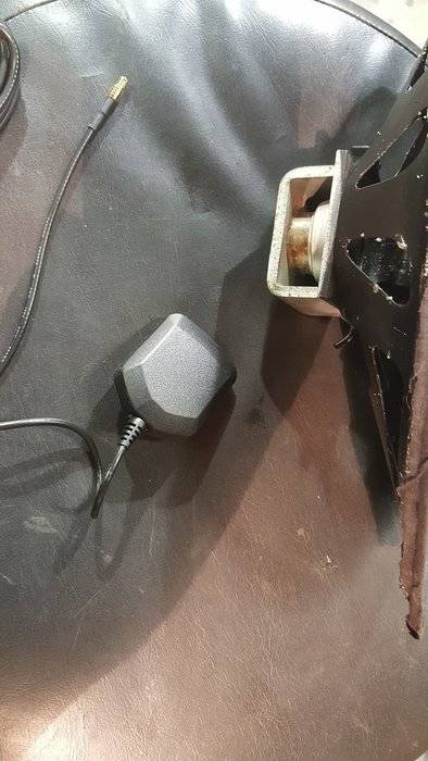

Here's some pics of how i hid the gps antenna.

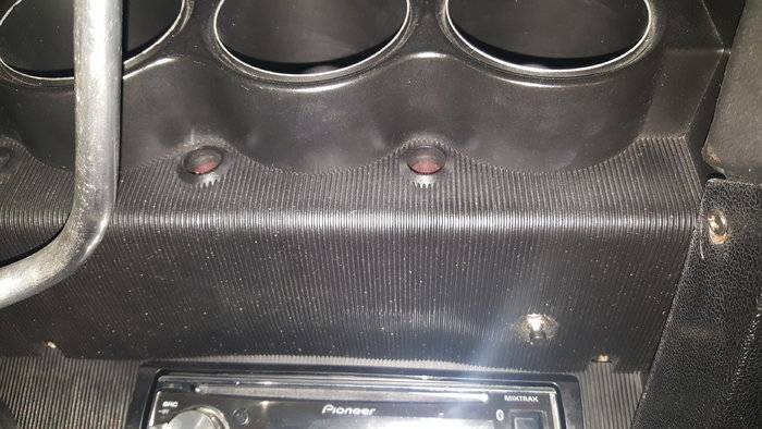

No I packaged it myself off their website. When you go to their site select individual guages from there it will take you to another page to select the guages you want then navigate from there. The website is great you can see virtually any combination of what your guage would looklike on their site. Now for my speedo I wanted the gps type which would have had the trip/calibration button poking through the lens which I didn't want because I was using my stock lense cover over all my guages so I called and asked to have a remote button for the speedo so it would fit behind my lense without cutting a hole to access it. Cost 10 bucks extra. Like I said these guages are custom you tell em what you want and they make it. I used a 4 1/2 " speedo and 2 1/16" for the volt,fuel,oil,andwater temp.here's a pic where I installed my speedo remote trip/calibration button thtrough the hole where my factory clock knob was. Hopes this helps.
