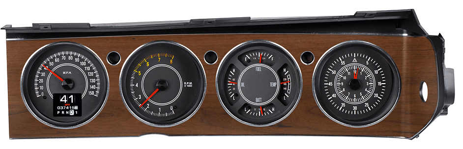

Dakota Instrument rally gauges have an amp gauge or volt gauge?

Dakota Digital's E-Body Rallye Instrument Cluster (pricey at $1,855.00) uses a voltmeter with a range of 9-17VDC. Gauge is labeled BATT for the voltmeter unlike the original Rallye Instrument Cluster which was labeled ALT for the ammeter.
Source: Dakota Digital RTX for 1970- 74 Dodge Challenger and 1970- 74 Cuda with Rallye dash
