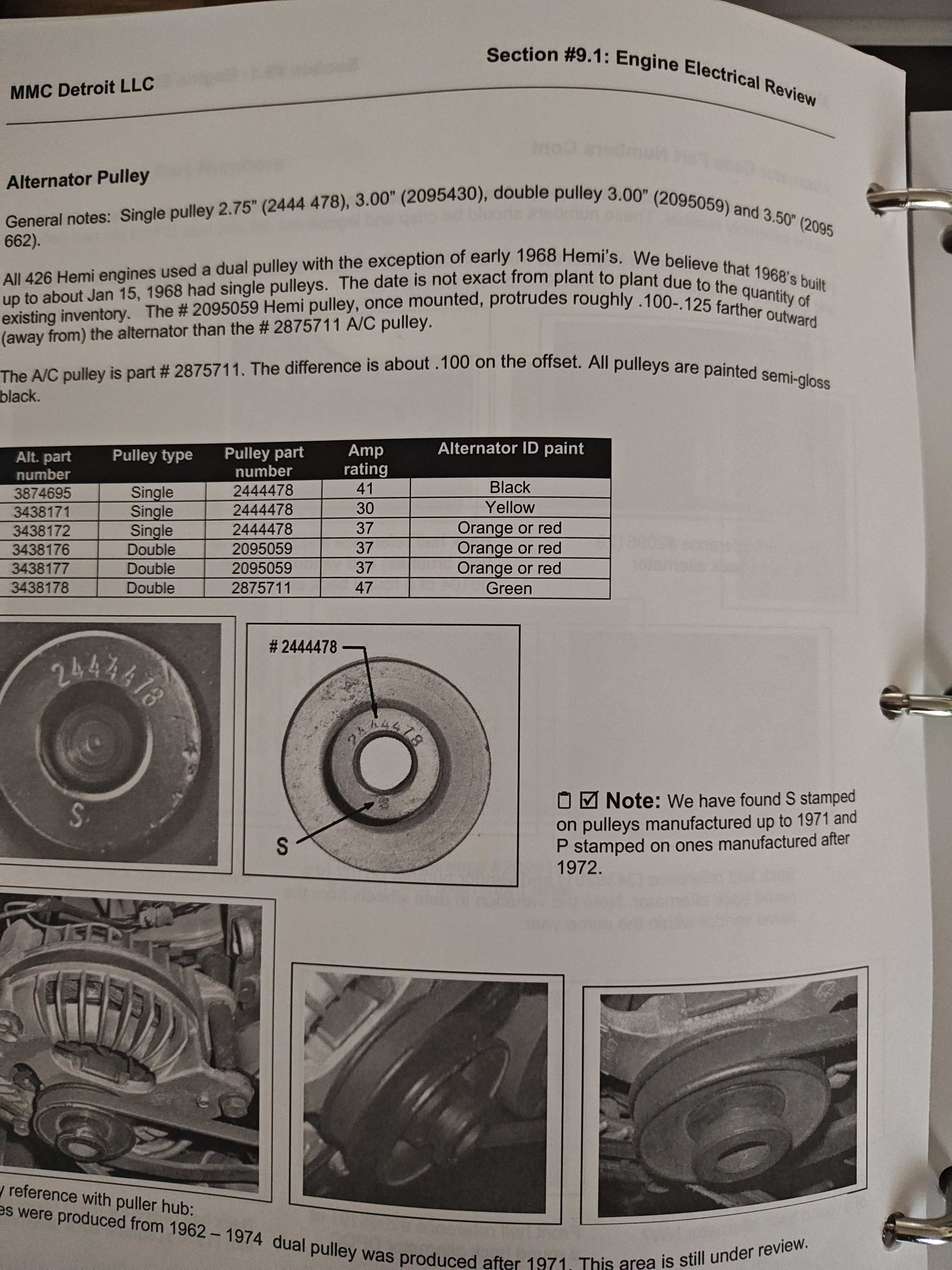

All alternator pulleys were painted semi-gloss black according to the MCC E-Body Guide. I've seen rebuilt alternators where the pulley appears to be cadmium(?) plated.
