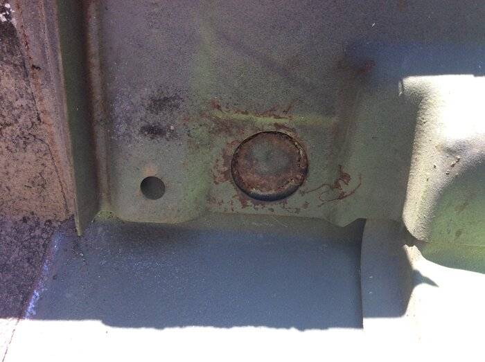

I got the fender off today. It looks like someone put a circular piece of metal in the hole. This is a picture of the underside of the fender. I also did an internet search and I found templates for the AAR and T/A cars but not for a regular Barracuda.

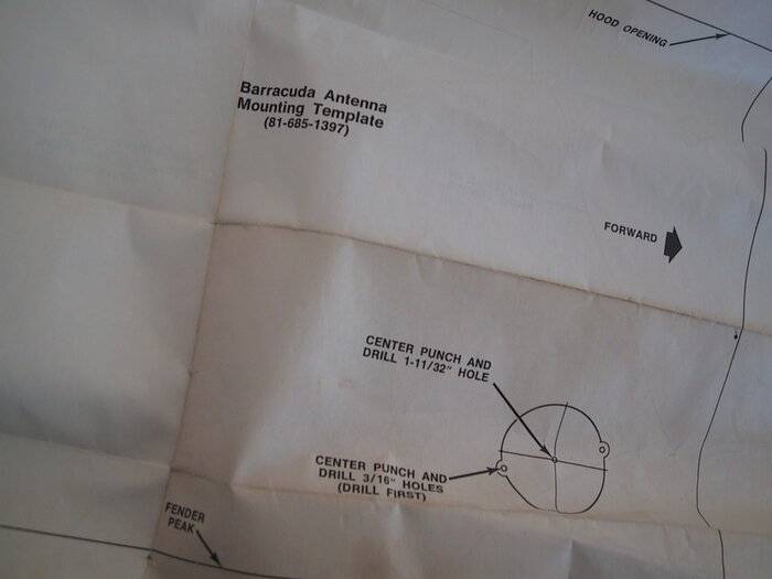

But there are two smaller holes that go along the circumference of the larger circle that have to be drilled first. Once I get that information and drill the two smaller holes I can drill the larger hole. I just want to be sure I am putting it in the right place.

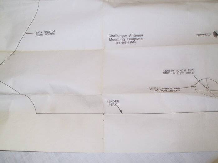

2 smaller holes? The hole does have a notch but I don't know about any other holes. I might still have an old Cuda fender with the hole I could measure or I could get an approximation off my 70 Challenger as to the center of the hole.
Thank you very much. That is very helpful. I would love to get a hold of that template! But if not I can just go off the measurements.
