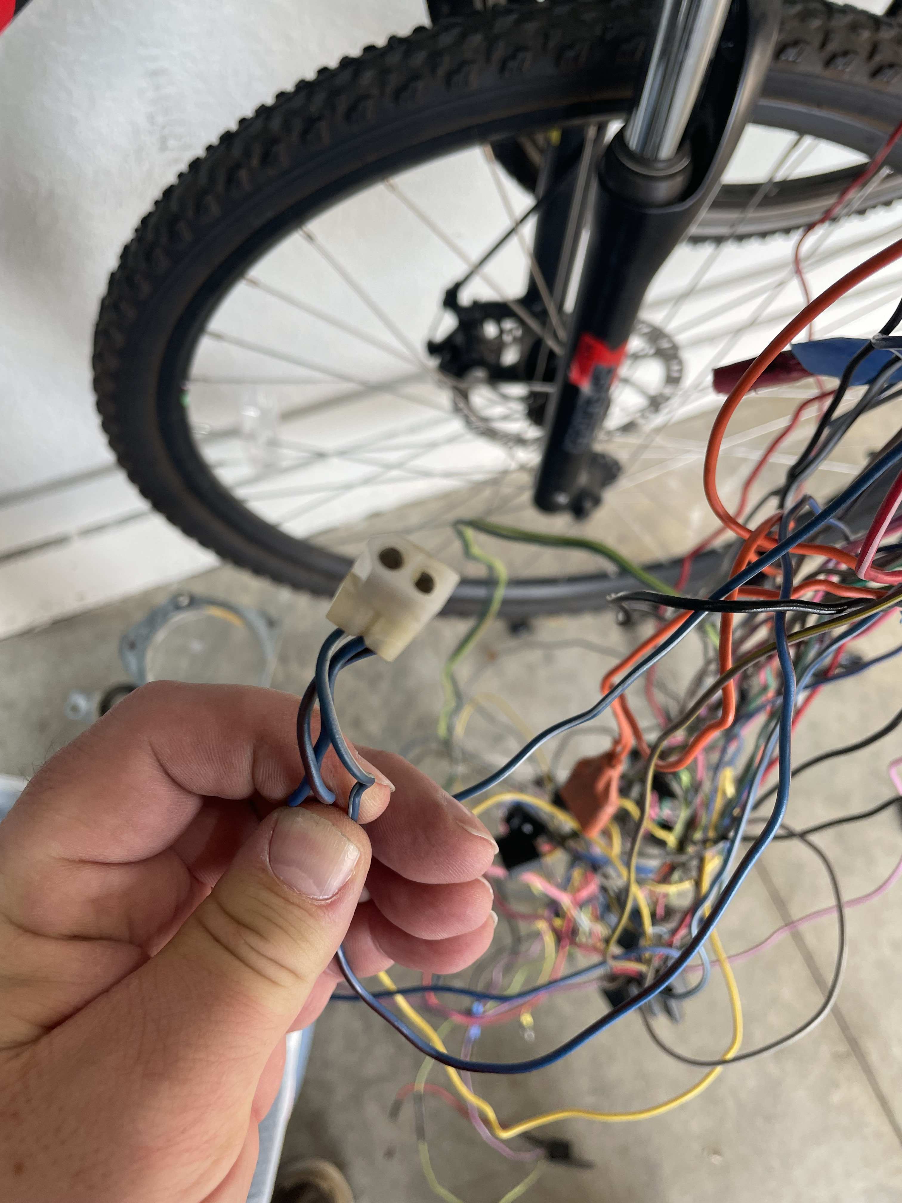

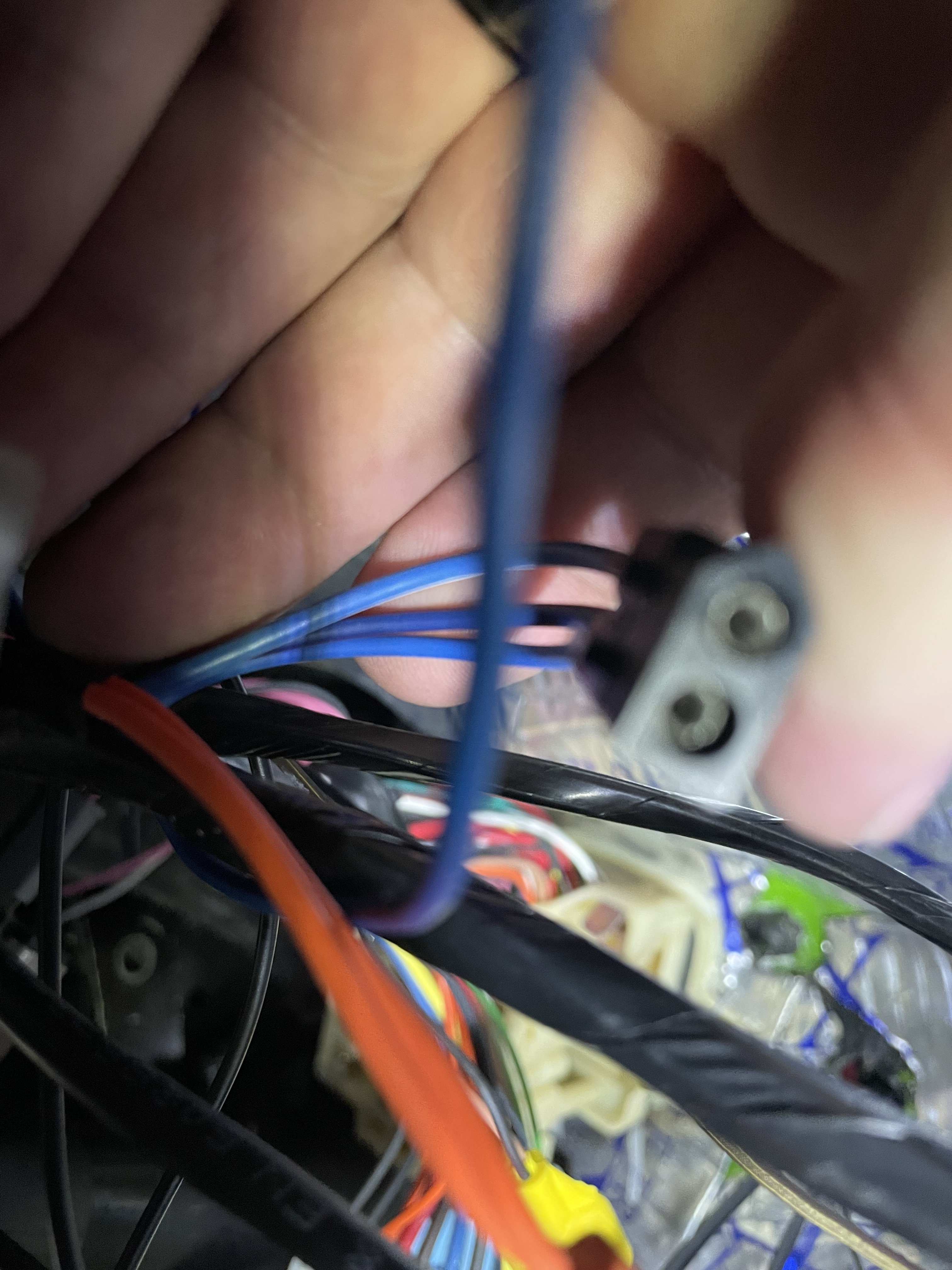

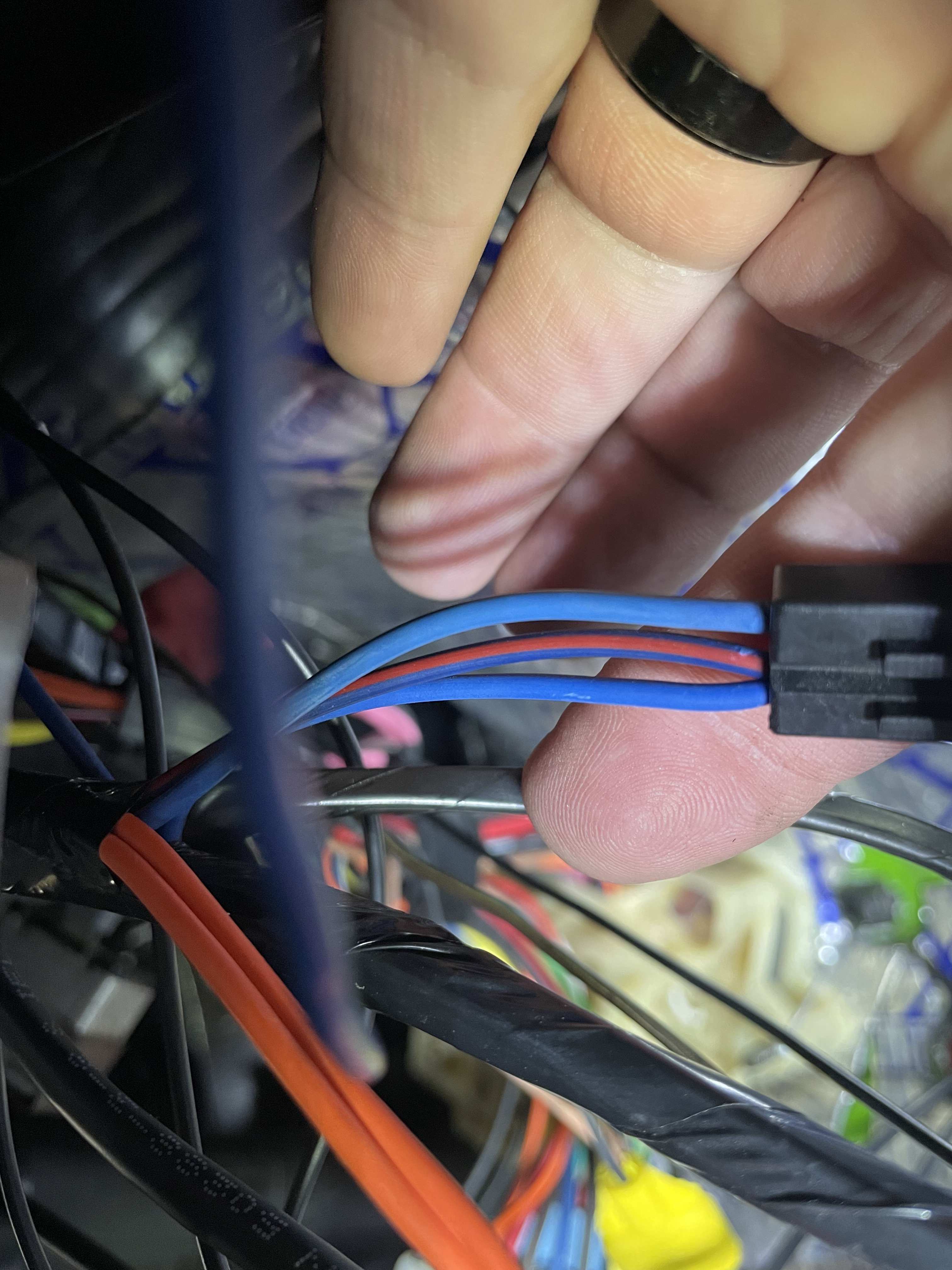

On my old harness the connector is white and the wires are blue, blue/white, and blue/red. On the new harness the connector is black, and I cannot find anything under the dash that it may plug into. On the old wiring the blue/white connect up with several other similar wires and trace back to the #1 fuse location. Could this be the radio power connection? I have an aftermarket radio and no longer have the old radio connectors.

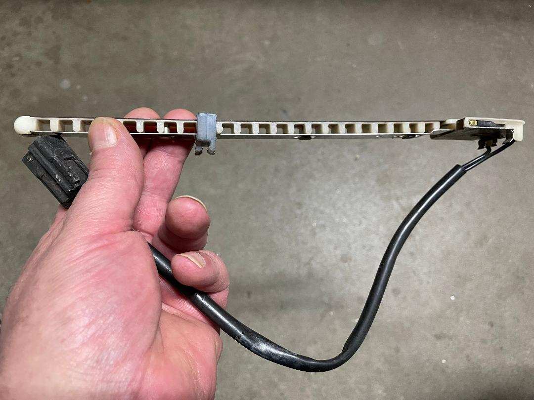

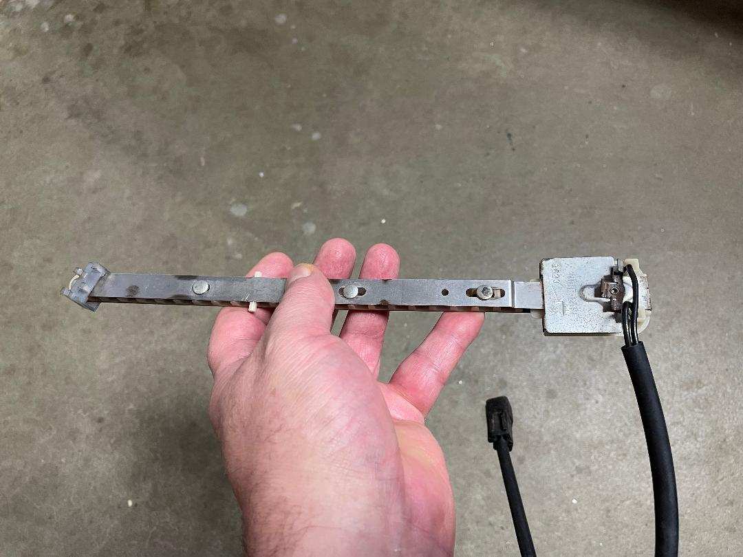

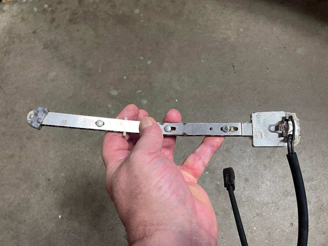

That is part of the 72+ Fasten Seat Belt light wiring. Picture of the flexible ass detector switch for this setup.
