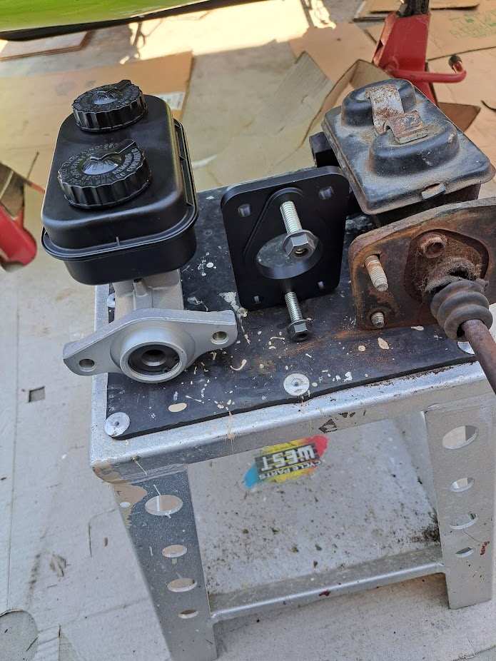

I just bought one of these with the adapter. I am going from drum to front disc. My old MC has a collar that holds a rubber boot on the rear where the piston goes in. There is no provision for this on the modern MC. Also, how do I know how long the piston should be?
Thank You.

I use one. My came with an adapter from 4 bolts to 2. I got mine from Dr Diff and it has a recessed grove to accept the rubber retainer on the brake pushrod. I used my factory drum brake pushrod with a new rubber retainer. There is a recessed area on the brake pushrod that accepts the rubber retainer. Just removed the two bolts on the drum MC and reuse with a new rubber retainer. Just need to make sure the aluminum MC is machined with a recessed area.

Bc3j I was not talking about the retainer on the pushrod. I was talking about the rubber boot that covers where the pushrod goes in the MC in the back at the firewall. Bill.
