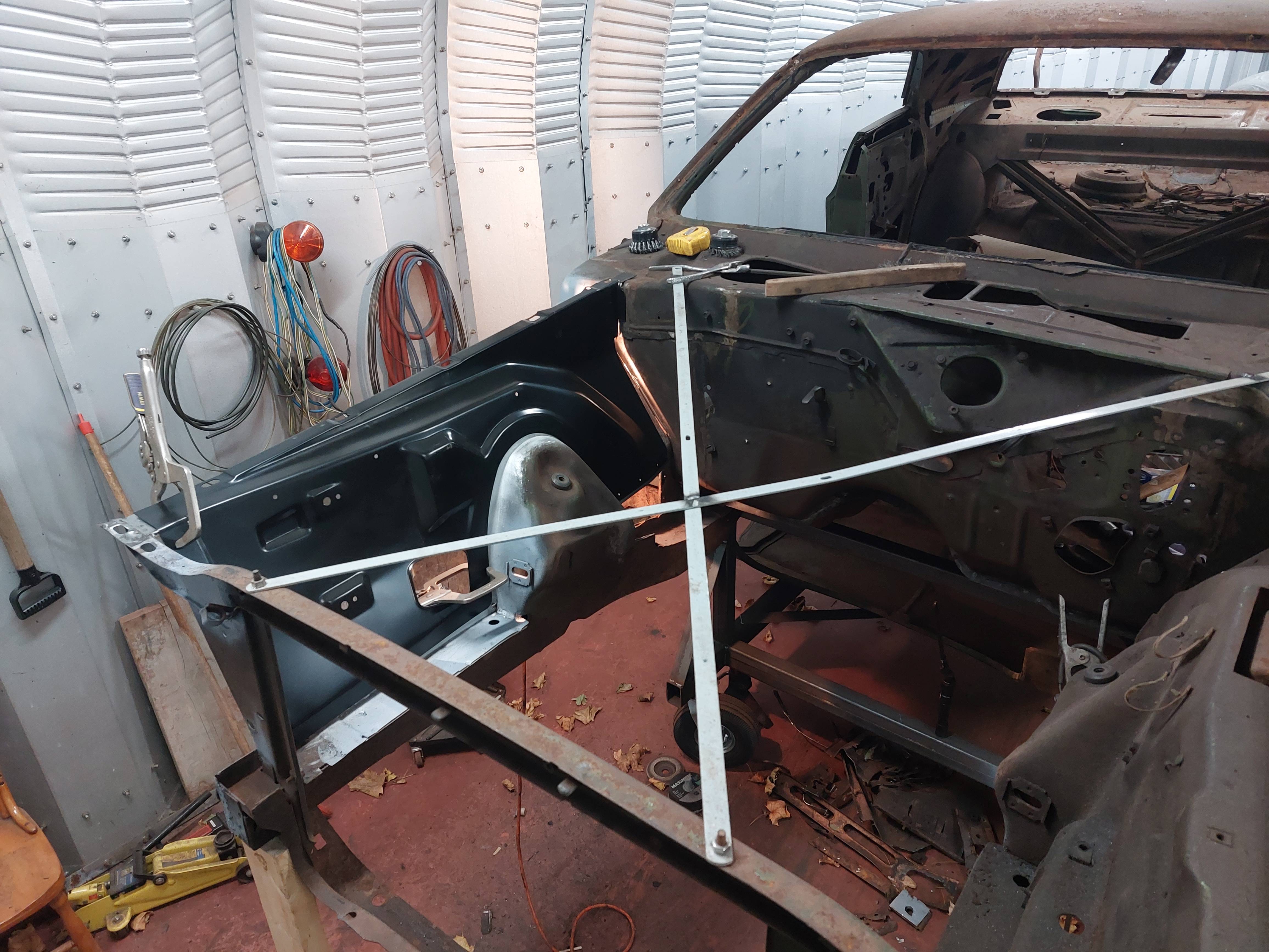

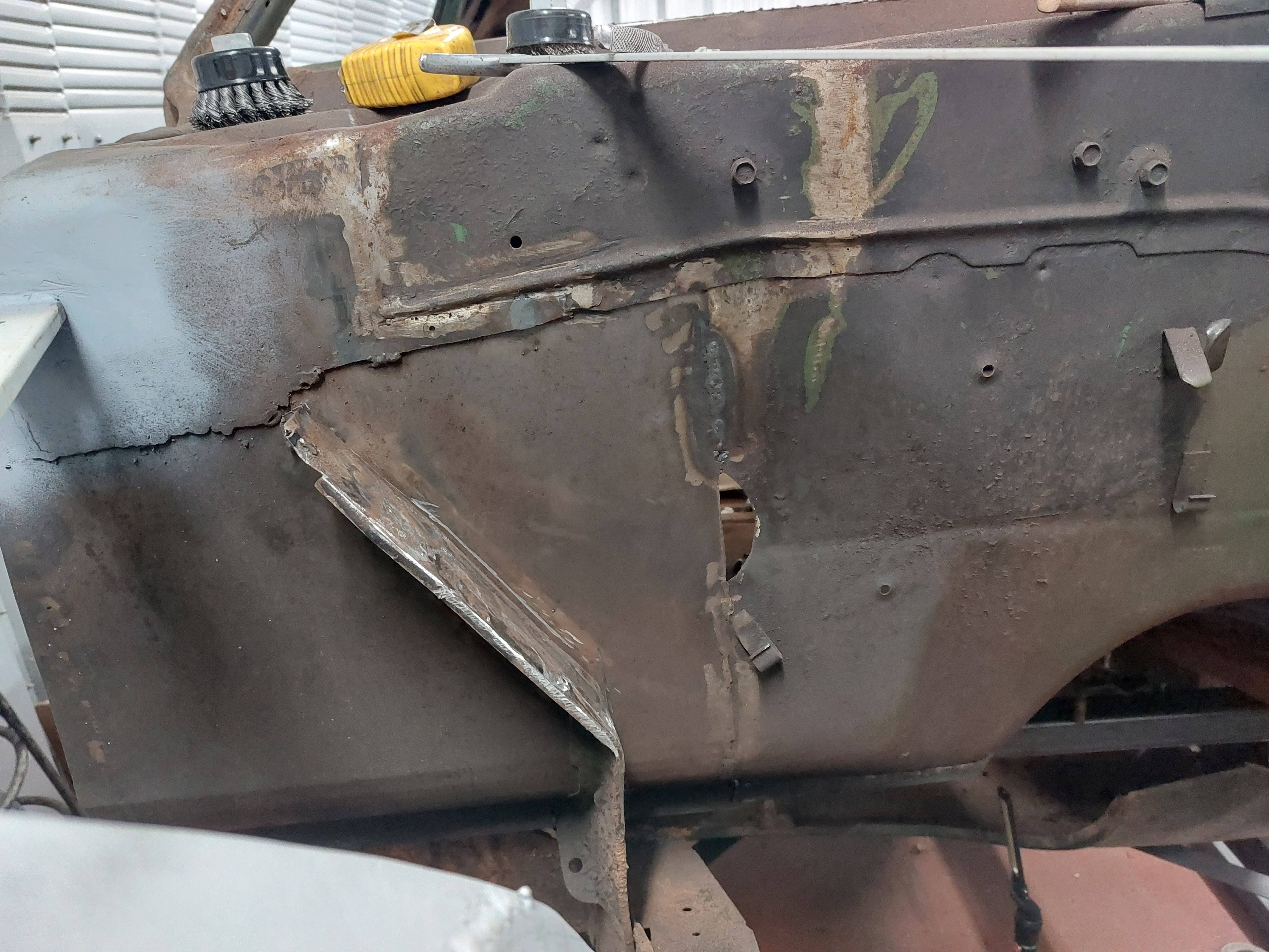

Hi all, in the process of replacing the aprons/inner fenders on my 72 Challenger. Looking for any help as to measurement specs for welding aprons onto firewall. Previous owner had redid parts of firewall and old aprons were left floating. I believe this to be critical for engine bonnet fit. Any help appreciated, thanks.

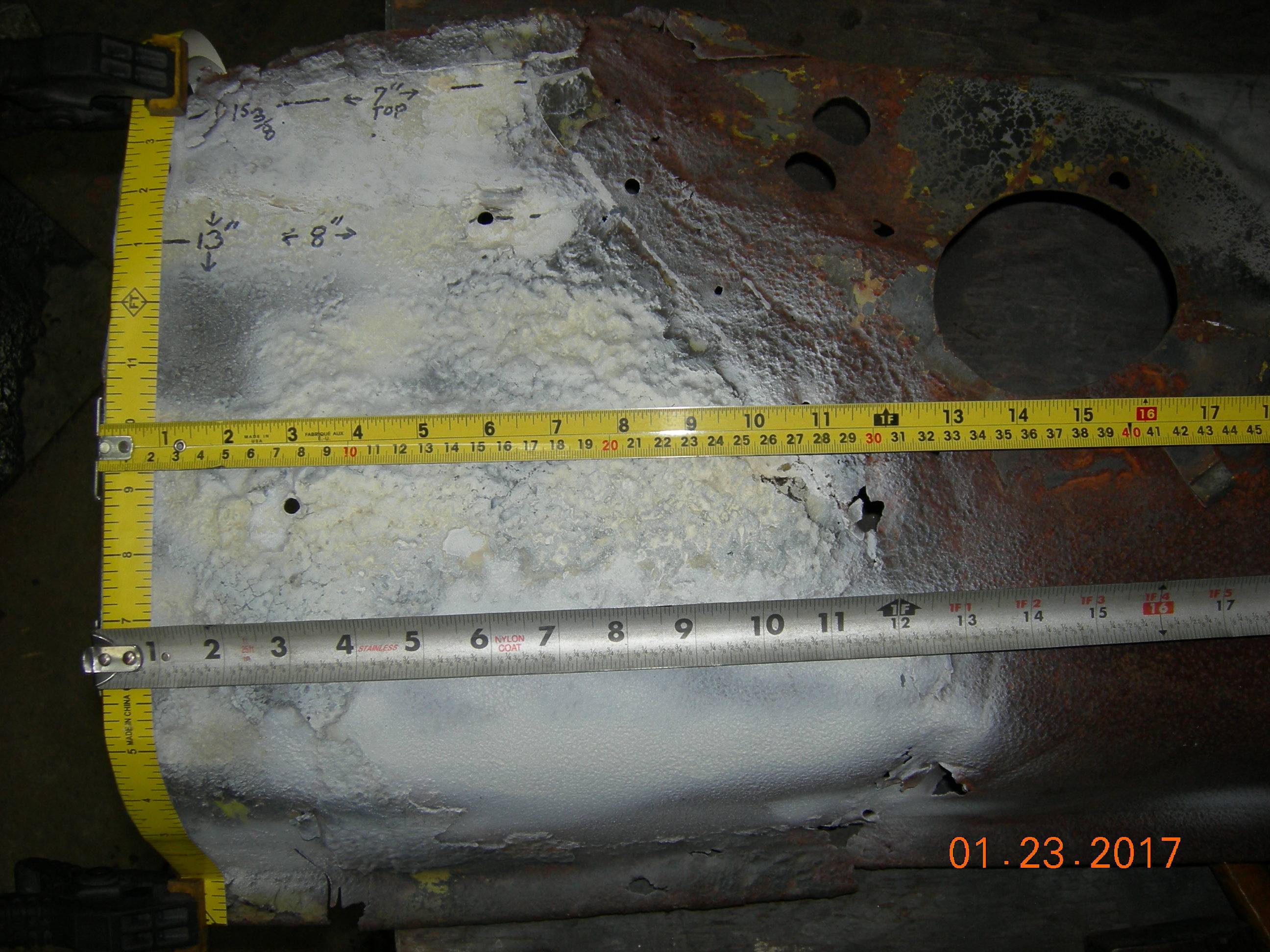

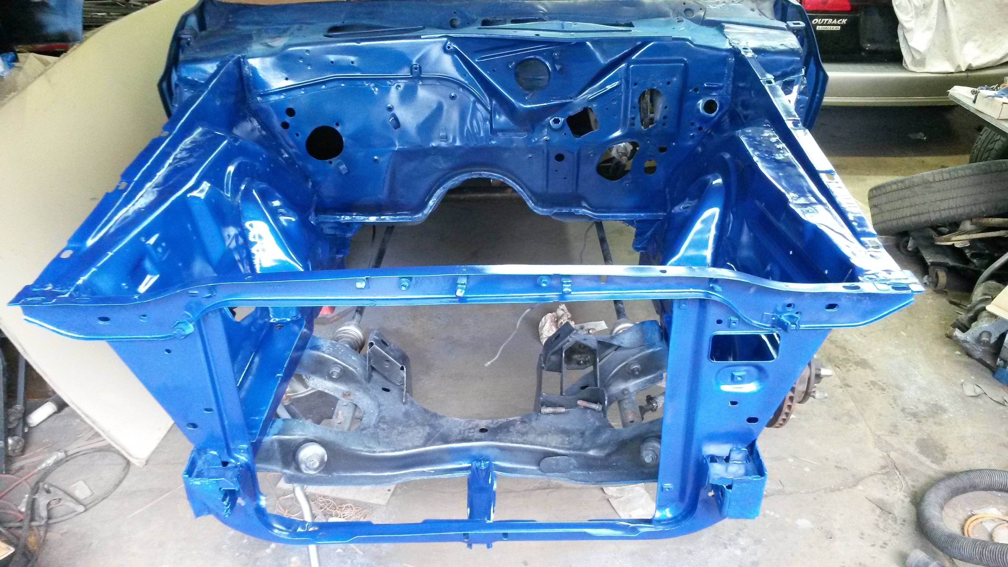

You core support, inner fender cowl top brace and apron bracket are the ones that have to be close.Give or take an 1/8 apron bracket clamp to frame rail. Here's a start
Challenger RTA
Oct 28, 2018
3,354
1,777
PA Flood city
Core support never altered? 48 1/8" pass side Front of core support along top the inner fenders above shock mount to fire wall. same for driver side. When core support and fire wall bracing in place. TAKE note of location of brace on top of fire wall. Then center apron on shock tower.
