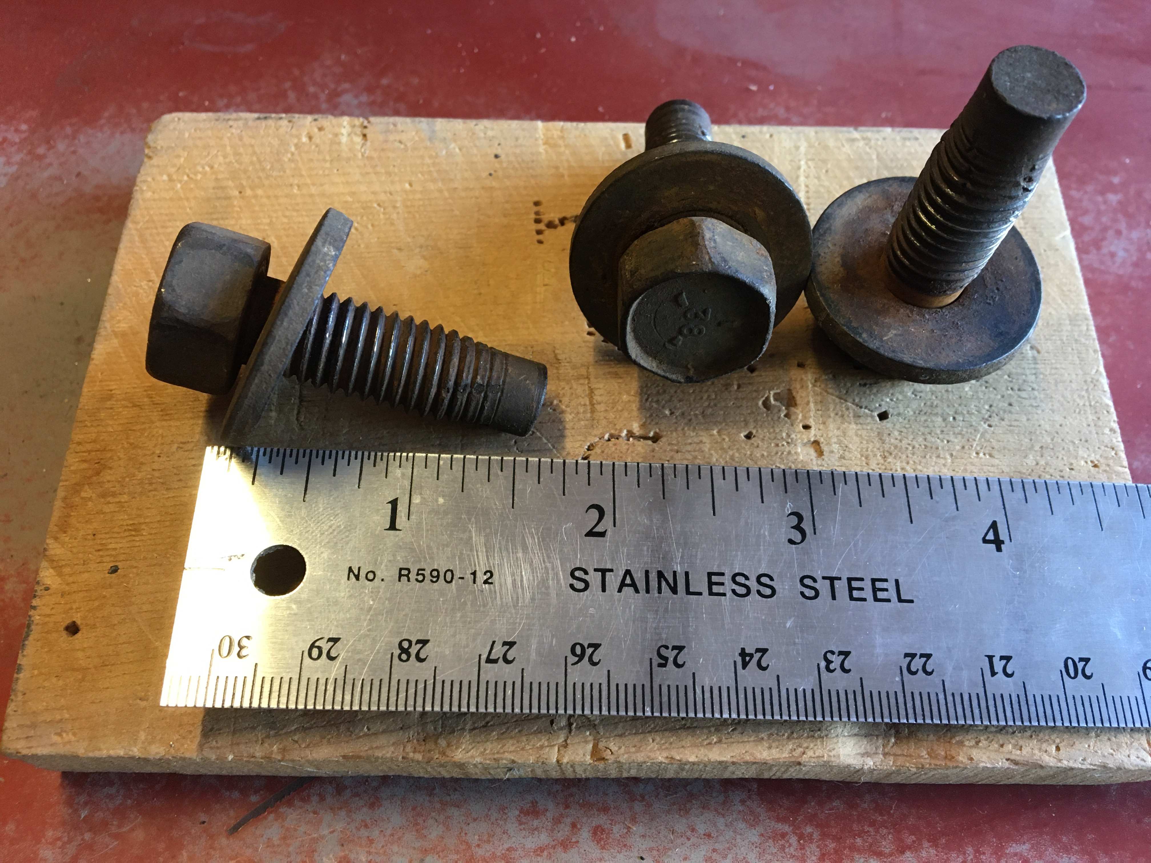

Can anyone confirm? I don't have the access I need to confirm if these bolts are the ones used to bolt the front bumper support to the frame. The (1970-71) parts book does not appear to list part numbers for these bolts in the bumper section.

The bumper support to frame bolts come either with "teeth" or not. According to Guide to E Body Fasteners, bolts with "teeth" are usually found on Challengers and bolts without "teeth" are usually found on Barracudas. Pschlosser's bolts with the "38" match the Guide.
