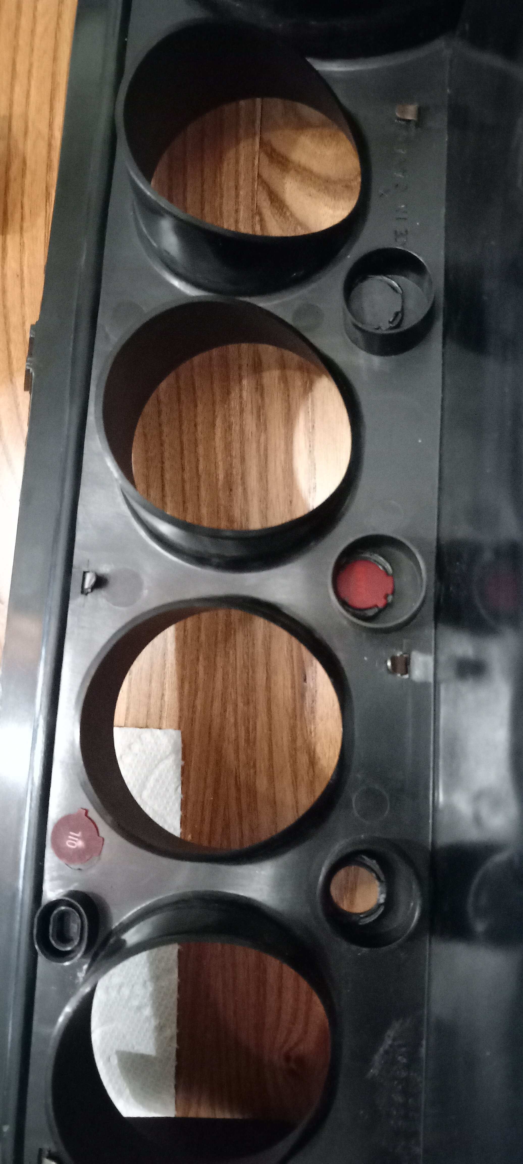

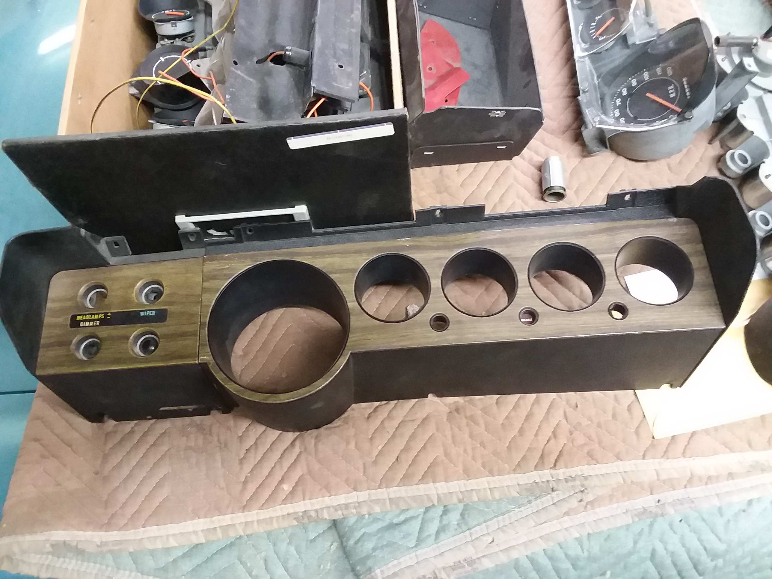

Looking for the correct way to attach the 3 lenses to the bezel.

The correct way would be to make a tool and melt the plastic after you install the lens but I am not sure if this is an option for you,
There may not be enough original material to do it a second time.
If you have an old cracked up dash bezel cut a little piece out of it to secure the lens.
