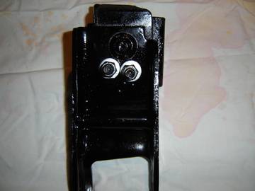

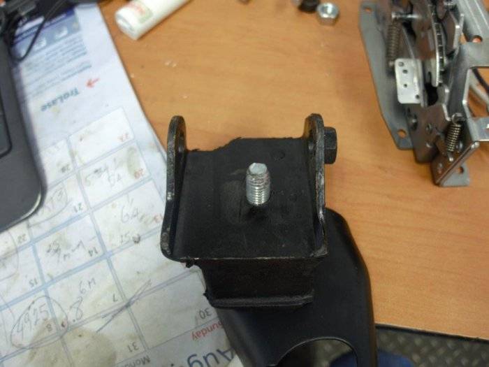

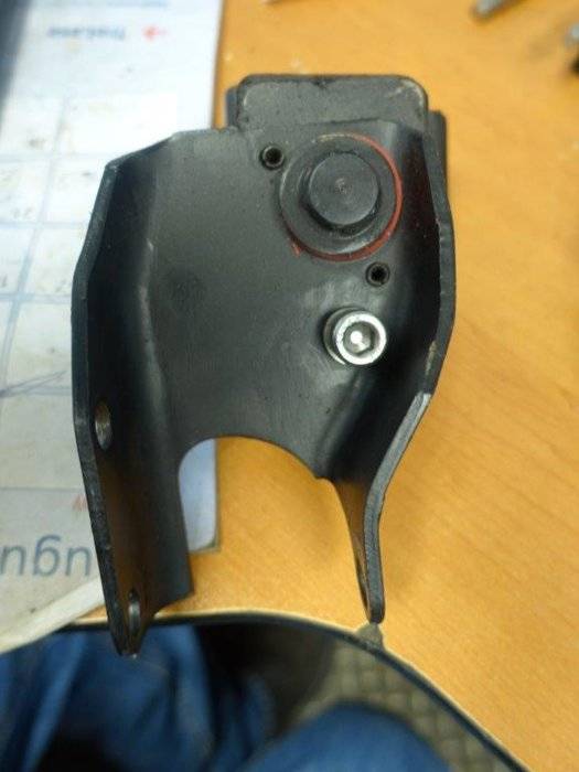

Made these after tearing out the Schumaker mounts on 416 stroker.
Bored with hole saw taking the rubber out of the hole then fitting a rear leaf spring bushing
Also pinned to stopped mount rotating had to elongate k frame hole slightly due to the larger locating bolts & pinned mount with dowel pin to stop turning.
there are 2 different mounts available 1 is made from thin steel the other is about 3/16 thick giving enough for a good thread

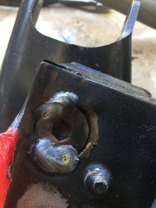

I drilled a hole for 1/2” counter sunk bolt through stock mount. This picture is before I finished welding all around. Used nylock nut with 1/16-1/8” gap at top to allow for engine vibration. Drivers side only.
I used energy suspension poly transmission mount, holding well on 4 speed 340 car. Rock auto has them also summit.
And you can do
Broken motor mounts.....here's the fix
Basically, what you'll be doing is drilling a few holes through the mount and rubber biscuit and installing grade 8 hardware. There are no torque straps or chains needed and the mount looks perfectly stock. I use a conical head bolt along with a flat washer and nylock nut to keep everything in place. The nylock will not back off or need to be retightened once it's installed. The idea is to just snug up the bolt so that there is:
(a) no compression on the rubber biscuit
(b) protection from separation due to engine torque

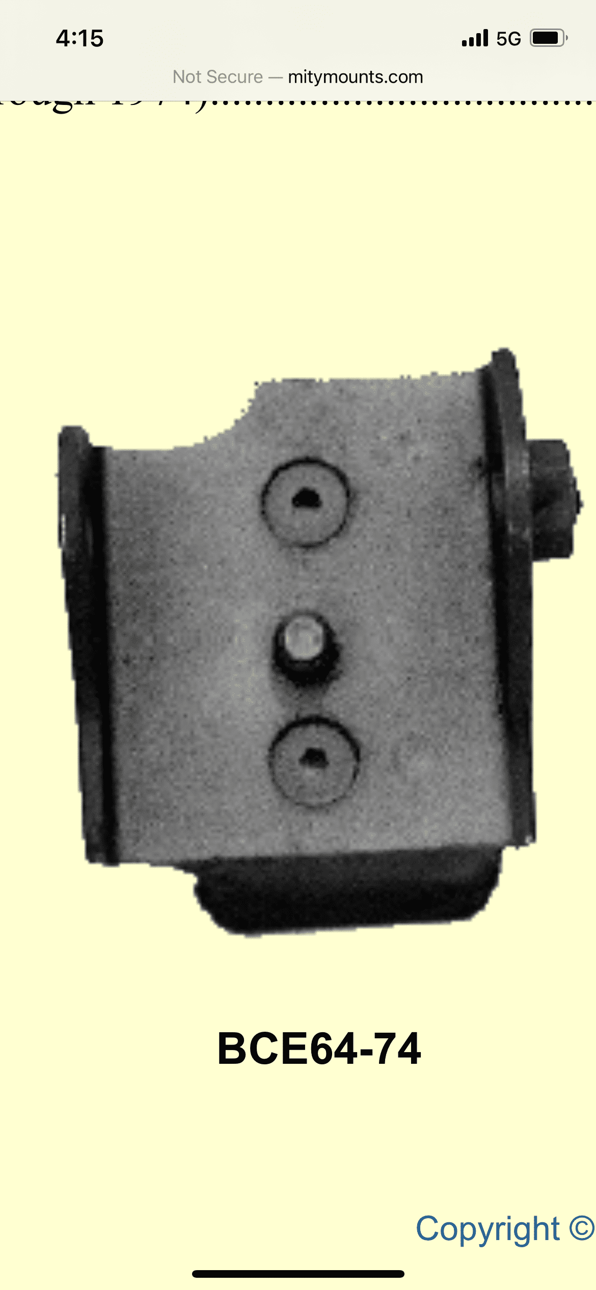

I just pulled my 340 mounts and ordered a set of the Mighty Mounts tonight. I also will reuse a torque rod on the drivers side.
