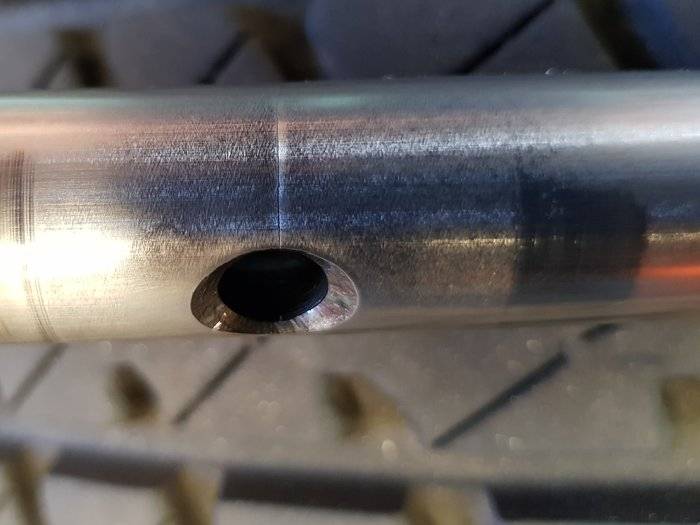

Went to refit after some engine work & noticed the radial crack on both ends of the bar .
Only on one side
Not sure cheap assed crap around 175 a set the hold down clamps are hex shaped steel not like the ones with blue aluminium clamps also noticed 2 of the roller tips are different width to the rest.
Spent the bucks & went with Harland Sharp it would be a shame to damage a good motor a 1 cheap part
I am running edelbrock heads with hydraulic roller cam oil pressure mods have been done to the block but have good lubrication at the top end the bushes really cut into the shaft like the shaft was not hardened original shaft would be ok as long as they have no wear marks causing the rocker arm to move unevenly on the rocker arm
Only 1 shaft was cracked although the other still showed signs of excessive wear
I will try the Chinese rockers on the original shafts and see how it goes if I have any problems I will put the original rockers back on. Thanks for posting this Brian you may have saved me from disaster.
