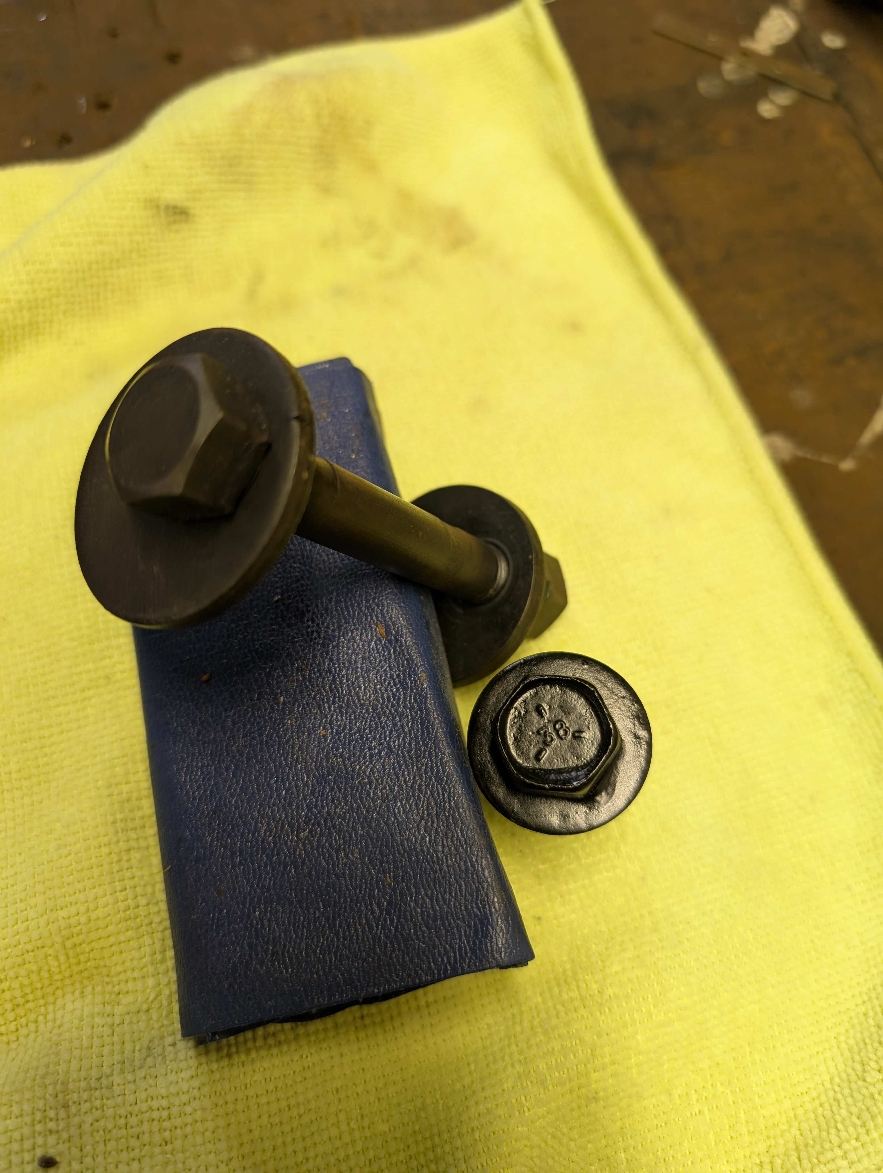

I've done all mine with Caswell - worked great. If you just black oxide them they have a sheen like the pic of the '38' bolt but if you put them in the oven they turn to a matte finish like shown. The longer in the oven the flatter the finish.

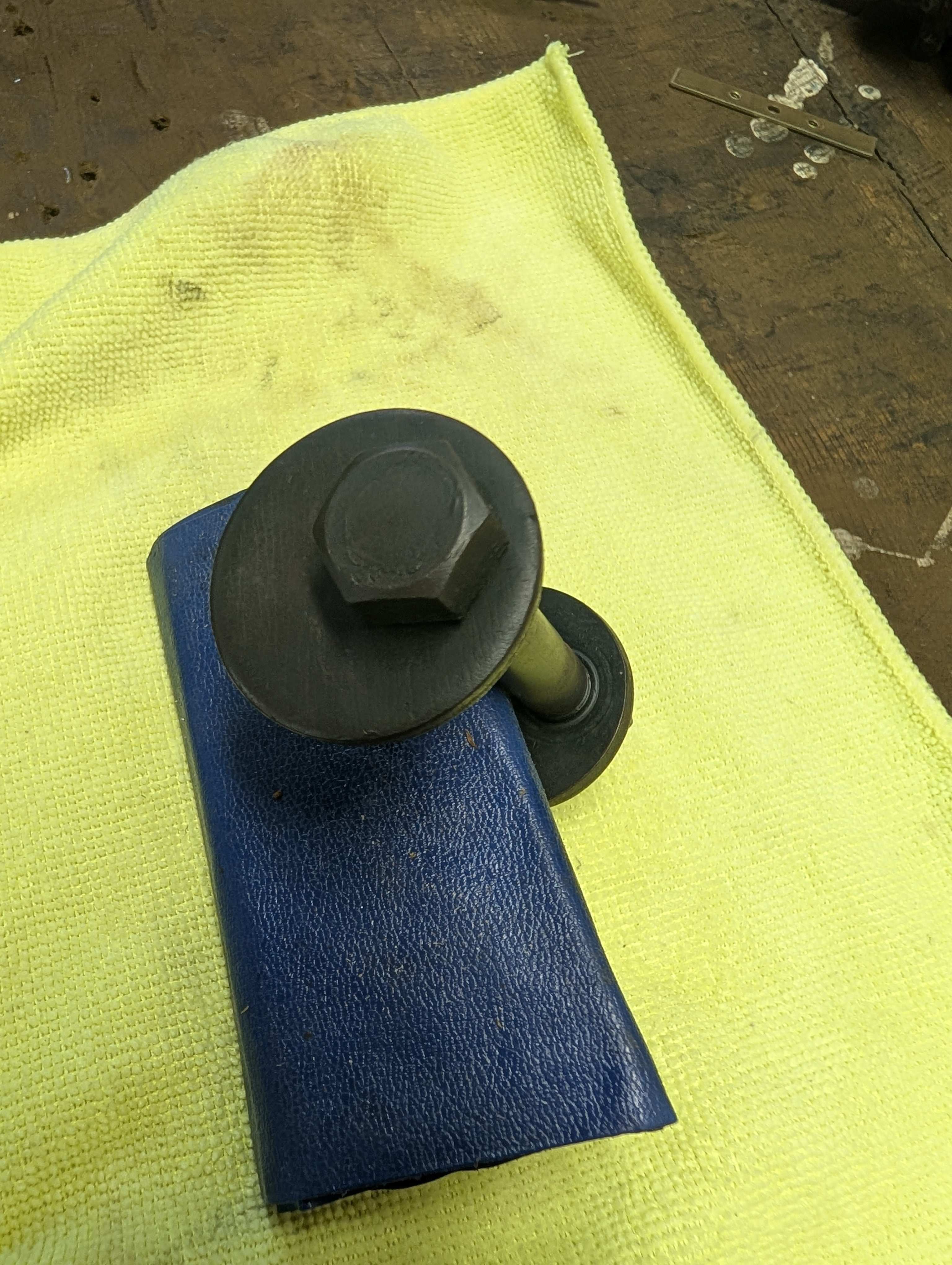

I used the Caswell kit, but i didn't have the good results like pictured above, between the bolt and washer it turned a rusty color, i thought i had followed the directions, for the price of the kit i found it didn't do very many bolts before it wore out (maybe 20) i went back to just thinning down some epoxy primer, and painting the heads

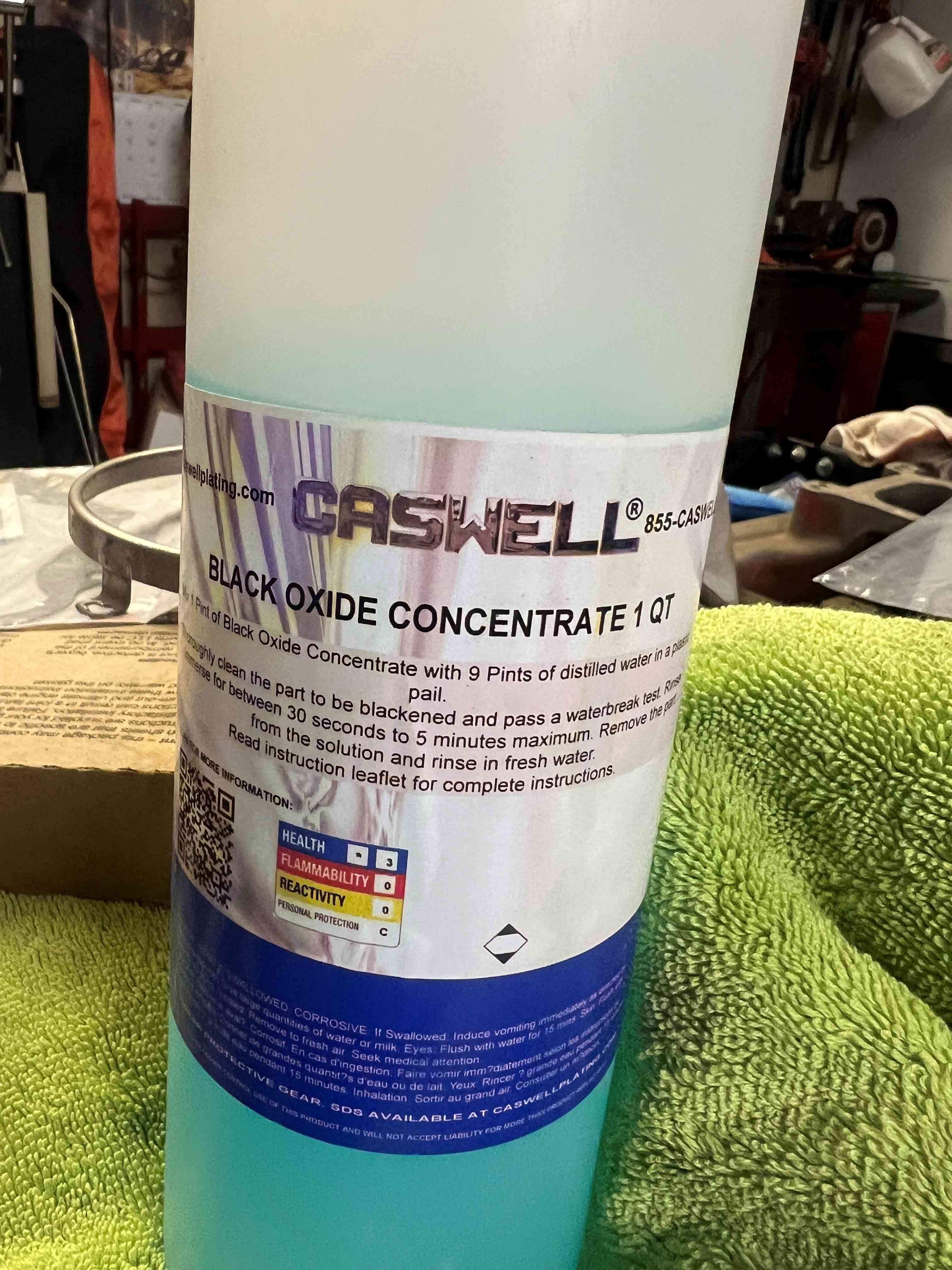

Yes Caswell works great. It depends on how to prep the surface of the part.
If you sandblast it will be more mate, but if you wire brush or sand with paper
it will be semi-gloss is what I have found.
After Caswell dip Rinse with water and blow dry then set in WD-40 that seals it.
5 minute or longer in Caswell solution ( i have left it in longer 30 minutes to 1 hr )
after rinse and blow dry I have left it in WD-40 overnight submerged.
