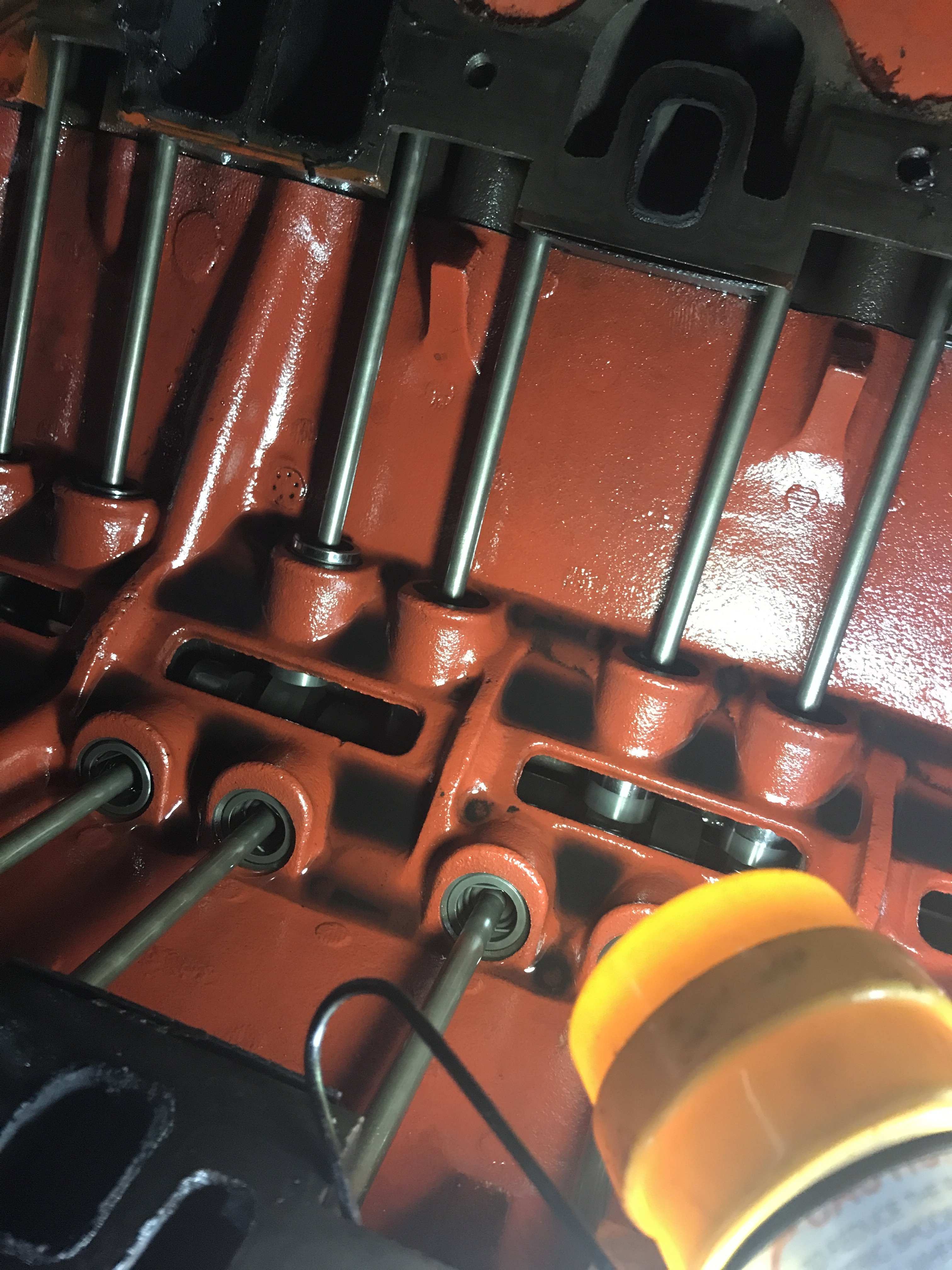

Well, an interesting surprise, pulled the intake / valley pan and seem to have a clean freshly Red painted block ( heads are orange ) sooo looks like the lower end has been worked on, now i wonder if the cam is not a single bolt but a 3 bolt? I bought the 1 bolt timing chain, MIGHT need to have a 3 bolt handy and return whichever is not needed, timing chain replacement Sept 9. Looks like very little wear on the cam, pulling the pushrods today to check them, if I need one i will have to measure since I see 2 sizes listed for sale purporting to be STOCK ball / ball, Elgin at 9.297 and Melling at 9.315 New rockers, gaskets etc here tomorrow, this is here today Edelbrock 71933 Edelbrock Performer RPM Intake Manifolds | Summit Racing Will go nicely with the black Mopar valve covers and air cleaner :) Hope the wifey doesnt see the fed-ex guy today

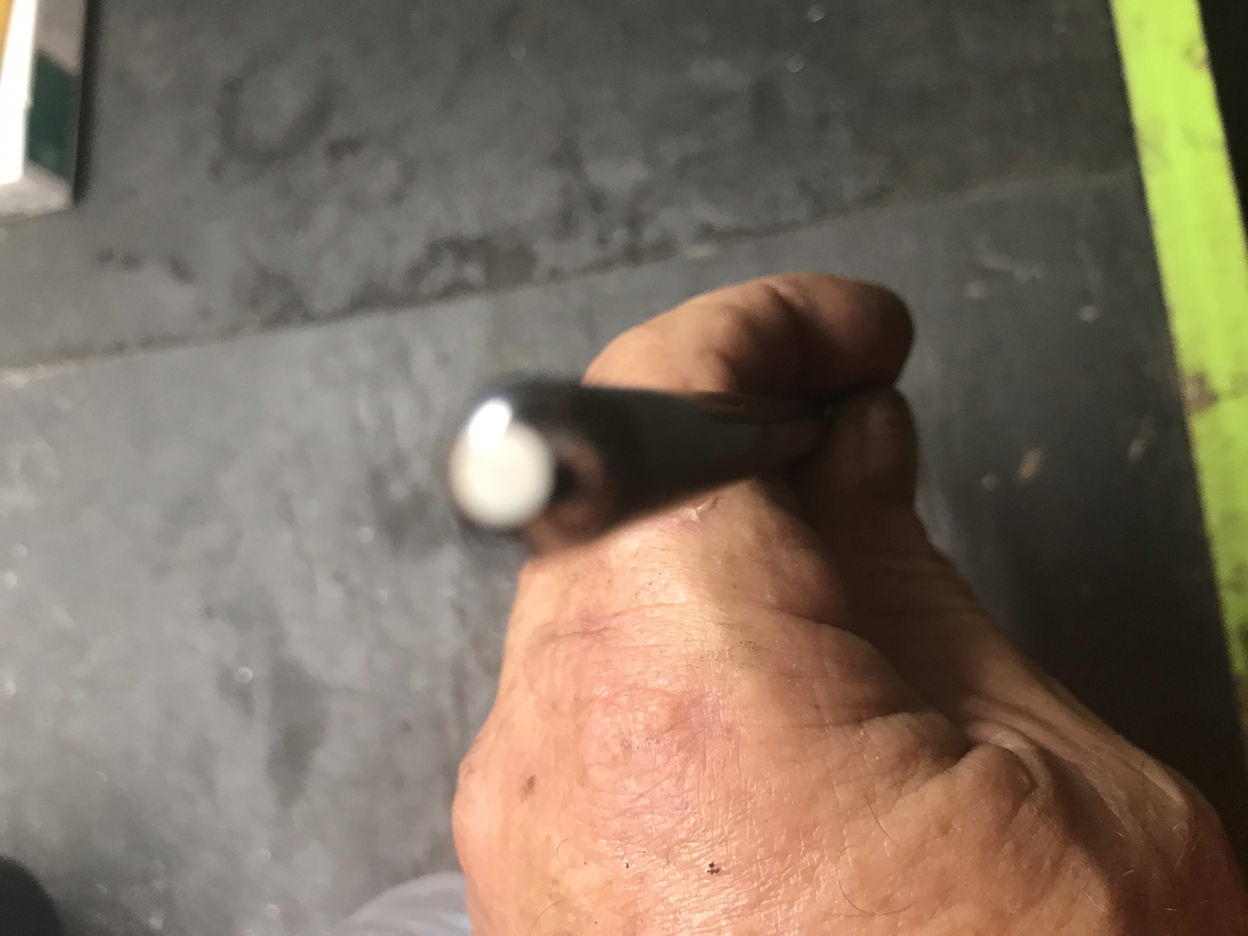

Hey Xcudame, this doesn't seem right to me, the pushrods are solid? no oil hole, although the rockers were getting plenty of oil in the rocker bottom from the shaft, wonder if this could be all the noise ?
This could be OK but just not what I was expecting to see, any input ?

There are shims for the valve springs to ensure that the valves, valve keepers and retainer gives the correct valve spring installed height.
With the factory stamped rocker arms, shimming between the posts and rocker shafts is needed sometimes for high lift camshafts. Stamped factory rocker arms are fine for ~.500" lift. Bigger camshafts (above .500" lift) really need adjustable rockers to maintain proper rocker geometry. From the one picture with a few of the liters showing, I'm not seeing a crazy highlight camshaft.
By the way, all Chrysler V8s had solid pushrods until the 5.2/5.9 Magnum engines. Even the mighty slant 6 had solid pushrods (and solid lifters) for the longest time until the factory used a hollow pushrod to convert the slant 6 to hydraulic lifters!!
I think your new rocker arms will solve a lot of your issues.
