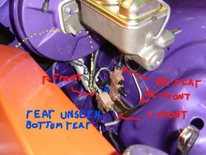

May 27, 2017 #1 J jimbyr Well-Known Member Joined Jul 31, 2014 Messages 76 Reaction score 24 Putting in all new brake lines tomorrow on my 71 340 Challenger tomorrow. If anyone has a diagram it would be very helpfull thanks Jim

May 27, 2017 #2 Adam Well-Known Member Joined Dec 25, 2012 Messages 1,676 Reaction score 741 Location Washington This is for a 71 340 Challenger with factory discs; Sorry for the crude writing, hope you can read it..
