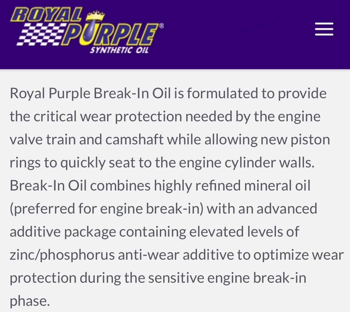

Again, asking opinions on Royal Purple to start the engine for the first time since 1998.
Xcudame
May 27, 2023
1,177
851
Southeast Arizona
Personally, I would use Valvoline VR1 for initial startup. I'm not sure all Royal Purple has zinc and phosphorus and you need that for flat tappet cams.

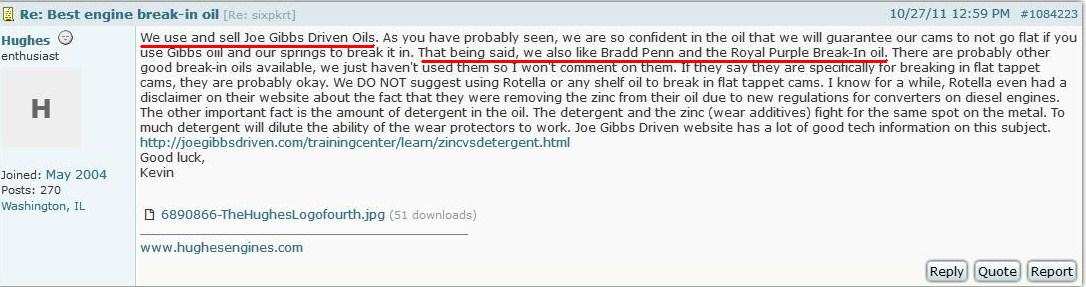

I think this is another one of those things where you could ask 50 people for an opinion and get 50 different recommendations. Brad Penn, Lucas, Joe Gibbs, on and on. NAPA recently had a sale, they happened to carry Royal Purple, I went with Royal Purple.

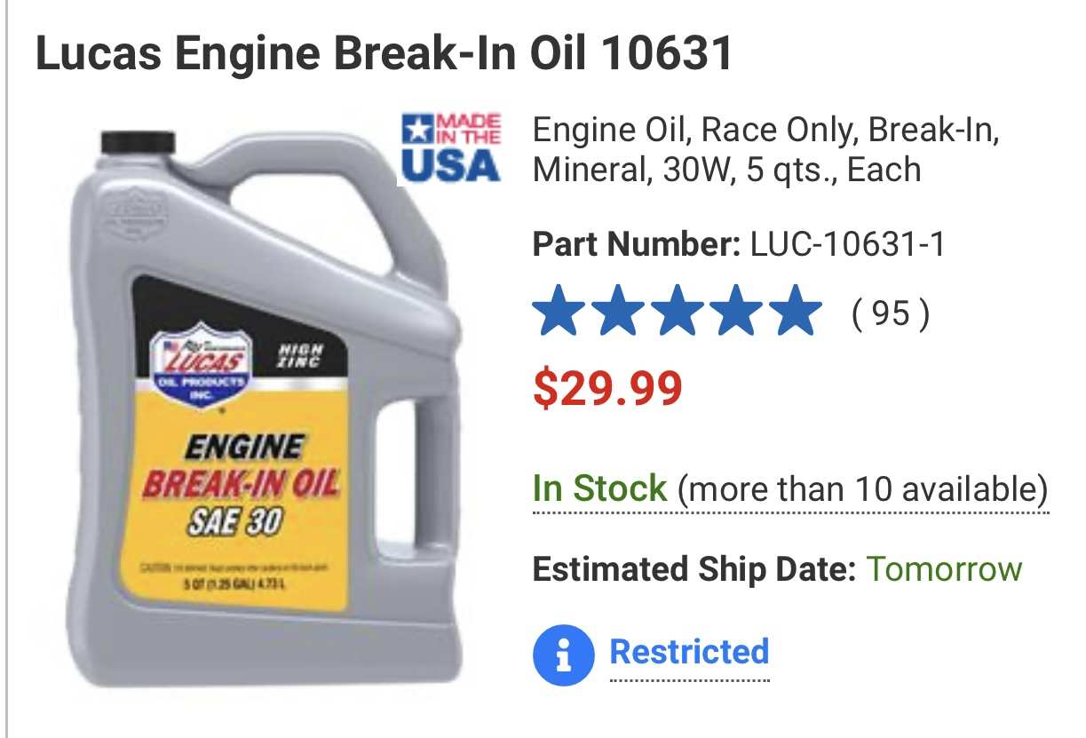

I like to use Lucas break in oil, when changed, switch to VR1.
