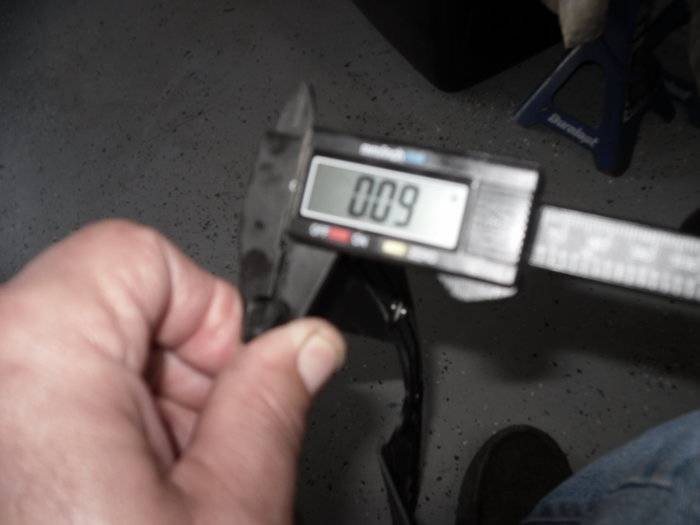

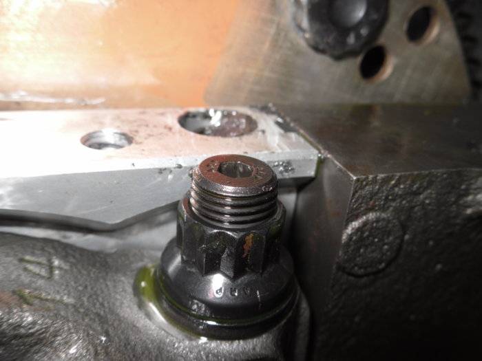

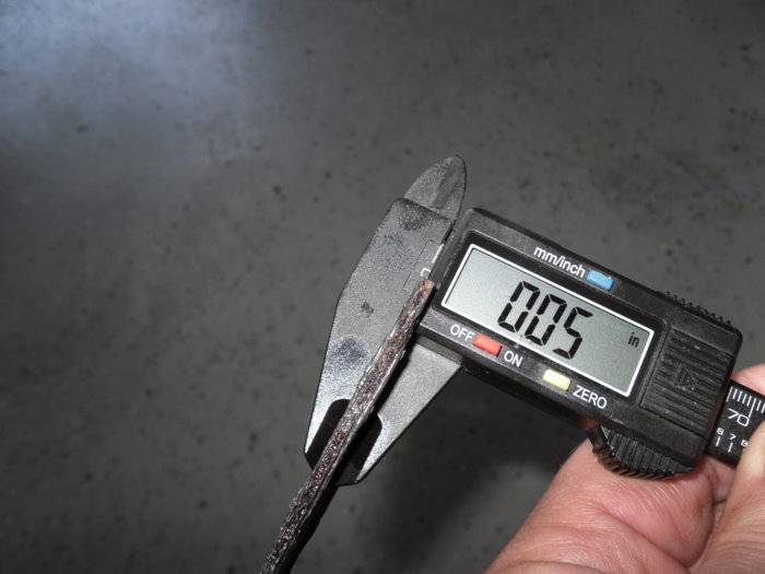

My oil pan leak ended up being from ARP main cap studs on rear cap. As you can see in following pics, the studs were hitting my 440 source oil pan preventing it from seating completely. I was using a standard cork pan gasket. By changing to the Jegs windage tray with double gasket I gained the clearance to avoid the studs with the bonus of now having a windage tray. I've read where others have shortened the studs to avoid this same problem. Here are some pics.
