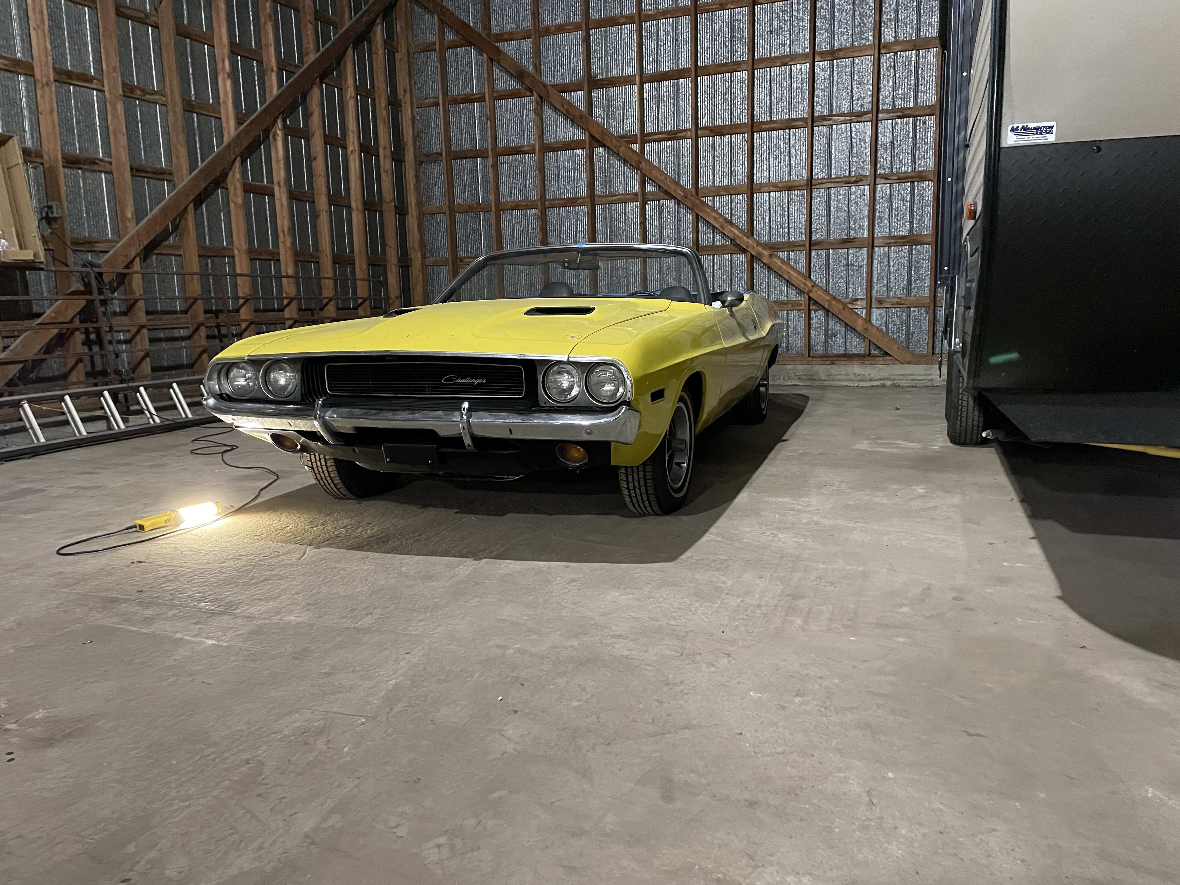

Hello, I have just purchased a car and going to lean on the collective here for a few things. 1970 Challenger Convertible
Does not want to start, going to clean up some wiring that needs a little TLC.
Rolls over very slow, tester shows low voltage once battery goes through the harness to the ballast resistor. Anybody go through this already?
