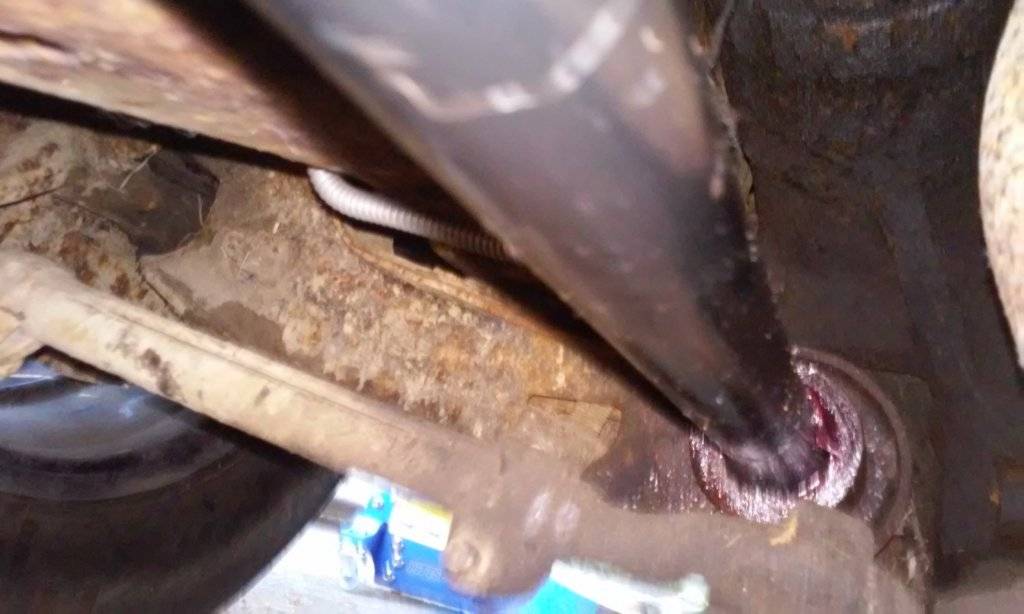

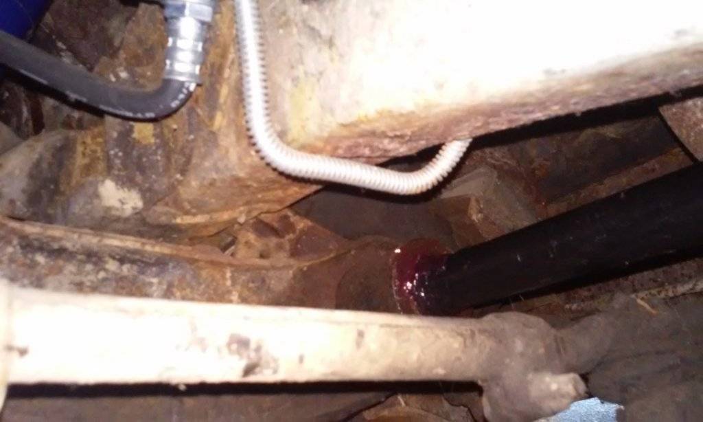

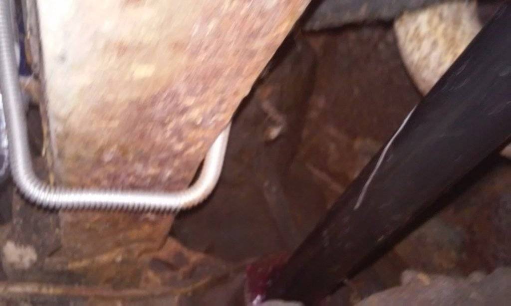

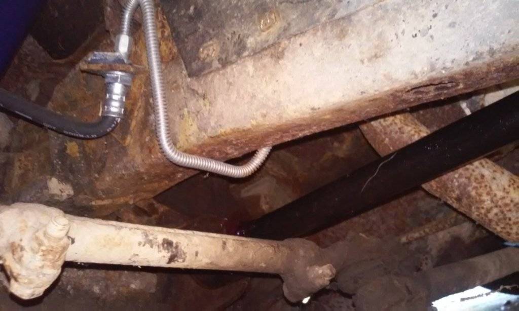

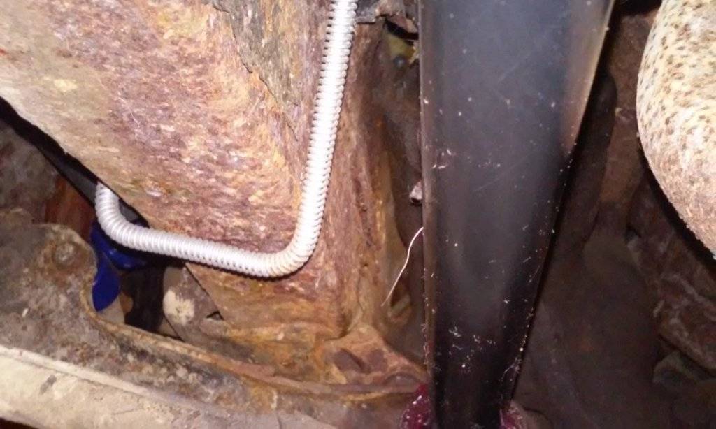

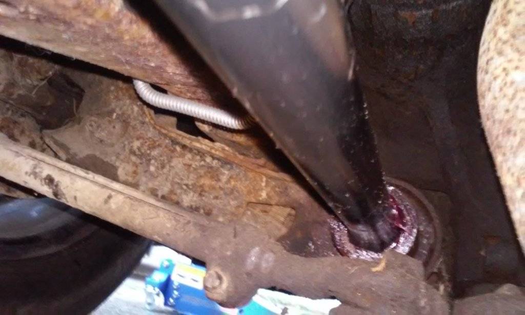

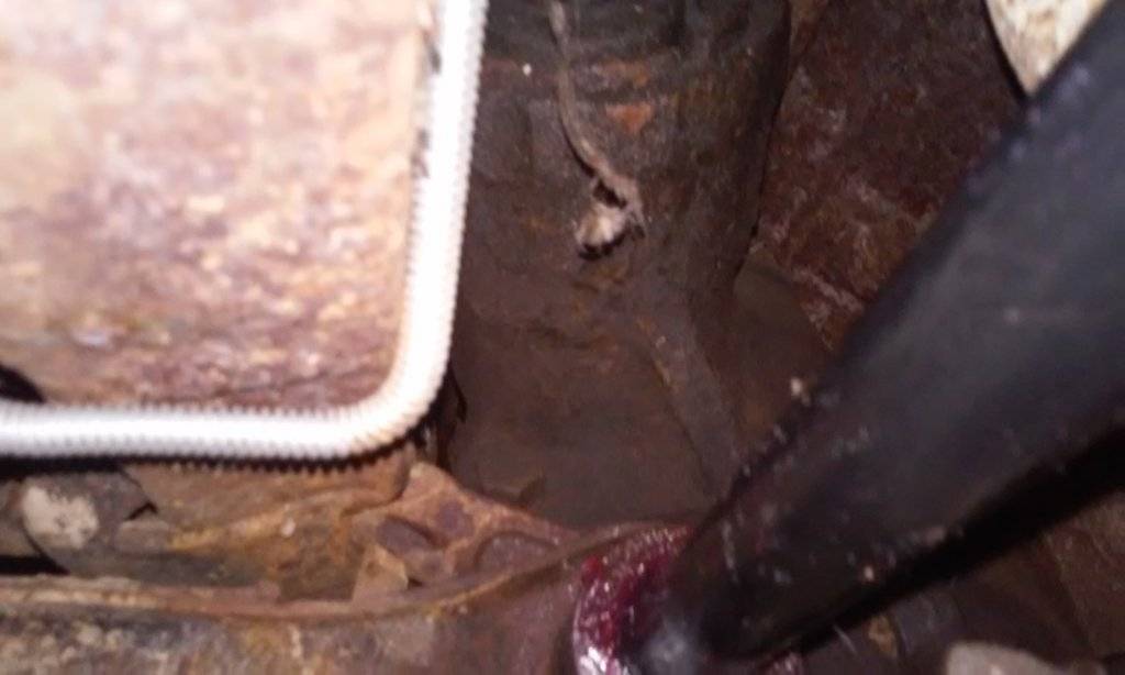

I finally got around to working on this. The driver side T bar was snapped.
Swapped both driver and passenger and the car still sits low like it did before
all leaning to the driver side.

Take some pics. You may need to work on the crossmember the bars mount in.

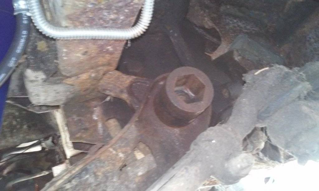

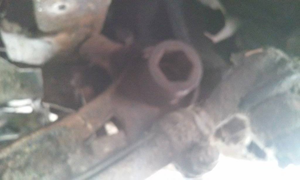

Did you have the LCA hanging in its lowest position when you put in the t-bar? Did you also have the adjusting bolt and cam in its lowest position? Make sure you lube up that adjusting bolt. Is the rear t-bar socket solid and in good shape?
May 27, 2014
13
The car was up in the air on jack stands. Frame supported. Suspension Hanging. The adjusting bolt was loose.
One of the pic that shows the socket and arm is how the car was when I got it up in the air.
The rear sockets are in good shape.

The adjusting bolt cam/arm looks to be too high. Did you have it rotated down when the t-bar was put into the socket?
May 27, 2014
13
I think that is the issue moparlee. I need to rotate it and then insert the bar.

PB Blast that adjust bolt/nut. Turn the bolt out/down till only the ball end sticks out. Pry that arm back down to the ball end. If needed, lift the upper control arm off the bump stop and remove the bumper to gain more LCA drop.
