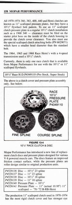

I am looking for something as close to stock performance as possible -
That means B&B style, 11" scalloped I believe.
