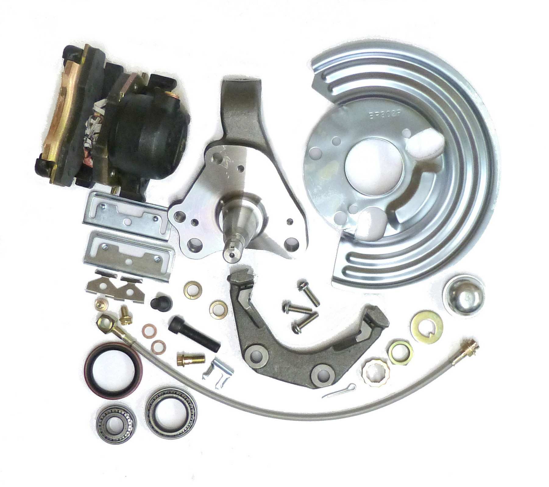

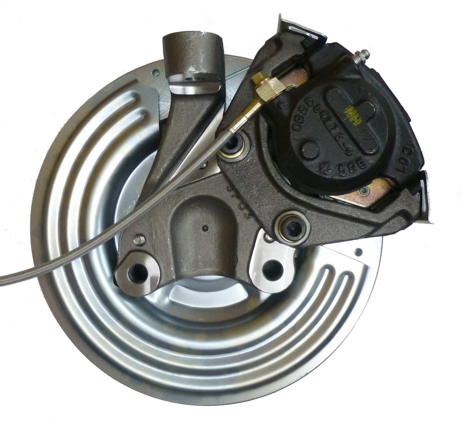

The Doctor Diff Stage 2 kit includes the caliper brackets for the larger 11.75" rotors (commonly called 12" rotors).
You will need 15" wheels as @Challenger RTA noted above and the spindles to accept the the larger caliper brackets if you do not have those.
Here are the photos of the Stage 2 kit and the larger caliper bracket. The site has a minor issue with displaying the product photos.
If 15" wheels are not in your plan, select the Stage 1 kit with the smaller rotors (10.95").
