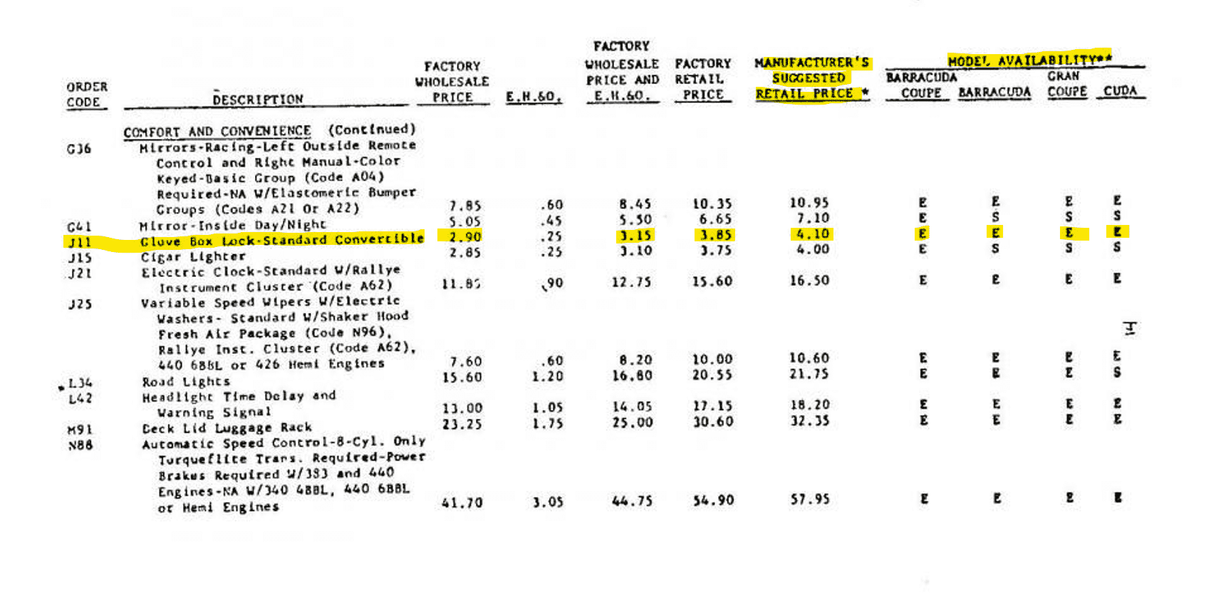

I found the Glove Box Lock option code in the 1970 Barracuda Pricing Bulletin. It is option code J11 Glove Box Lock - Standard Convertible for $4.10 retail price and available on all models. I do not see J11 as part of any other A code packages.

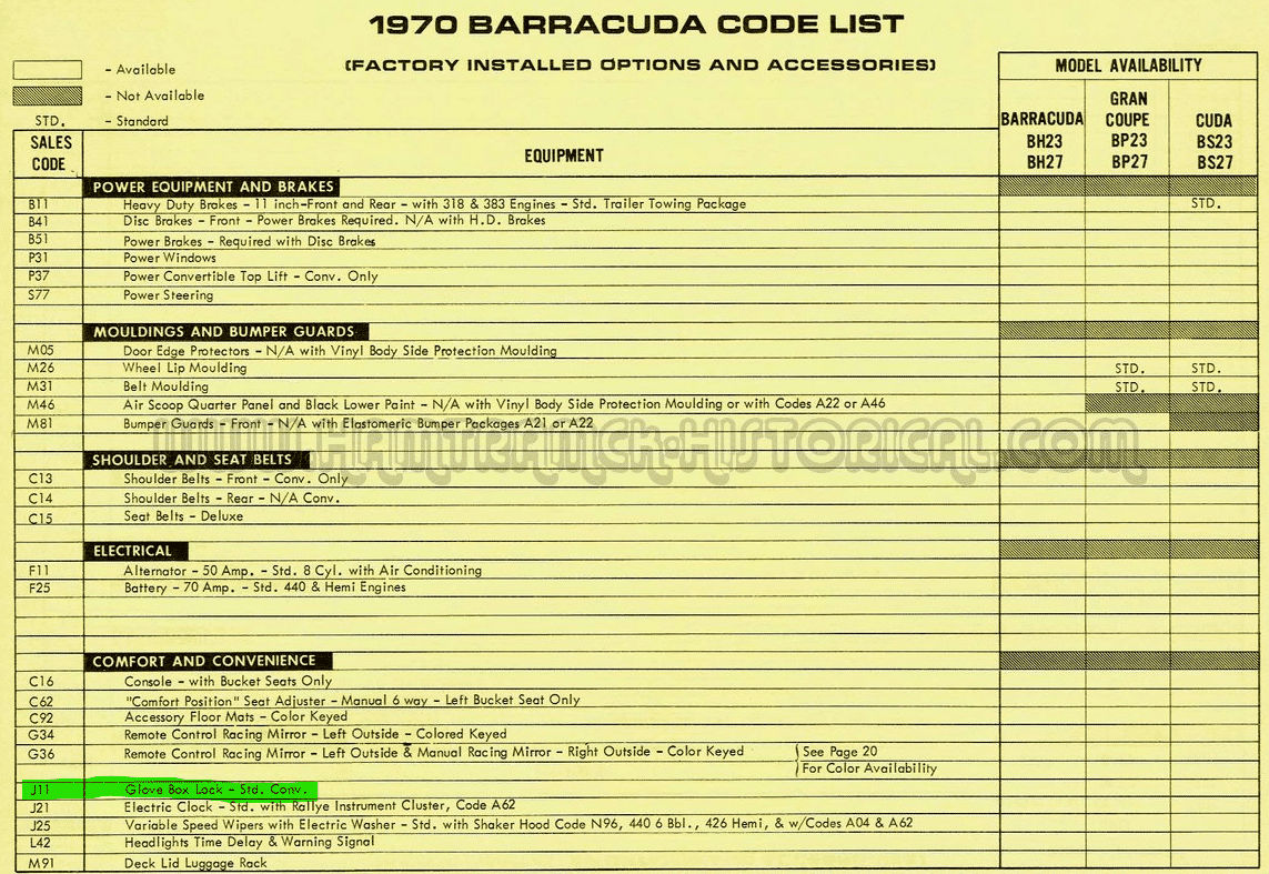

I also found J11 listed in the "F" Series 1970 Model Code Lists booklet on page 25.

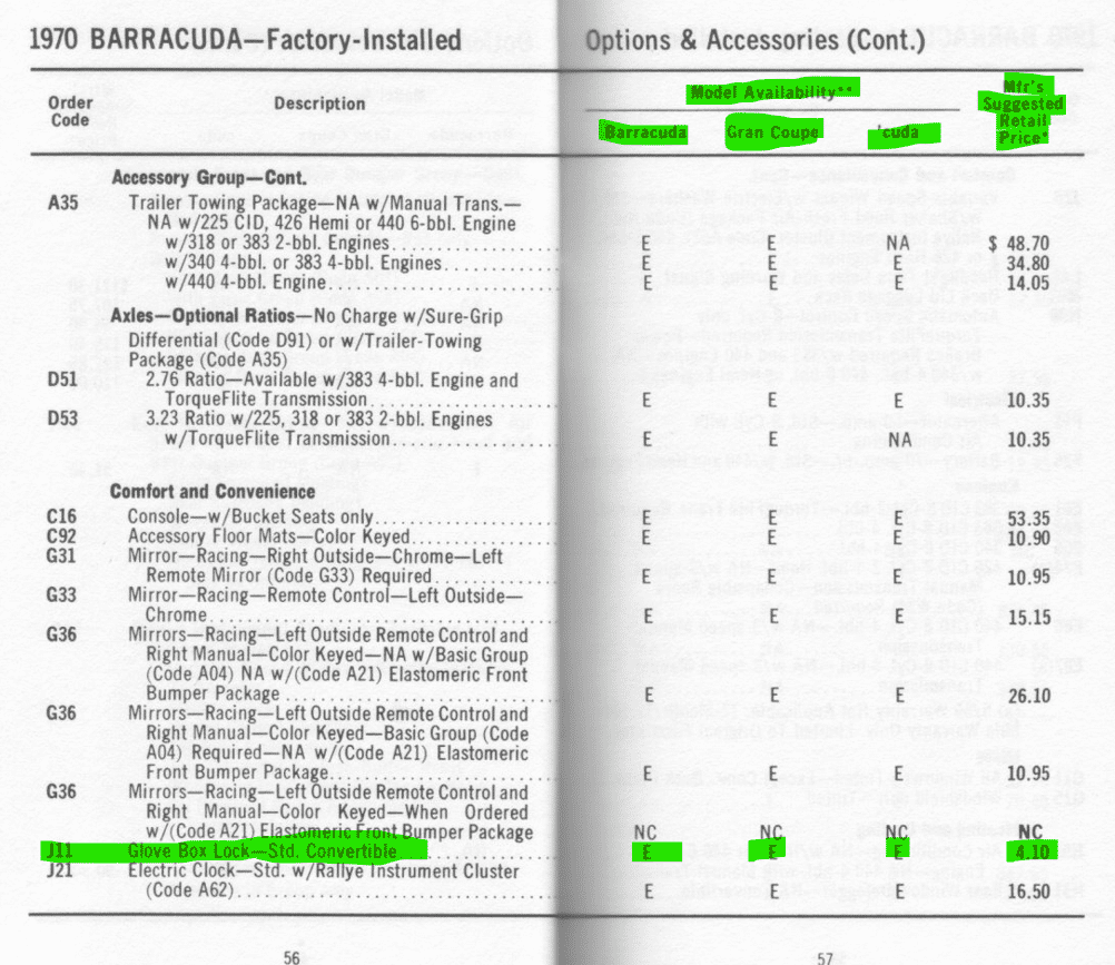

And it is also in the 1970 Car and Equipment Prices a.k.a. the Pocket Salesman Guide on page 56-57.

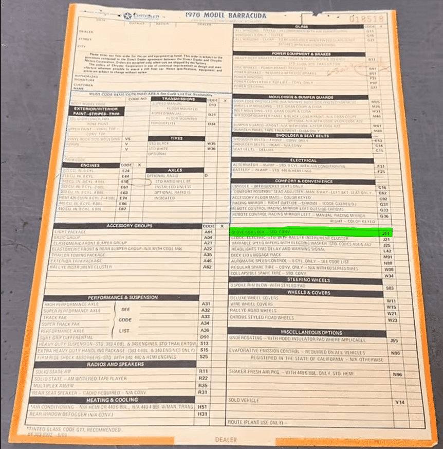

And it is also on the 1970 MODEL BARRACUDA Vehicle Order form used by the dealership to select your options on an ordered car.
