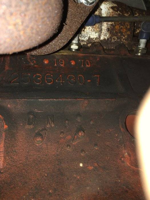

2536430 is the engine block casting number. I should have said the transmission part number from the drivers side pan rail then I could look it up and see what the trans was out of.

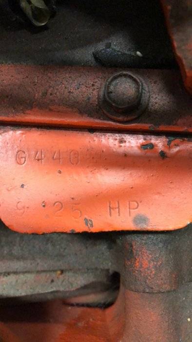

G 440 is a 1971 engine. The letter before the displacement is E=69, F=70, G=71. I think the letters before E go back to A=65, the first year of the 440?

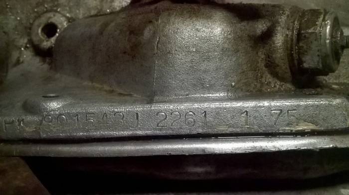

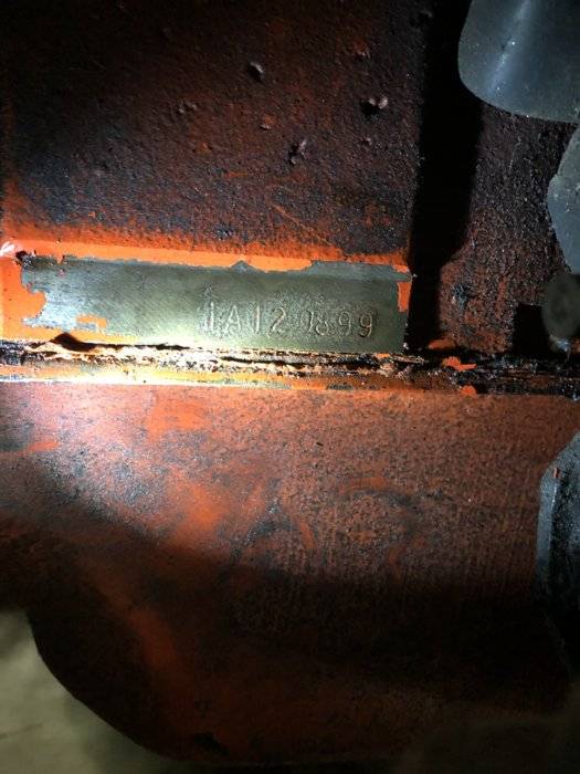

There is absolutely no way for sure to tell if that block was originally a 71 440 six pack unless you know the rest of the VIN # stamped on the pan rail.
