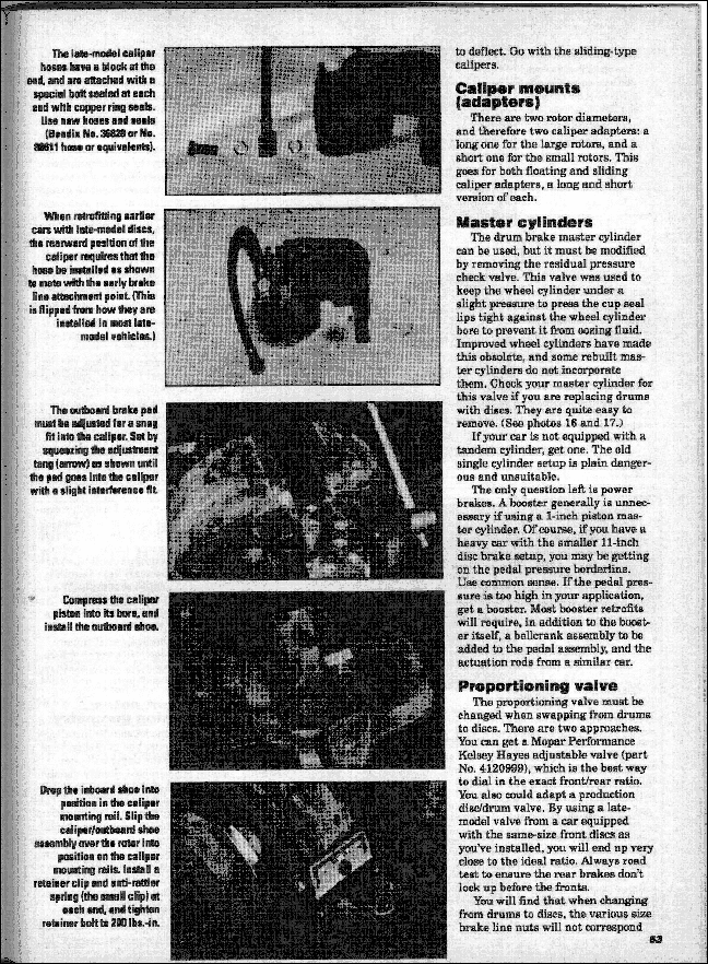

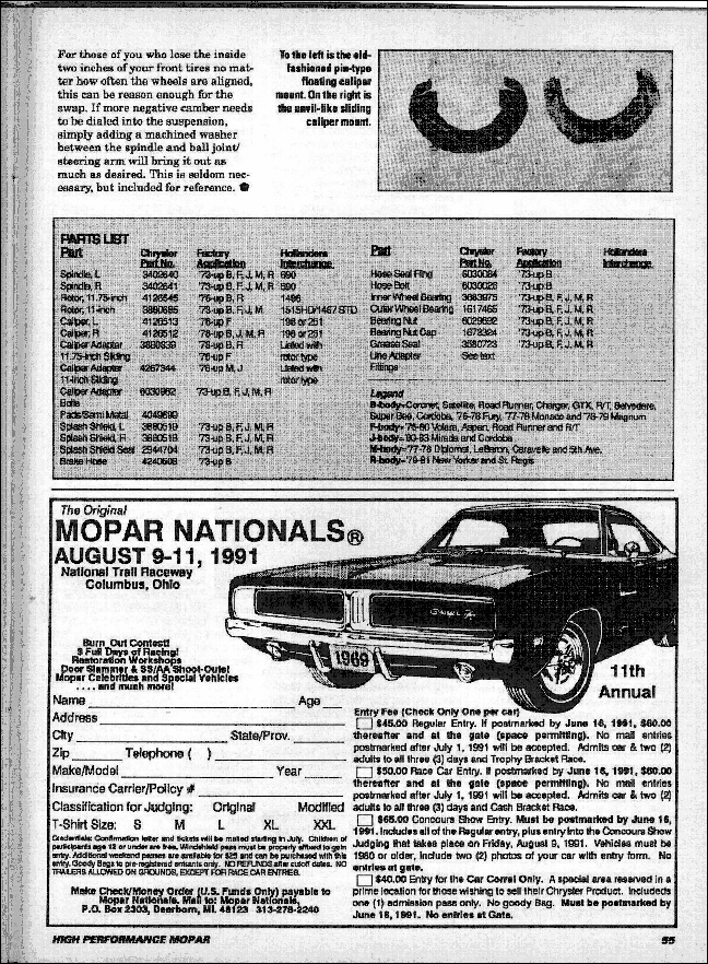

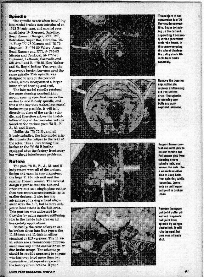

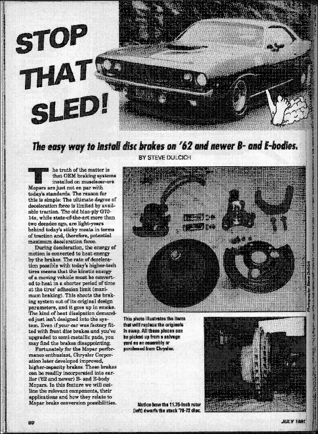

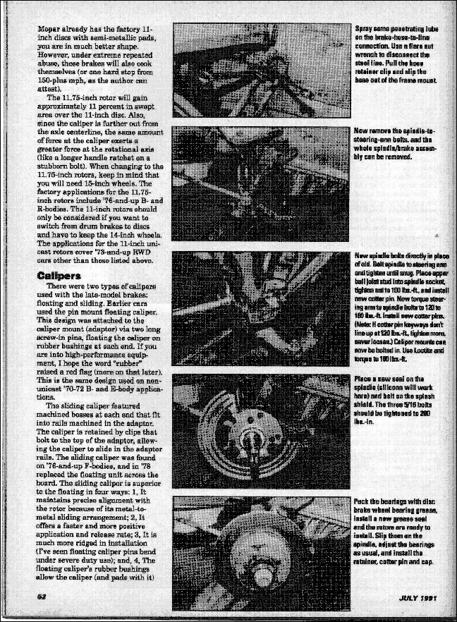

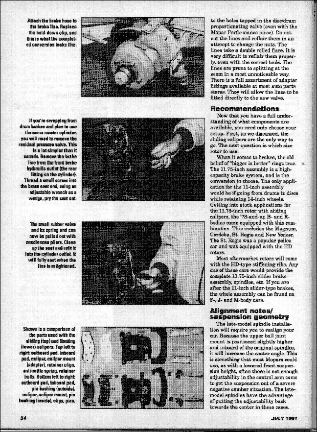

Here's one of the articles that cover it.
