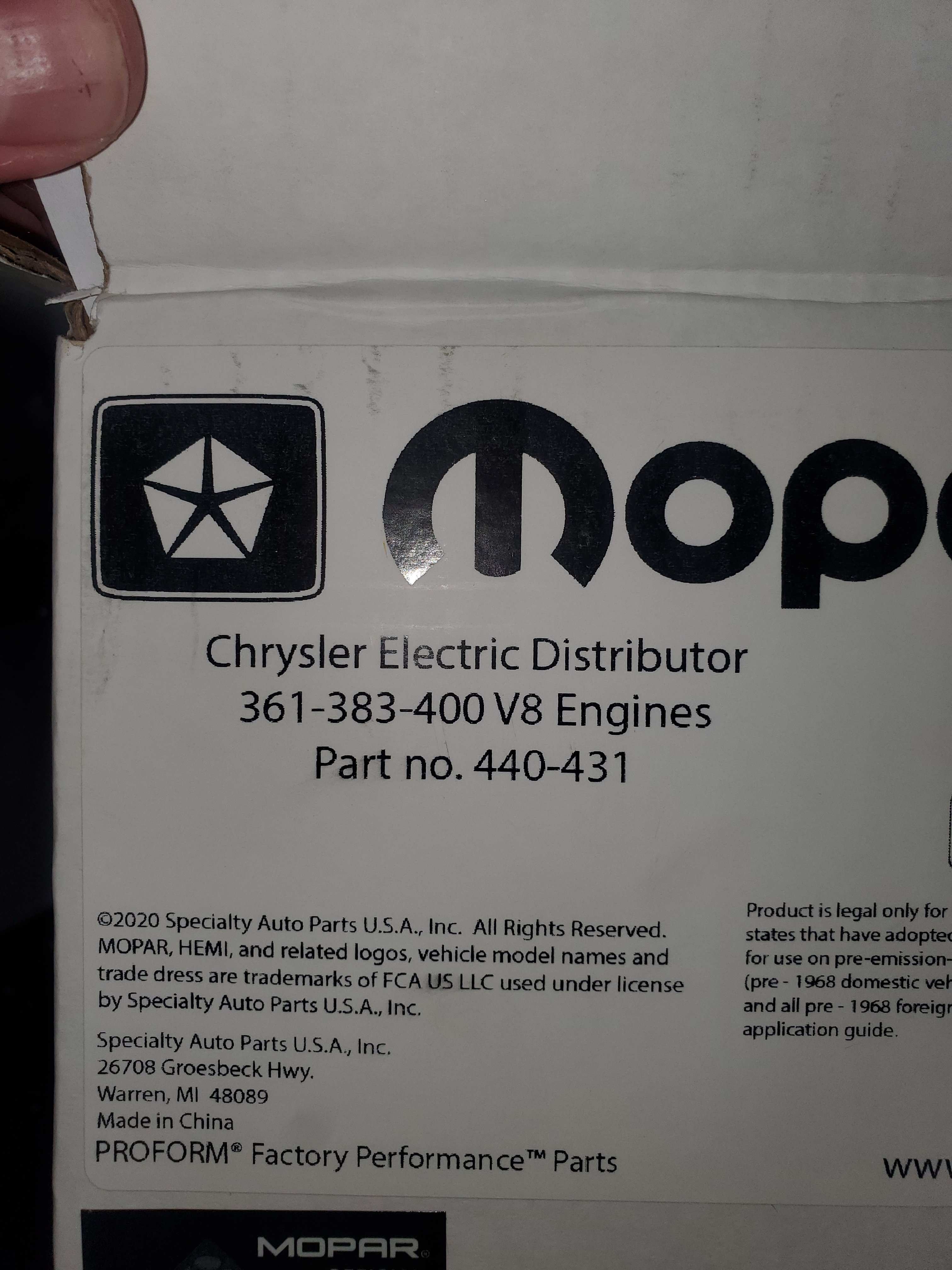

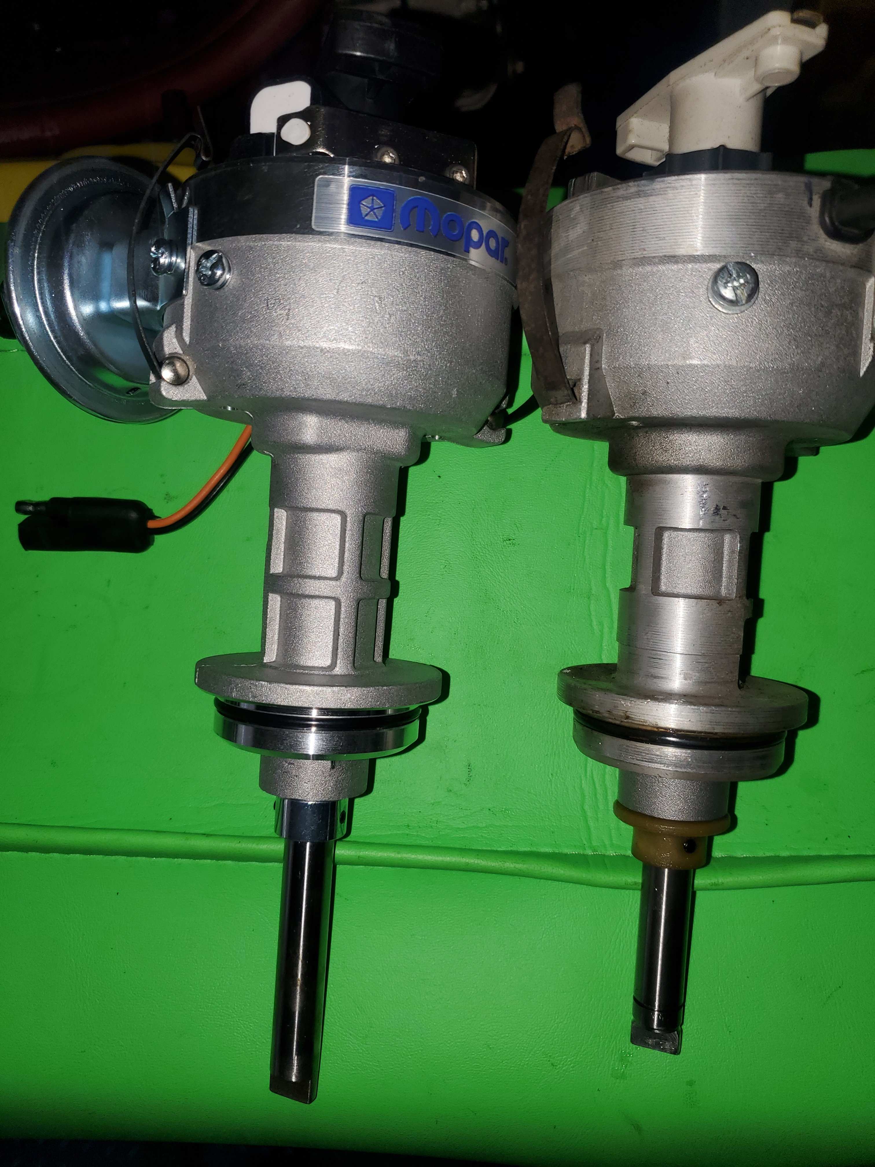

Almost every single part on the car is different , it's been a long 7 months , ok now I just ordered a new distributor and the shaft is different lengths , the on on the right says Proform the one I ordered is a Mopat Proform, did I order the wrong one , this is the one I ordered , any info would ne great.

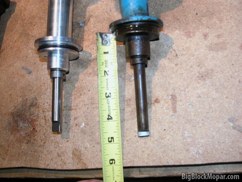

The longer one is for a raised block engine like a 413, 426 or 440. The shorter one is for the "B" big block engines like 361, 383, 400. I found this comparison which might be helpful.

I know I have a B block , my cast number is 2468130 , the description on Summit says it fits big block B , where you go to check the fit it has 383 big block B so maybe they need to fix their website .

Sometimes the description is incorrect, which obviously yours is! At least Summit has a good return policy! I would prefer to get the correct distributor but some have used a spacer to allow them to run the longer distributor in the low deck engines.

I saw the adapters , 1 1/4 or 1 1/2 , but will call tomorrow and have a talk , purchased a lot from them , maybe they will do me a favor .
