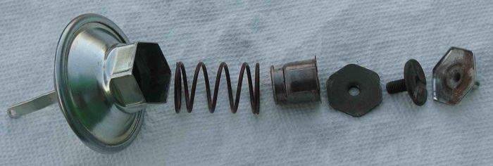

This what is inside a canister , once the screw is backed out of the 6 sided plate it will butt up against the end of the housing preventing the arm from being pulled no matter how much vacuum you pull with .
