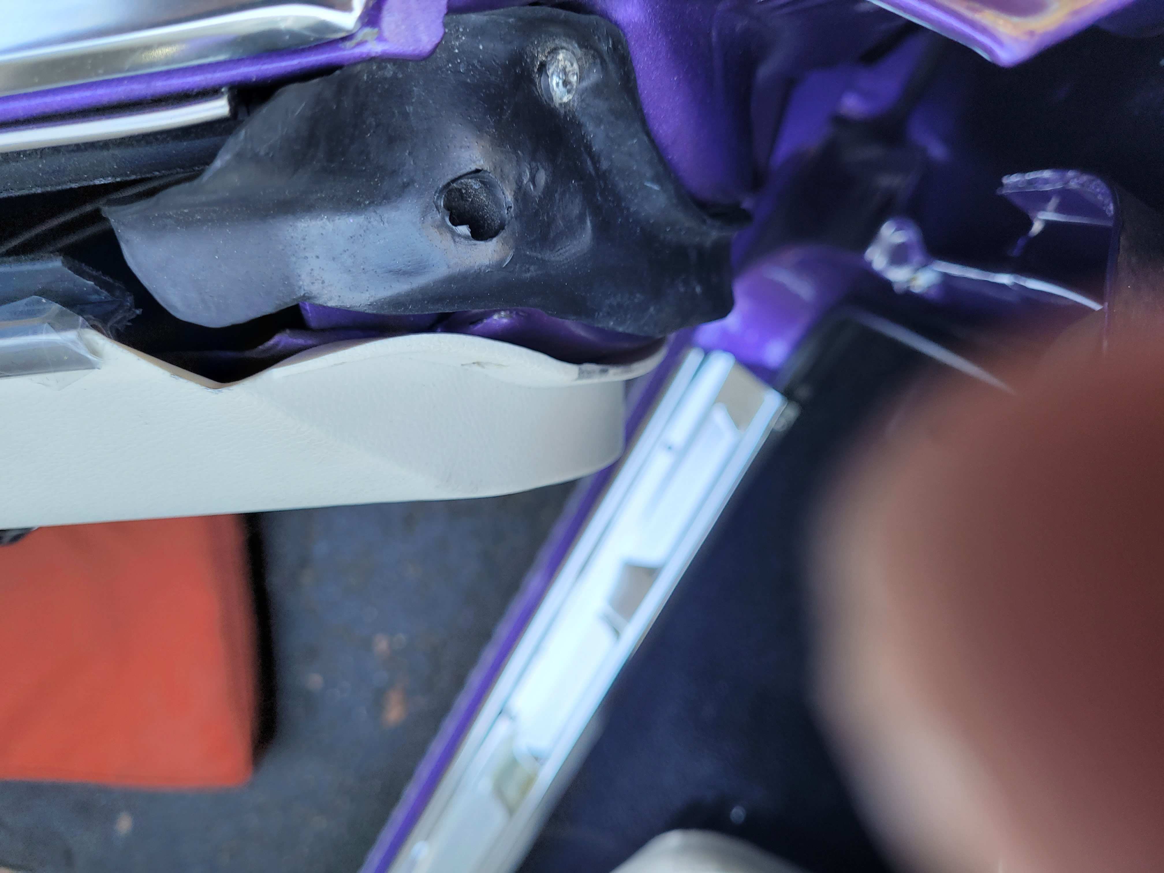

Hello, I sure hope someone can help with this. I am putting new door panels on my 73 Challenger but they are about a 1/4 inch too narrow. If I hang them and put the screws in the back, the front screw holes are close to a 1/4" short of lining up. I tried heating the ends with a heat gun and it did get it closer but I'm afraid of distorting the plastic. Has anyone encountered this and how did you rectify it?
I will try to get a photo today.

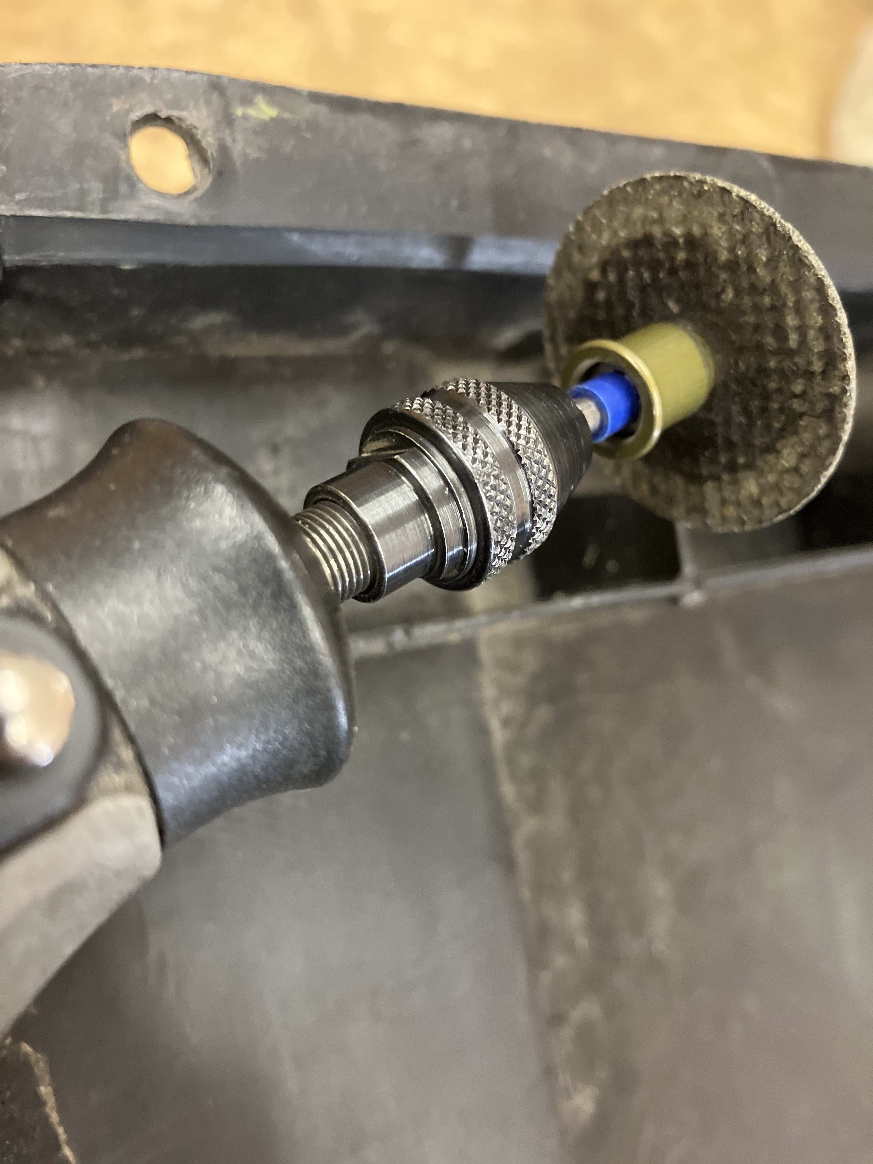

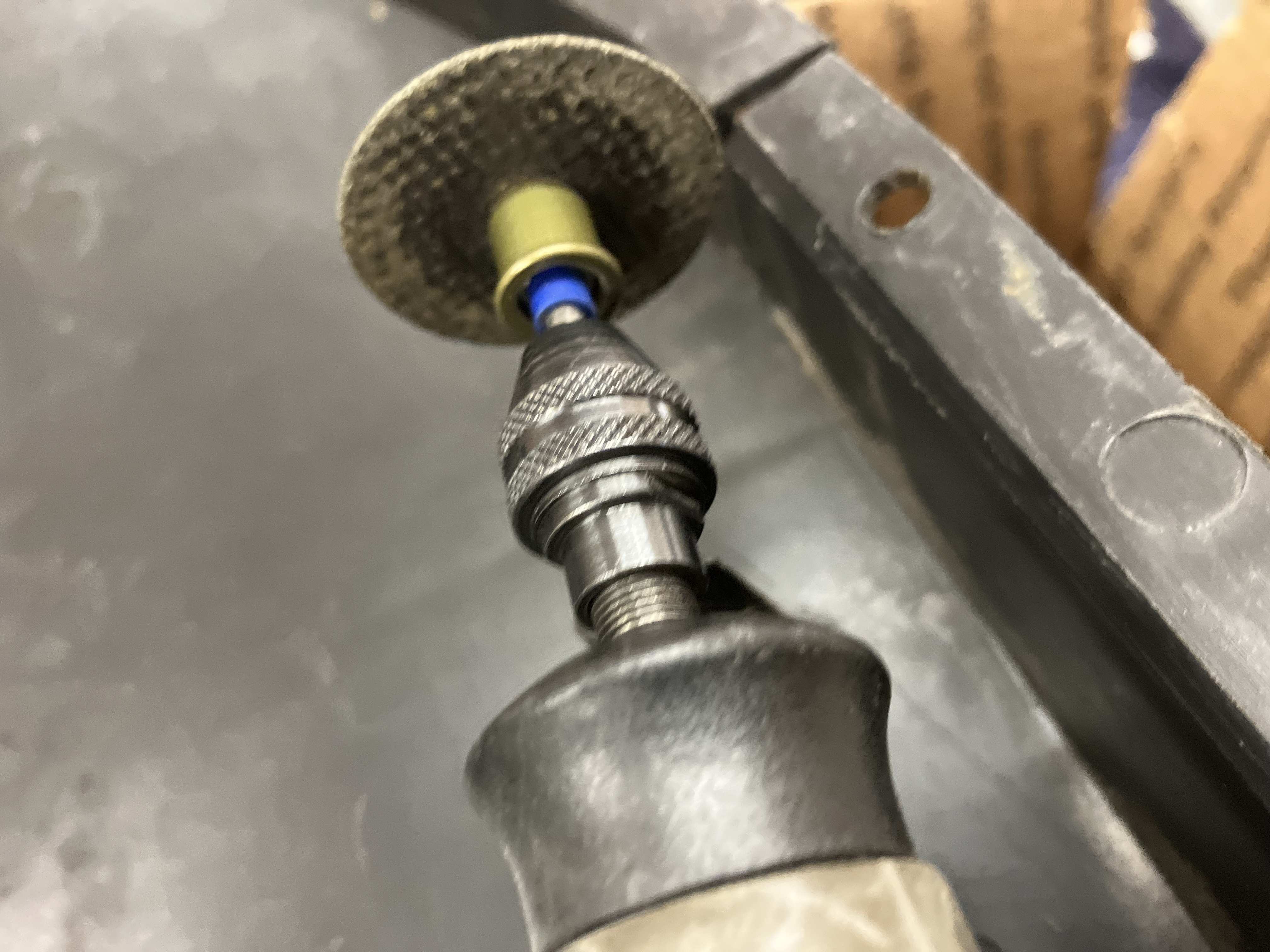

I ran into an issue with the reproduction inner door panels. The originals had a beveled edge on the inner portion where the plastic meets the metal door shell. The repros have a hard edge which prevents the panel from fitting snug.
I used a dremel with a cutoff wheel to bevel the edges and they fit well afterwards. Obviously, you need to be careful with the cutting wheel, but it’s relatively straightforward.

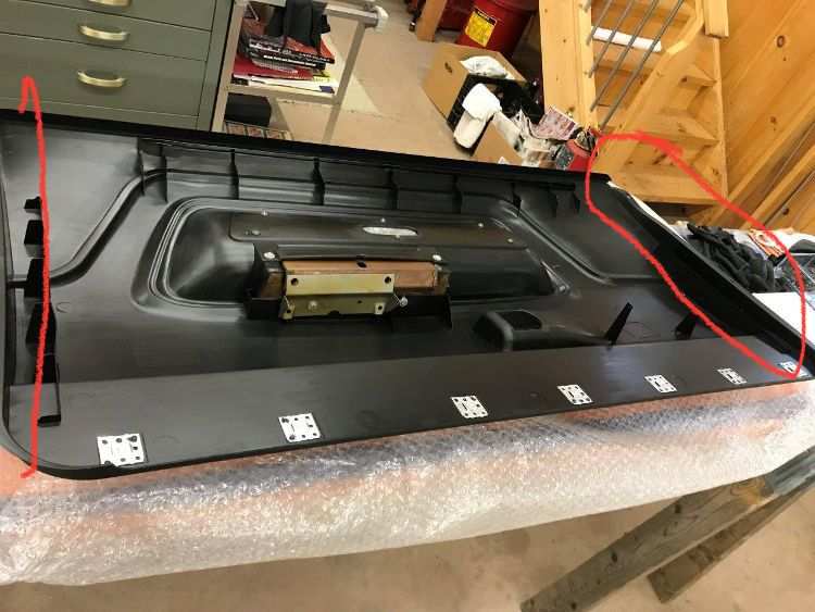

If you still have your originals, do a side by side comparison. You’ll see what the issue is. This seems like a tooling issue to me.

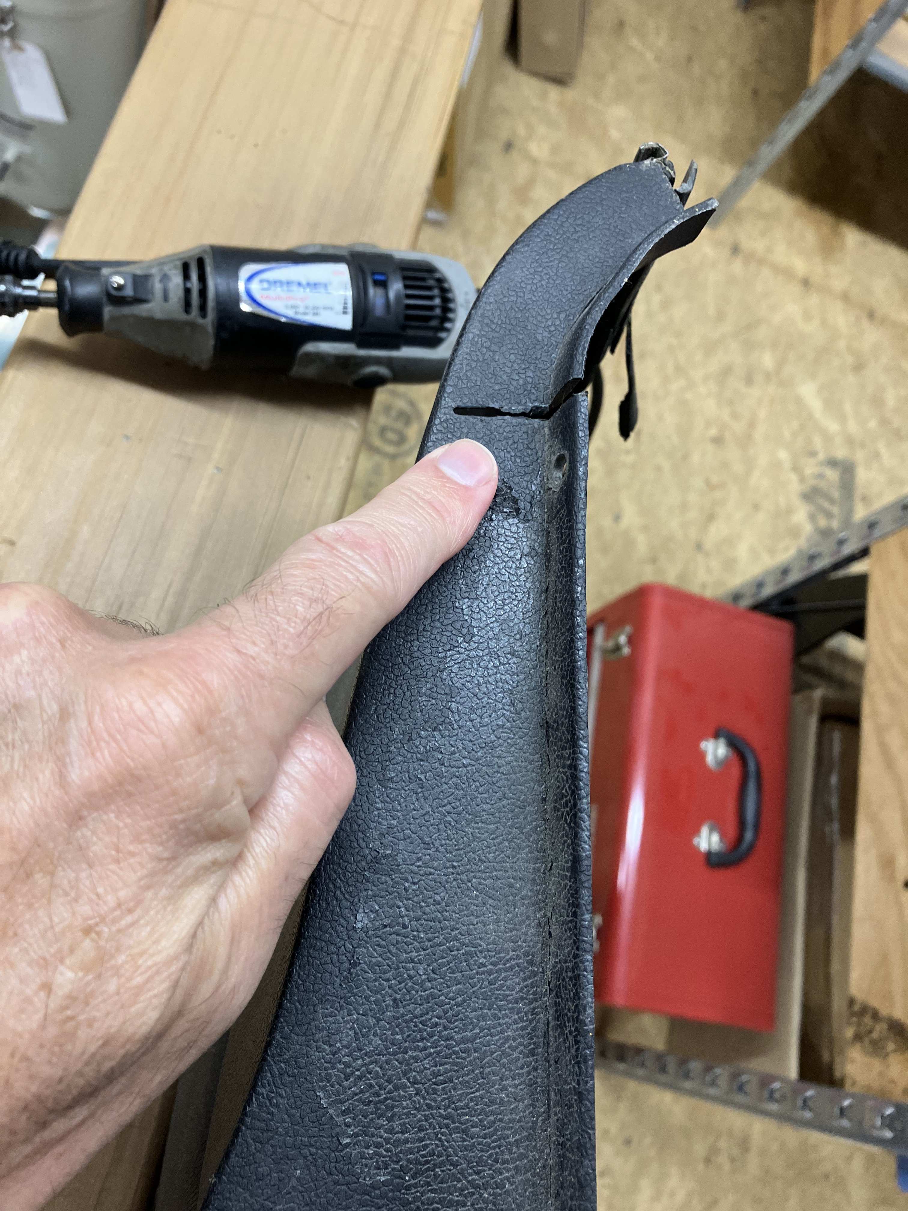

Another difference I found between my originals and the reproduction was the lack of these small contour notches. I’m only familiar with 70-71 Challengers but all my originals have these notches.

Hi Floyd, thanks again for the tip.... That worked😁
