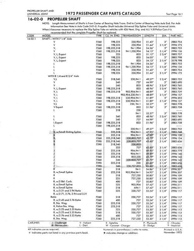

moparleo
Oct 17, 2011
7,102
1,886
Try this.
ebodydriveshafts (2).jpgWoops, I see that you need 1970 drive shaft specs
