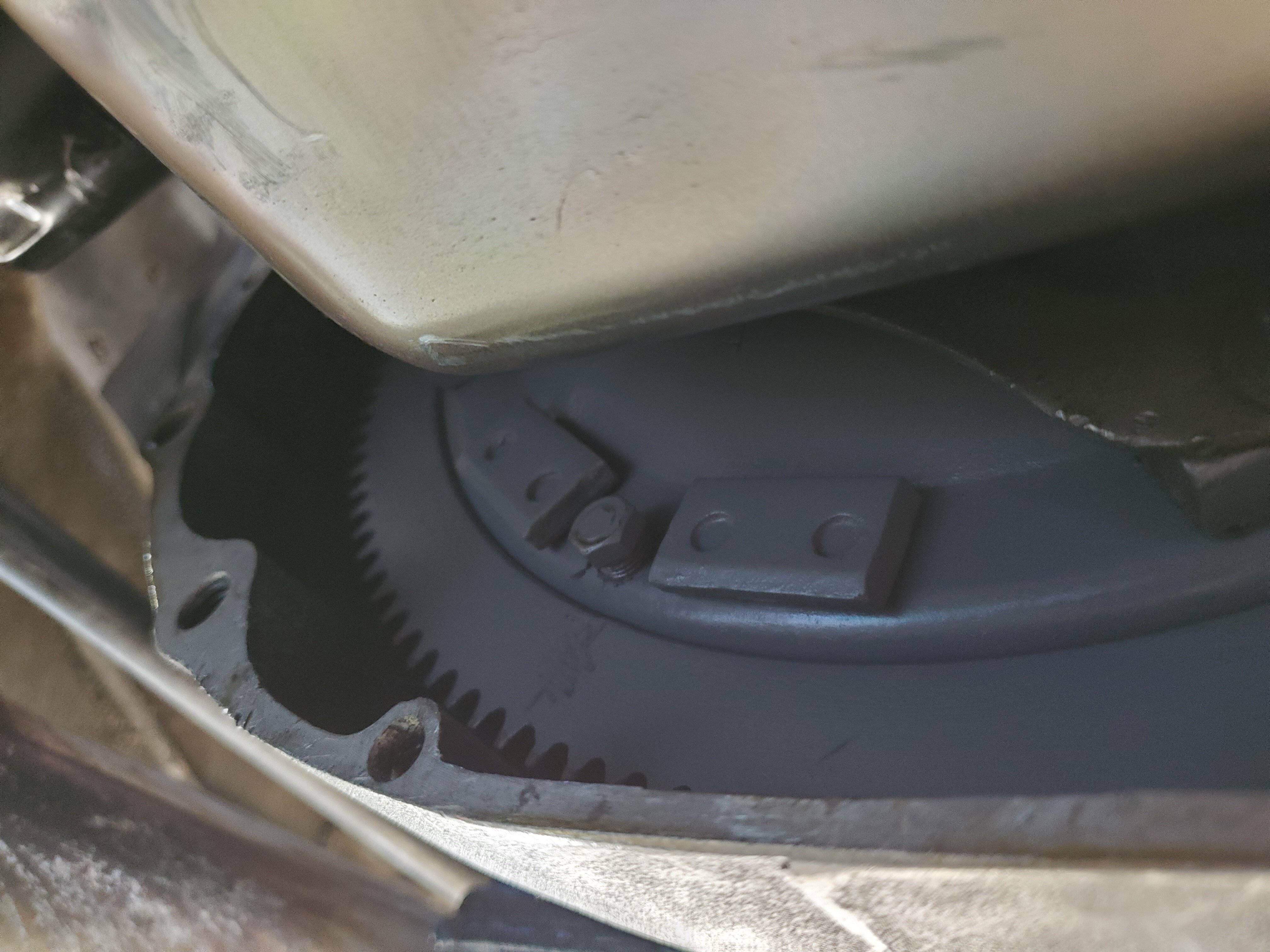

No, it’s one or the other… but be aware magnum and LA 360 balancers, flexplates, and converters are not interchangeable; they will bolt on but are balanced differently.
You can use a weighted flexplate with a neutral balance converter and vice versa.. also some aftermarket balanced flex plates like the B&M don’t have a weight but remove a piece from the other side to create an offset weight.
It looks like the weights are there.

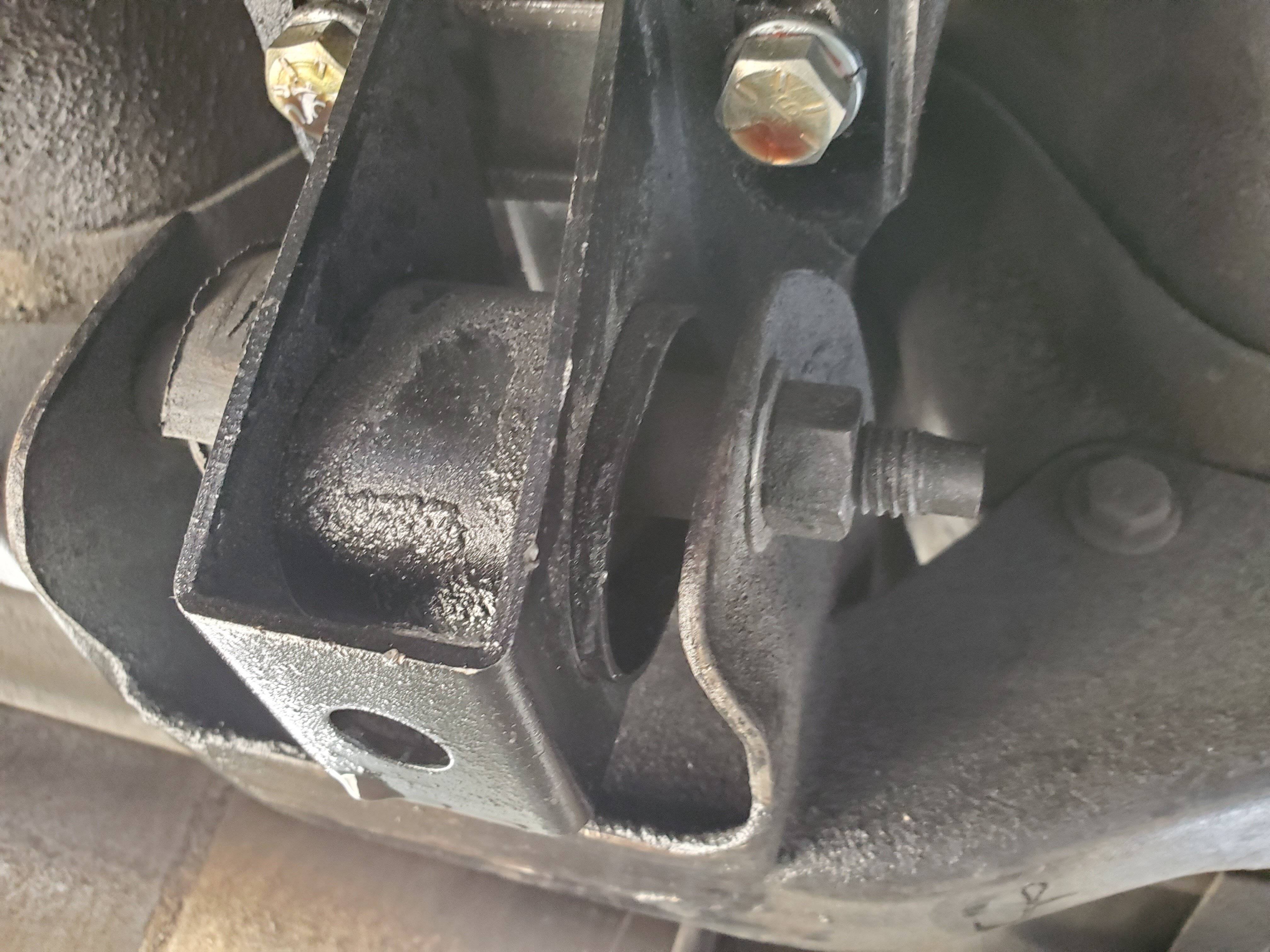

If you have a vibration when reving the engine while parked then I don’t think it has anything to do with the driveshaft.
The engine mounts look okay. The trans mount is suspect. The rubber is off set. The trans fluid is from the speedo.
