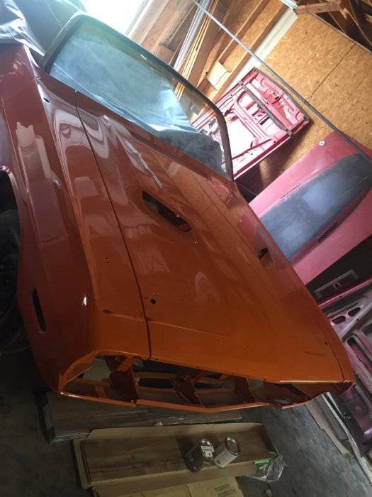

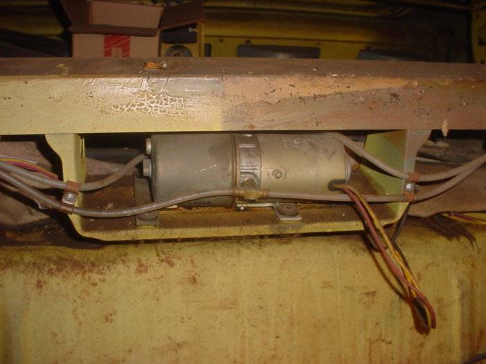

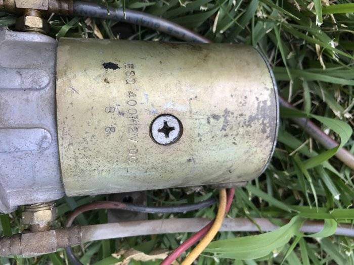

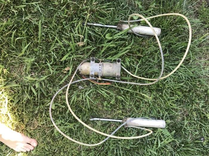

Thanks, Previous owner painted it, go mango as per tag. Then passed away and family sold the car disassembled so I got very lucky to find it. Here’s my original power top pump and your giving me thoughts of trying to use it as is..
340challconvert
Feb 13, 2011
5,356
2,861
Parsippany, NJ
You can test the motor. It is nice to have the original date coded unit and it can be rebuilt.
I would change the plastic fluid lines though!
I worry about mine leaking; I have never disassembled the lines, but did find fluid on the floor when I took my car out of storage a few years back.
Are your cylinders in good condition? They are available to purchase if needed, along with the lines.

That's awesome. We better see you on Woodward in 2020! I'm trying to finish all the last little things and I need to put some miles on it to test all the systems for safety before getting on Woodward.
My lines looked good at first, but then shattered like glass when I started to bend them. GET NEW. Hydro-E-Lectric made custom length lines for no extra charge. The off-the-shelf lines are TOO long.
Also my cylinders looked ok also, but the tops are plastic and the repro ones are metal. I already assumed the plastic and inside seal might leak so I bought the repros. YOU DON'T WANT TRANNY FLUID SPRAYING ALL OVER YOUR CAR!!!

My motor is working fine so far. Yours probably is. I didn't restore it yet because it looks kinda cool original. Make sure you bleed the system. Look on-line for tips. Again protect the car from the tranny fluid.

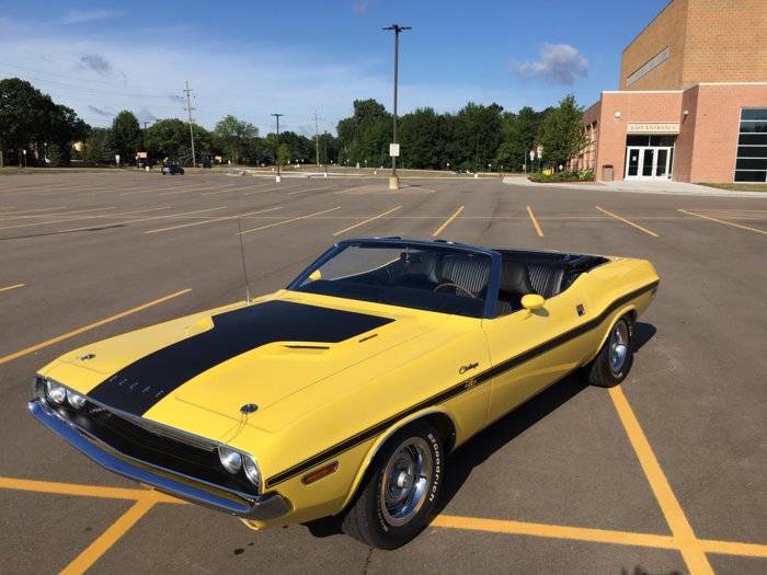

Today is Woodward Dream Cruise!! Been saying I would make it there for the last 25 years since my wife and I went to the first one with her convertible Cutlass.
Challenger is far from done. Too much to list. Just got it on the open road this week for only 5 miles. Got some work to do. But, the plan is to get over to Woodward (20 minute drive) to say I finally made it.
Wish me luck !!!
doubleyellow
Aug 3, 2015
331
90
Metro Detroit

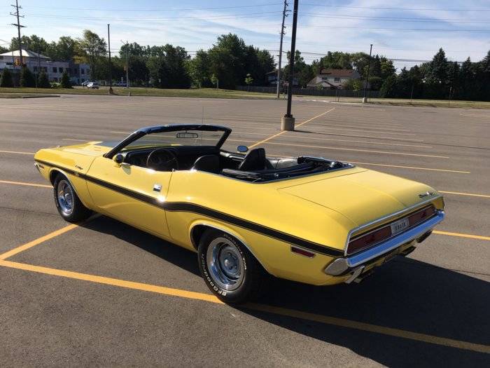

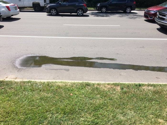

Well, I made to Woodward.......drove a few miles from Pontiac to Birmingham.
In Birmingham, all the cruiser traffic slows to a crawl. Thought car was running fine, then the temp gauge spiked to "H". Has to stop right on Woodward. Thanks to all the Mopar people that ran over to offer support. Charger R/T owner had extra coolant. After 30 minutes car started and I was able to pull in a side street. Amazingly there was another E-Body Convertible (1970 Cuda, 383, Red, Nice car) and the owners there. All the big block Mopar people were saying they also overheat in these conditions (90 degrees + parking lot).
Very embarrassing and frustrating, but silver lining we met a bunch of super nice Mopar and Muscle car people.
Anyway, I'll be looking for some troubleshooting tips and cooling recommendations soon.
Be back to Woodward and other cruises soon (may take a gallon of Prestone next time)!!

Glad you made it out and the local Mopar community pulled through! I was out there without my car as its still a ways away.
I am debating what cooling system to run at the moment.
Describe your cooling system. Stock radiator and water pump or something else, fan shroud? What water pump and t-stat?
