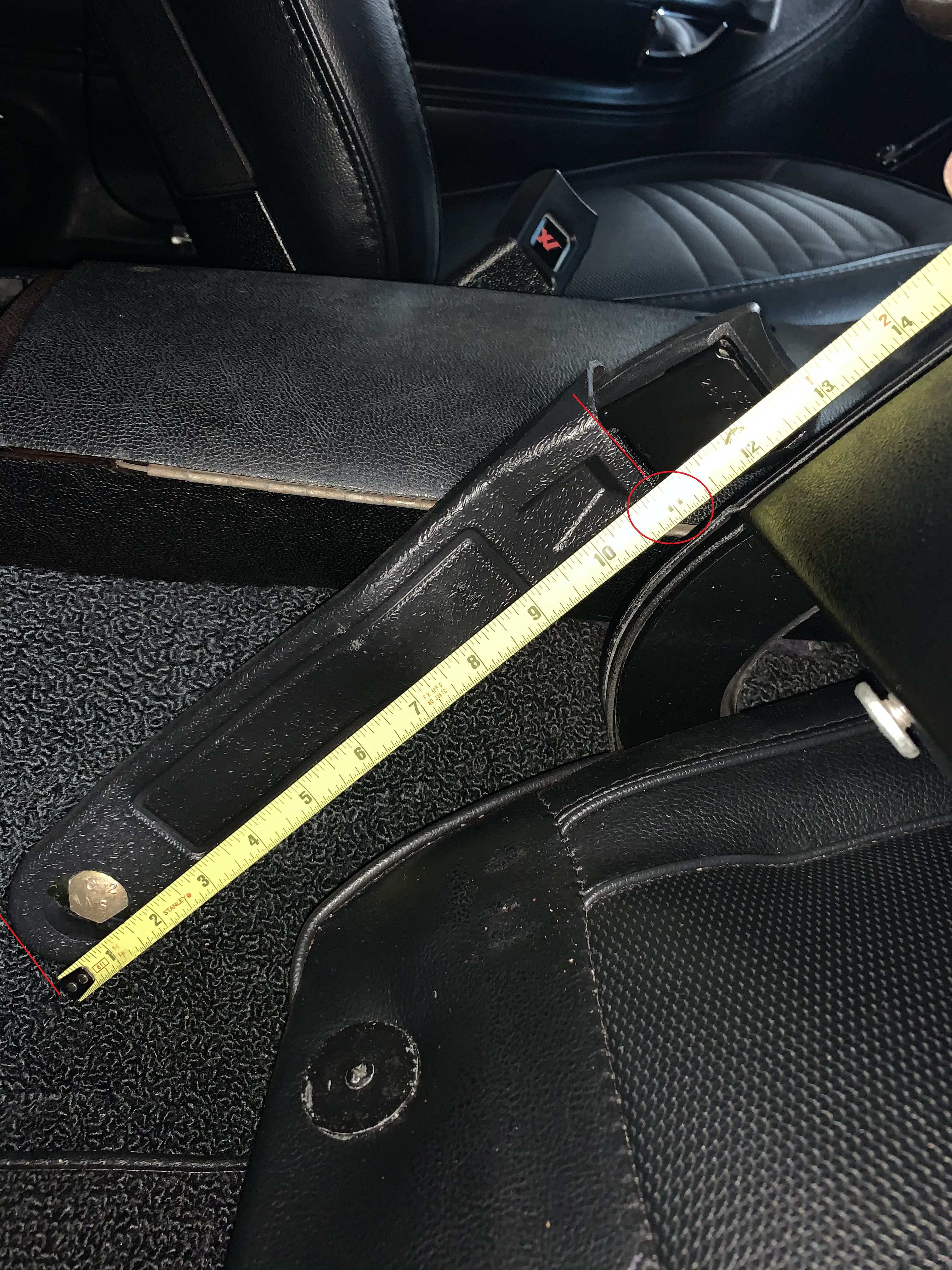

Wesco Performance has 3-Point Retractable Seat Belt kits that work with E-Bodies. XV Motorsports sold these a few years ago with their logos but does not offer them anymore.
The setup is easy to install. Use the 11" Bucket Seat End at the console area and the 8" Long Sash Guide at the original shoulder belt bolt at the headliner.
Less than $100 per seat.

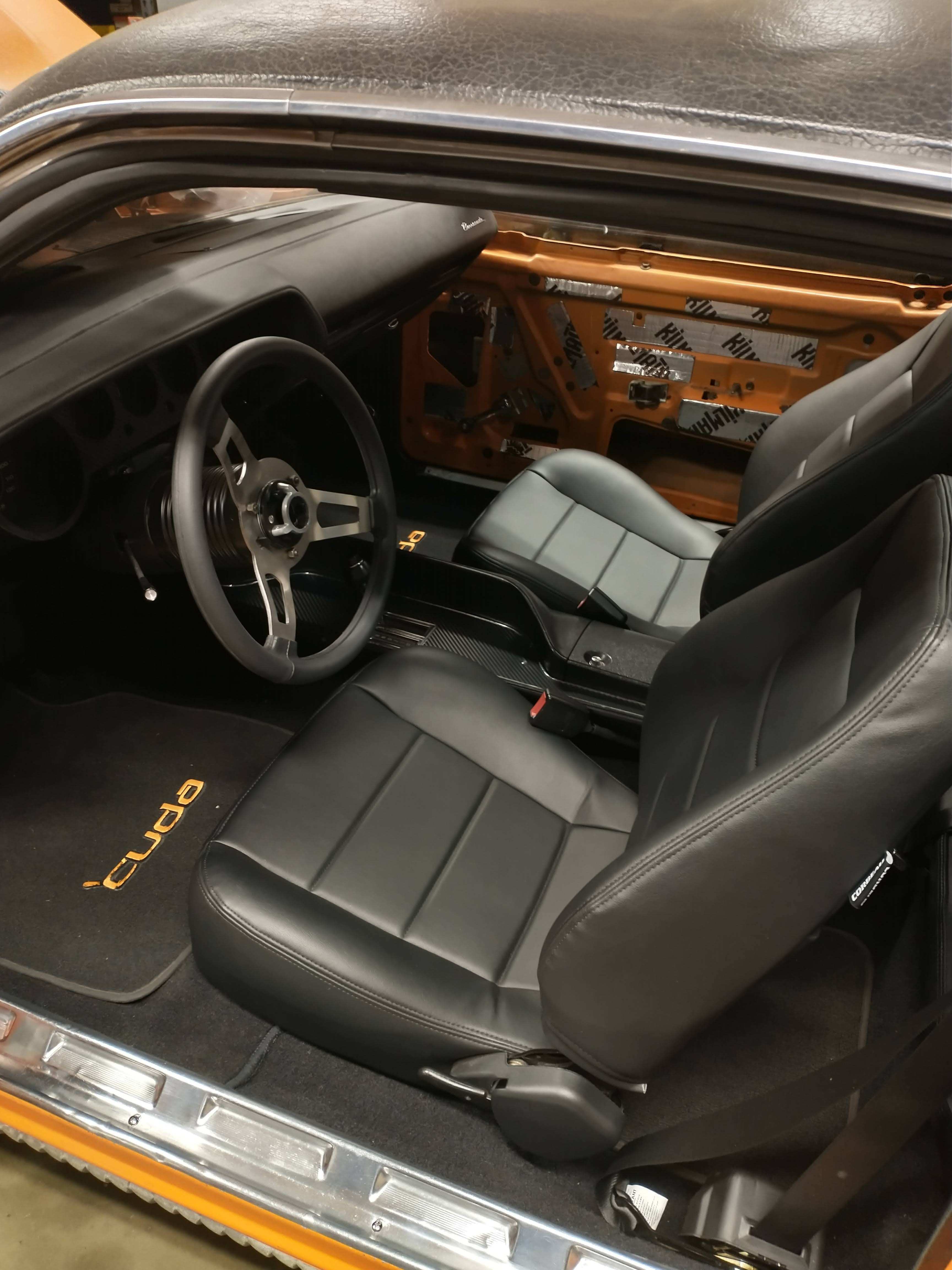

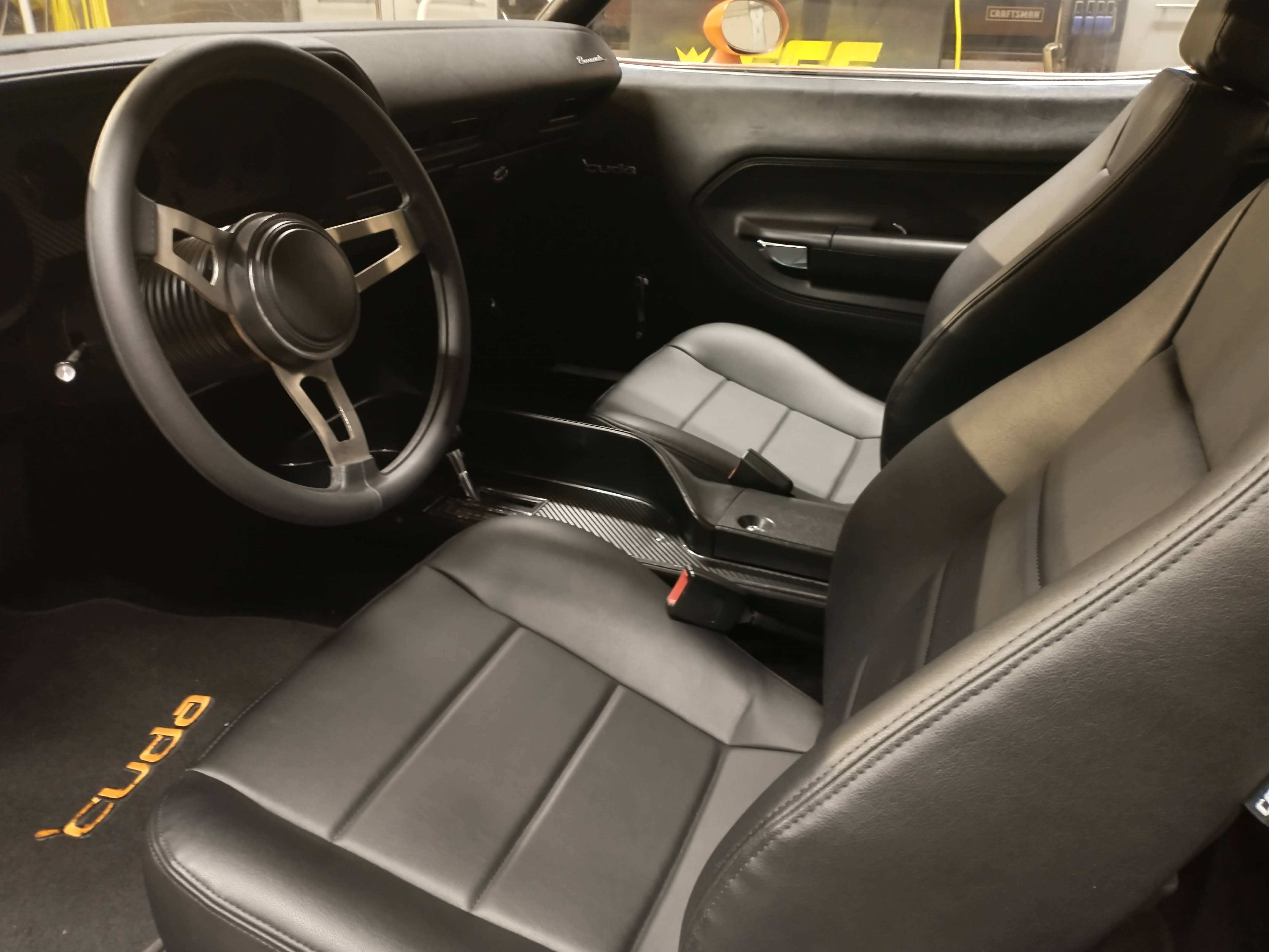

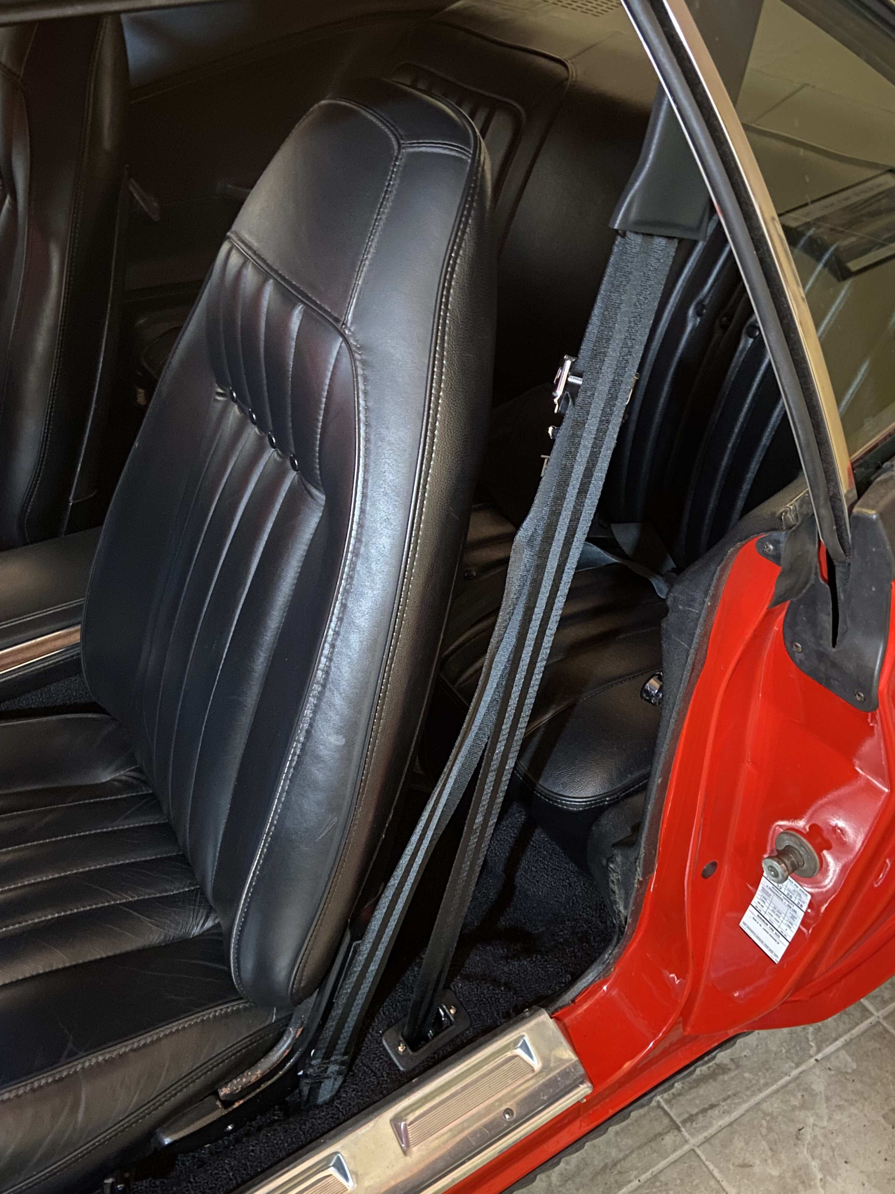

I swapped out the oe seat belts for custom ordered ones from Seatbelt Planet in my 70 Cuda. I ordered belts for 71-74 E body. Seatbelt Planet is 30 miles away from my house.
I chose the new style buckles with the red buttons since most people aren't familiar with the oe aircraft style Chrysler used. I special ordered the solid shaft buckles for the front seats as I don't like the plastic sleeves. I also swapped out the front seats for some by Corbeau with good bolsters and adjustable backs and headrests. I don't carve canyons but can assure you that this combination will definitely work for you.
Cuda360-4
Jul 1, 2023
61
27
Reading, PA

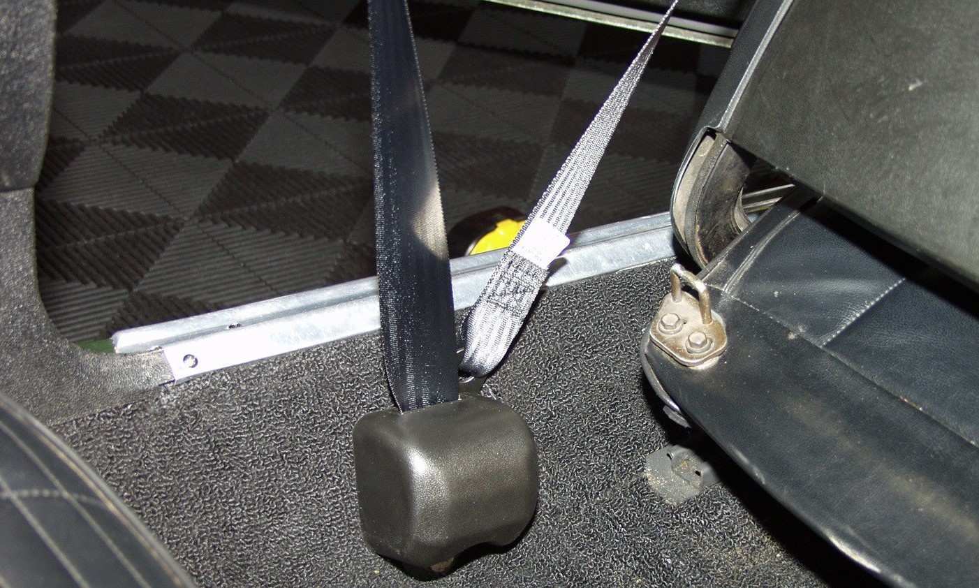

I mounted the real under the carpet like the original lap belt because I couldn’t stand looking at that box hanging there, but it has to be a reel that will work without being level.
You should use the carpet for the 1970 model since it includes a hump to cover the reel. There's also a white molded plastic piece that goes between the reel and the carpet for a smooth transition.
Cuda360-4
Jul 1, 2023
61
27
Reading, PA
Yes. Exactly what I did, but you have to change the angle. The reel feeds upward instead of leaning forward, so a new slot had to be made. There are two belts exiting the floor now instead of one.
