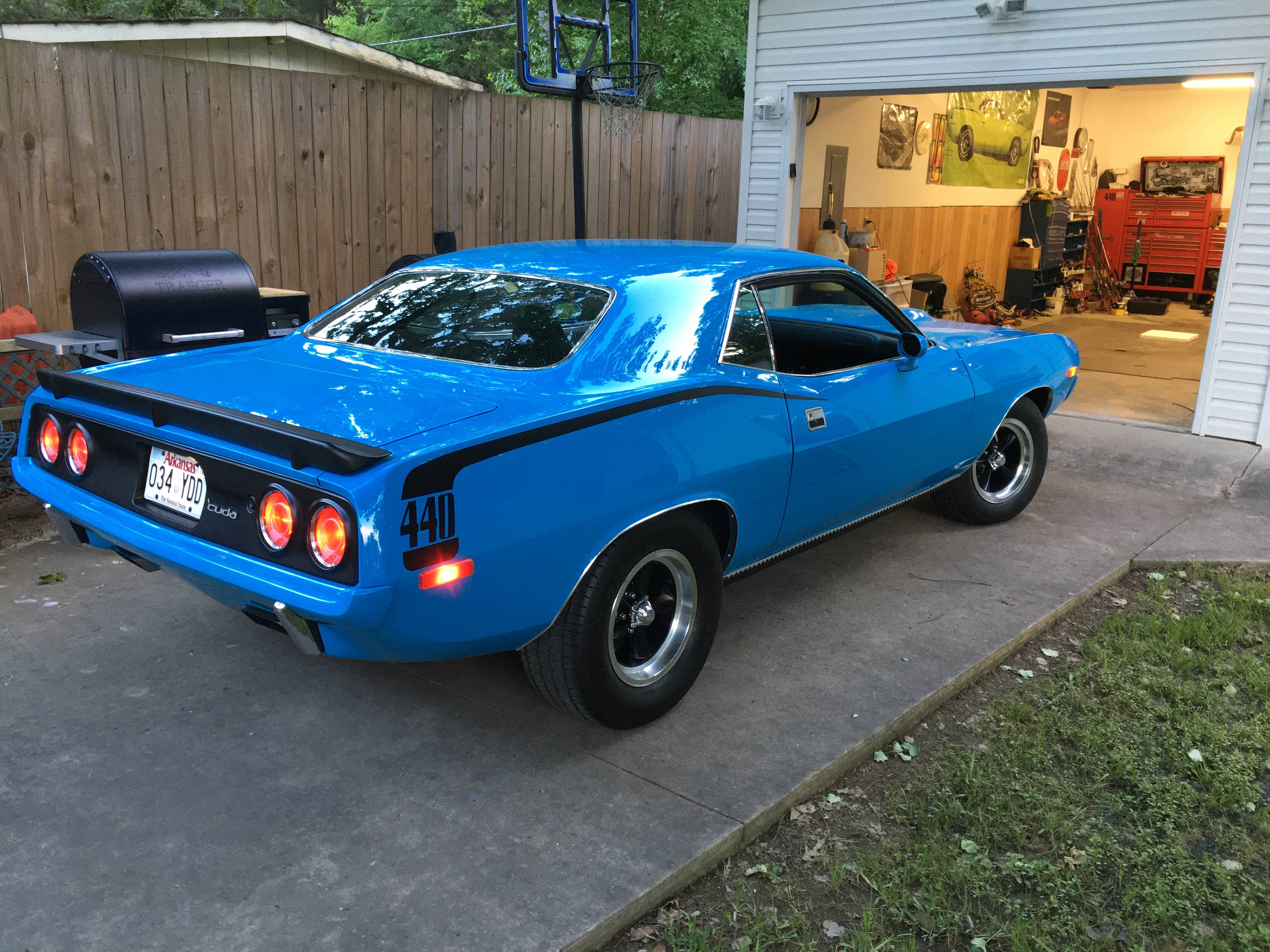

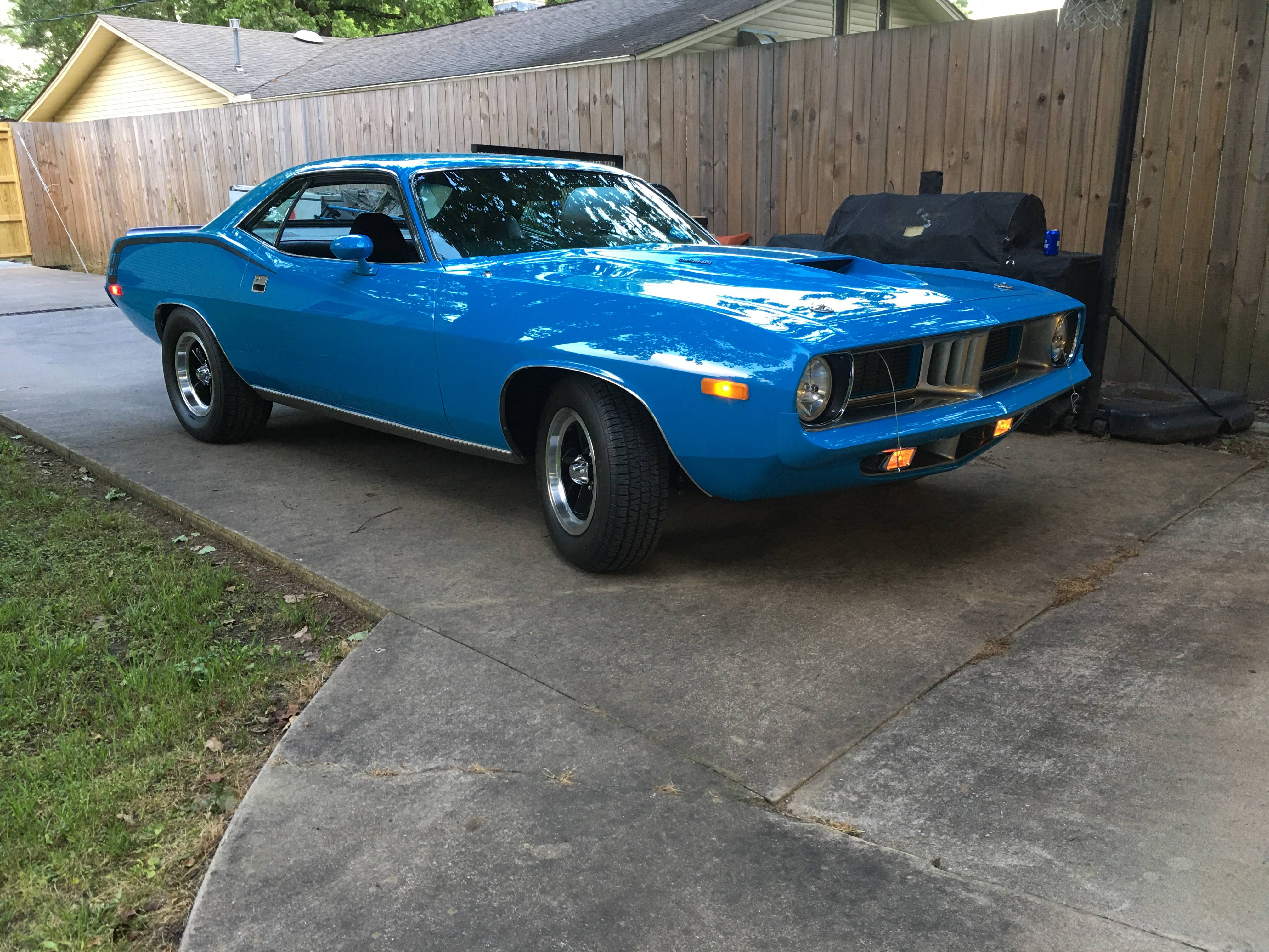

Years ago ago I had the front fiberglass bumper on my 73 cuda. Looked good. If you go that route, definitely use the rebar.
I changed front and rear to elastomeric. It’s expensive! 6PRTSE has a good point. Tighten the bumpers up the body, weld and grind down the bolts and paint.
The fiberglass will move around from idling or driving and scuff the paint.
Good luck to you earlier way. Let us see it when you’re finished.
