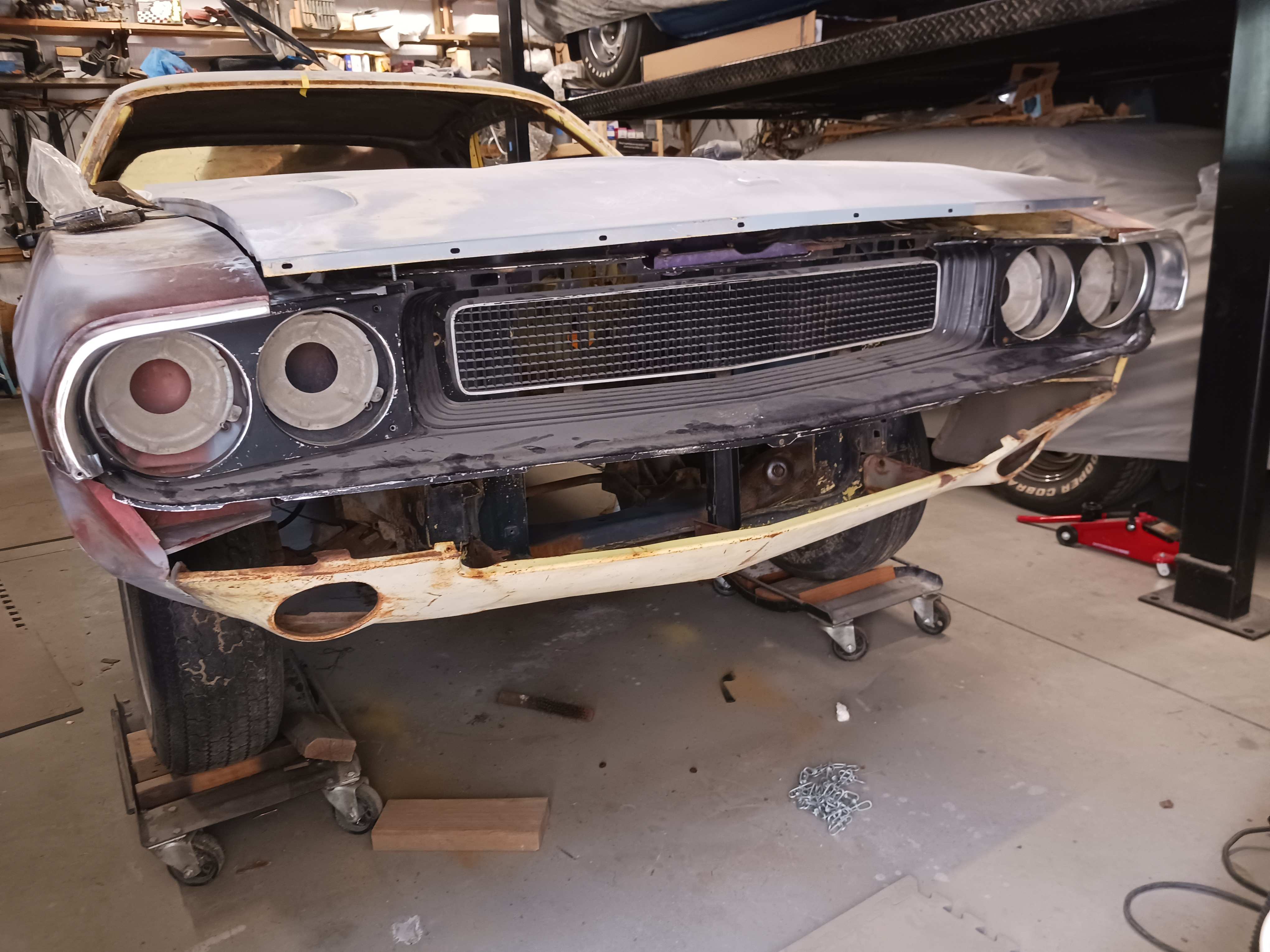

1971 Challenger grilles are very hard to find. A 1970 grille is much easier. Both require changing to the 1970/71 front fenders to allow an easy headlight installation. Headlight bezels are required for 70/71 grille. Changing of the fenders requires different side marker lights and wiring harness. A 72 bumper will work but if you're getting a better bumper, may as well get the right bumper. a 71 requires an upper grille/latch support. A 70 requires some different brackets than a 72 front end. This is a quick rundown. I have a 72 Challenger I'm changing over to a 70 front end. I've added the R/T hood since this photo. This was just a fitting of the parts I have.

I agree it is probably more work and money than it's worth. I had the 70 grille ( 3 of them actually), headlight bezels, fenders, braces, R/T hood, etc. already so it is costing me nothing to switch from the 72 front end and my car was missing the entire front clip anyway, so... Enjoy your car.
