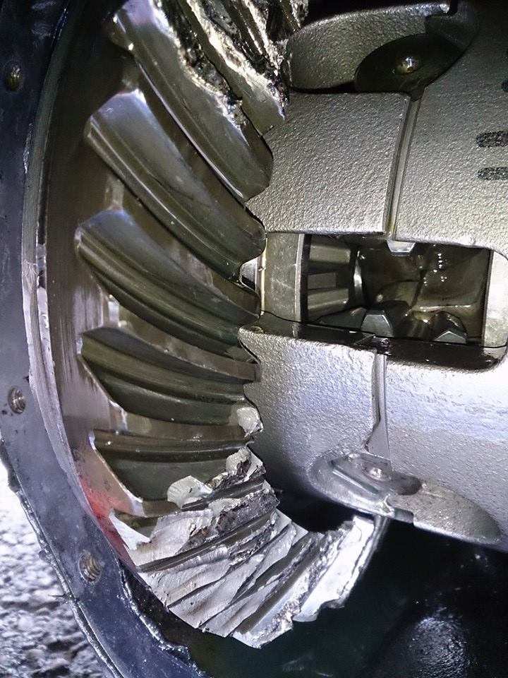

The only gearset that I have broken was a 7 1/2" in my street/strip Regal with a 11 to 1 built 350 chebbie and 4.56 gears. With the 4.56s the pinion has only 9 teeth as I remember. The car ran 11.50s with the front wheels about a foot to 14" in the air.
With the 3500 convertor it ran for about a year before spontaneously removing ALL of the pinion teeth. I replaced the gears with a set of 4.11s (10 tooth pinion) and never hurt it again.
I am no fan of the Dana 60, as it too has a very deep (even more than a 9") hypoid distance, and has an even heavier deadweight than the 9".
I believe that quality bearings (Timken) and Richmond gears along with a perfect contact pattern are more important than type of rearend.
