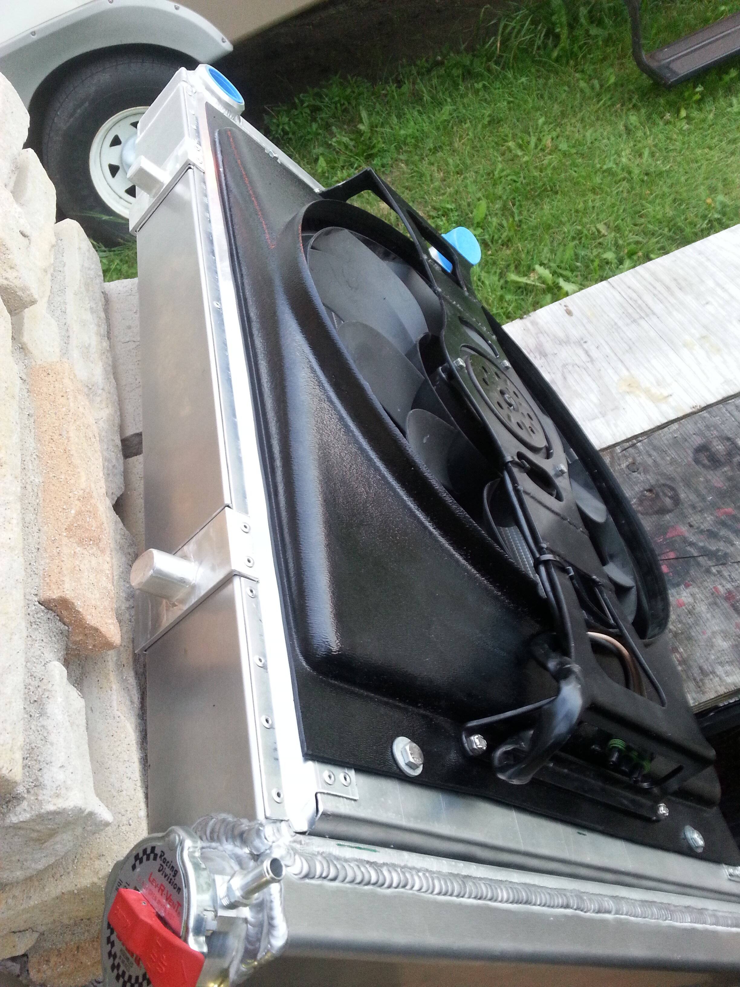

The pusher could create more problems than it solves. I run a readily available/affordable $140 Ford contour dual fan with a Dakota controller. Contour comes with its own plastic shroud that’s easily modded for rad hose clearance. The central gap in the dual fan allows me clears the crank/water pump pulleys. Survives Hotlanta temps and 2 Power tour long hauls without issue. For fuel temp concerns I run a return line using a regulator the emission evap line.

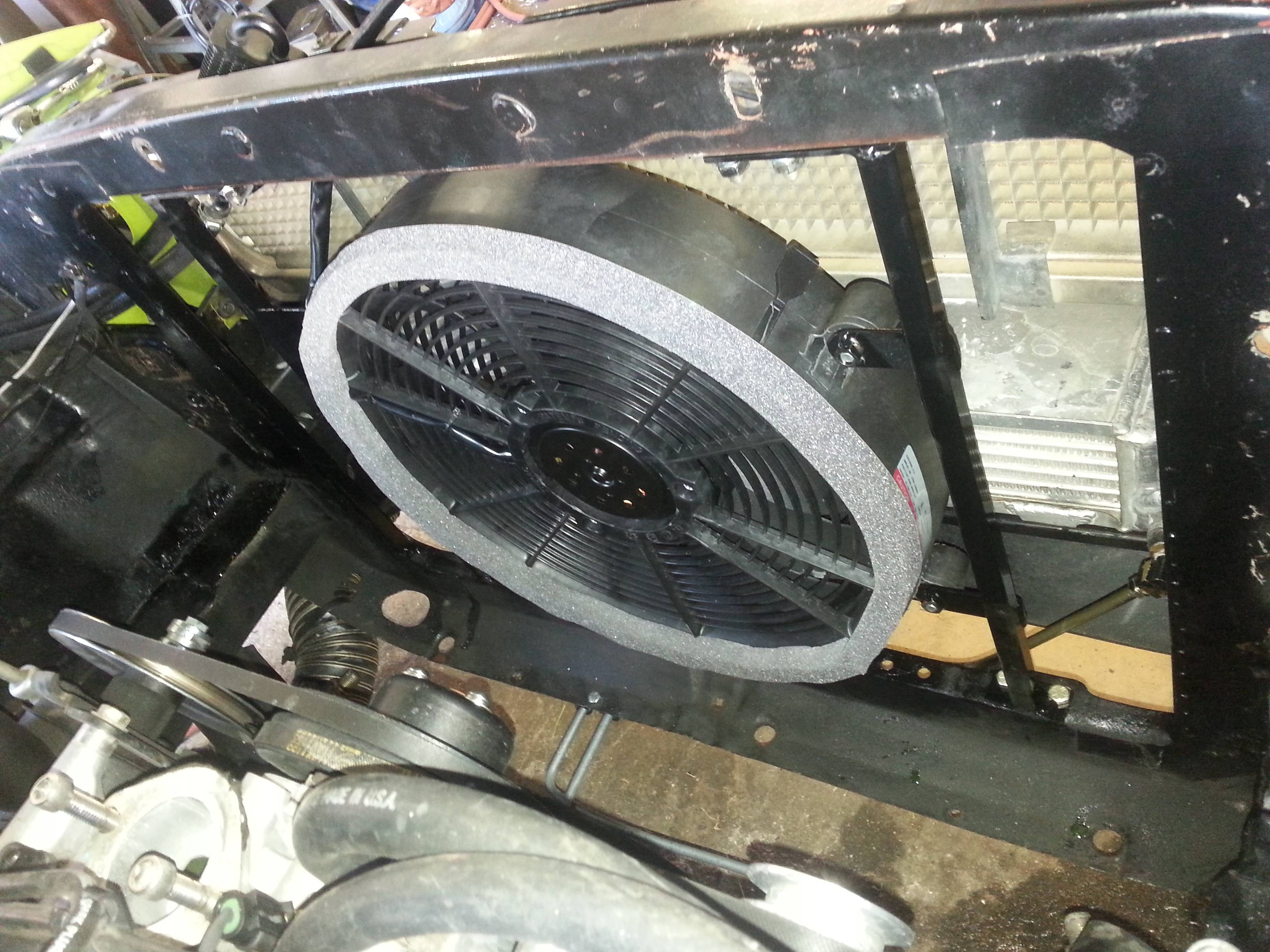

I used to run a solid fan and have since switched to a clutch fan with a elect. pusher upfront. I find the electric pusher does a great job in bumper to bumper trafic or long idleing periods. My fiberglass hood does not touch my upper rad support at all (allmost a 2 inch gab). I would love a duel elect. Fan setup but their too expensive for me. My fan is from summit with a derail adjustable fan controller with manual over-ride. I would measure for height/width and get a fan with the most cfm. I battled with running hot for years and my current setup works. I have even used a engine oil cooler (also works great) but I have since removed it.

My notes say I have a 16” Electric fan SUM-381008-3 I just checked summit and it is not popping up. I would just get something in the 2000cfm range. Also for me, just the electric fan did not do the job, i am guessing due to the "extra gaps" I have so the air isn't forced thru the rad

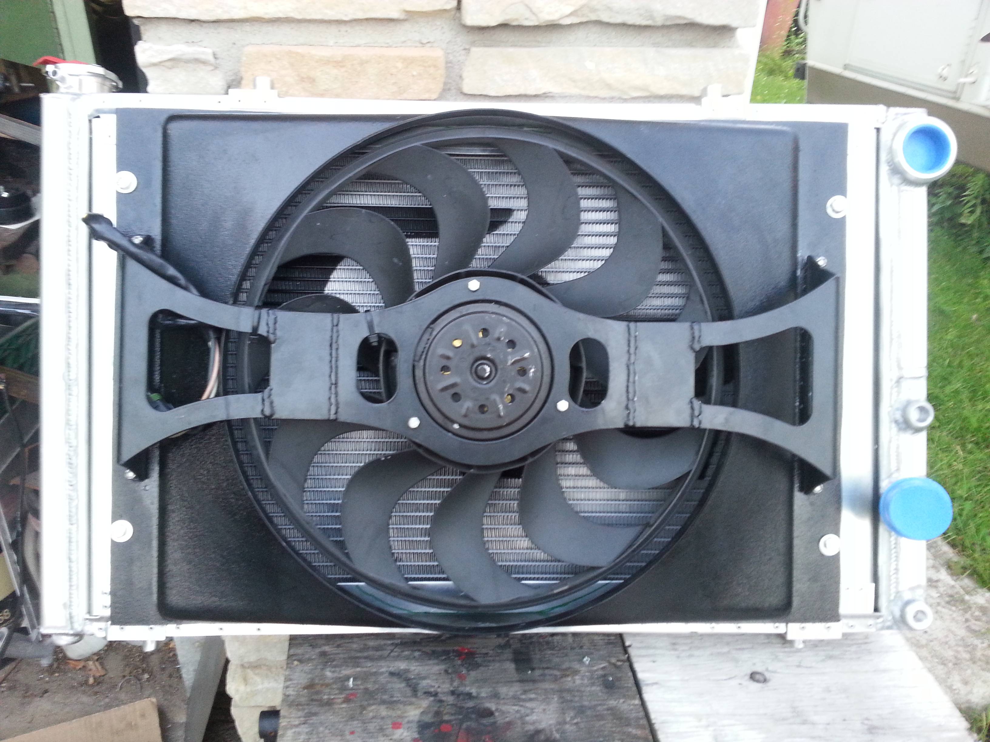

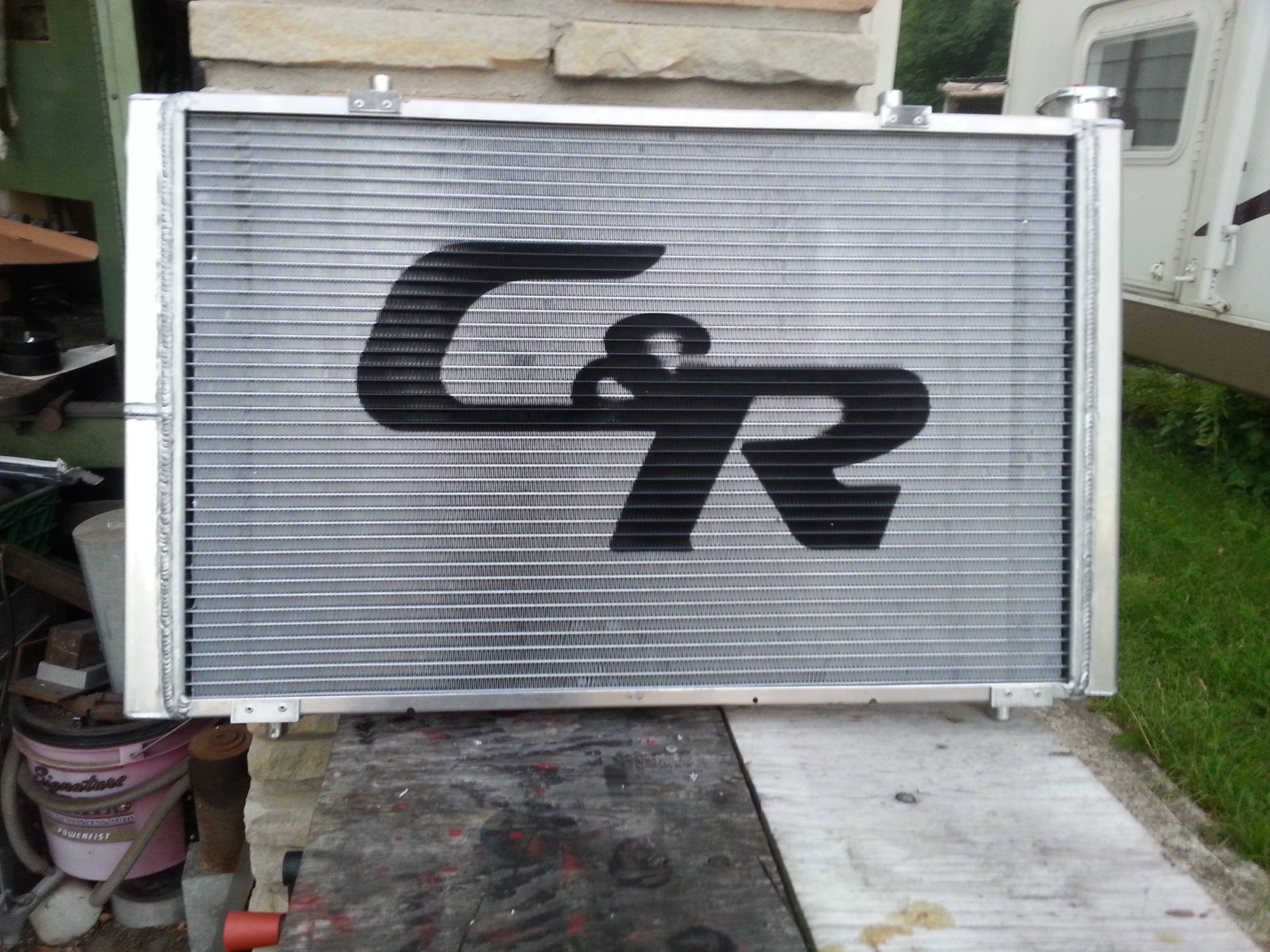

Here is my fan

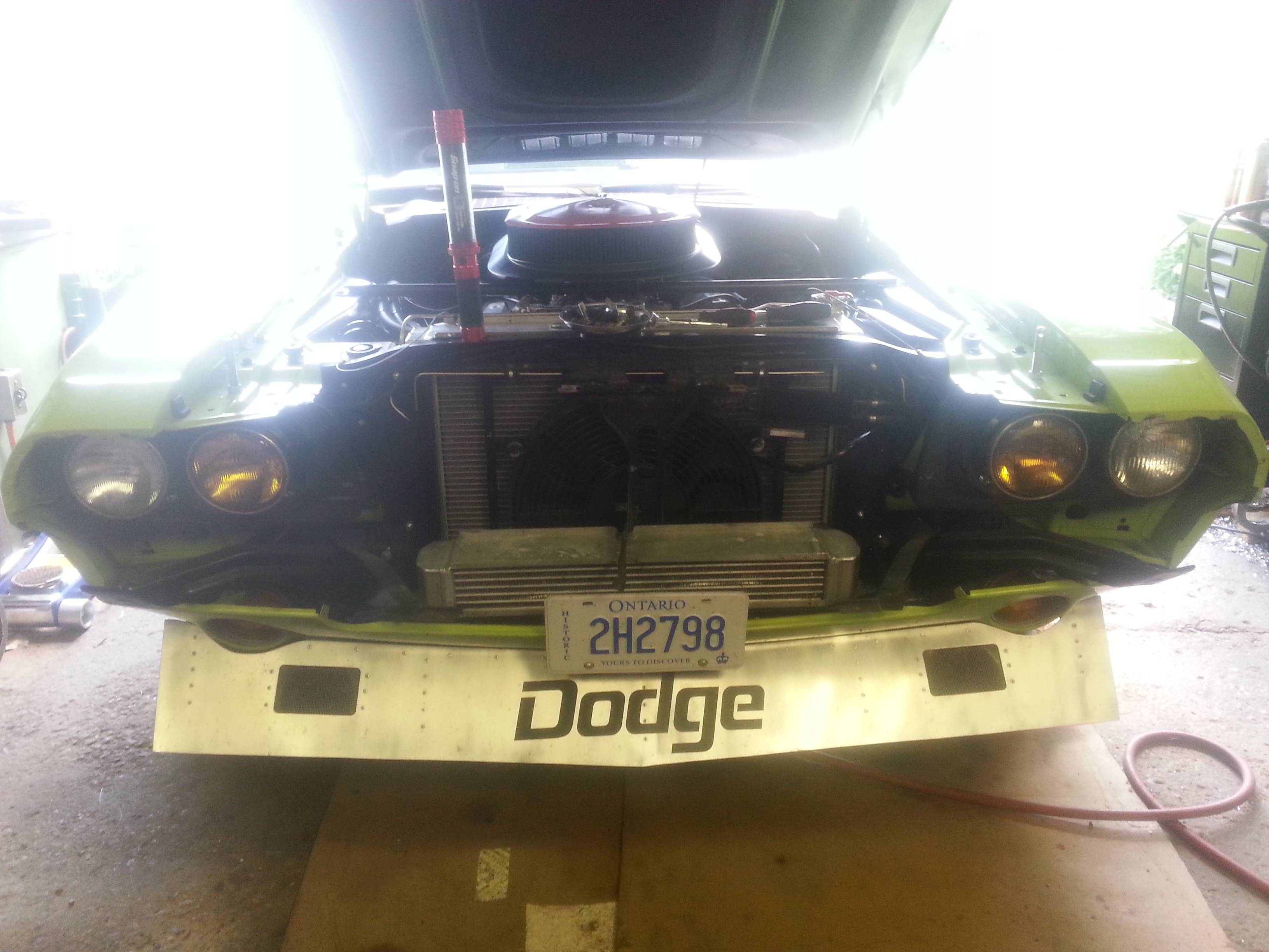

This is my set up, been on the car for over 10 years now, never overheats. Using a dakota digital fan controller to control both fans. Fan on rad comes on at 195, one in front comes on at 200. Works great never had an issue. Got them both from here years ago at Carlisle. Rainbow Products Online | Nationwide Distributor of Automotive A/C for older and newer model cars
I see now they have sold the fan part of their business
