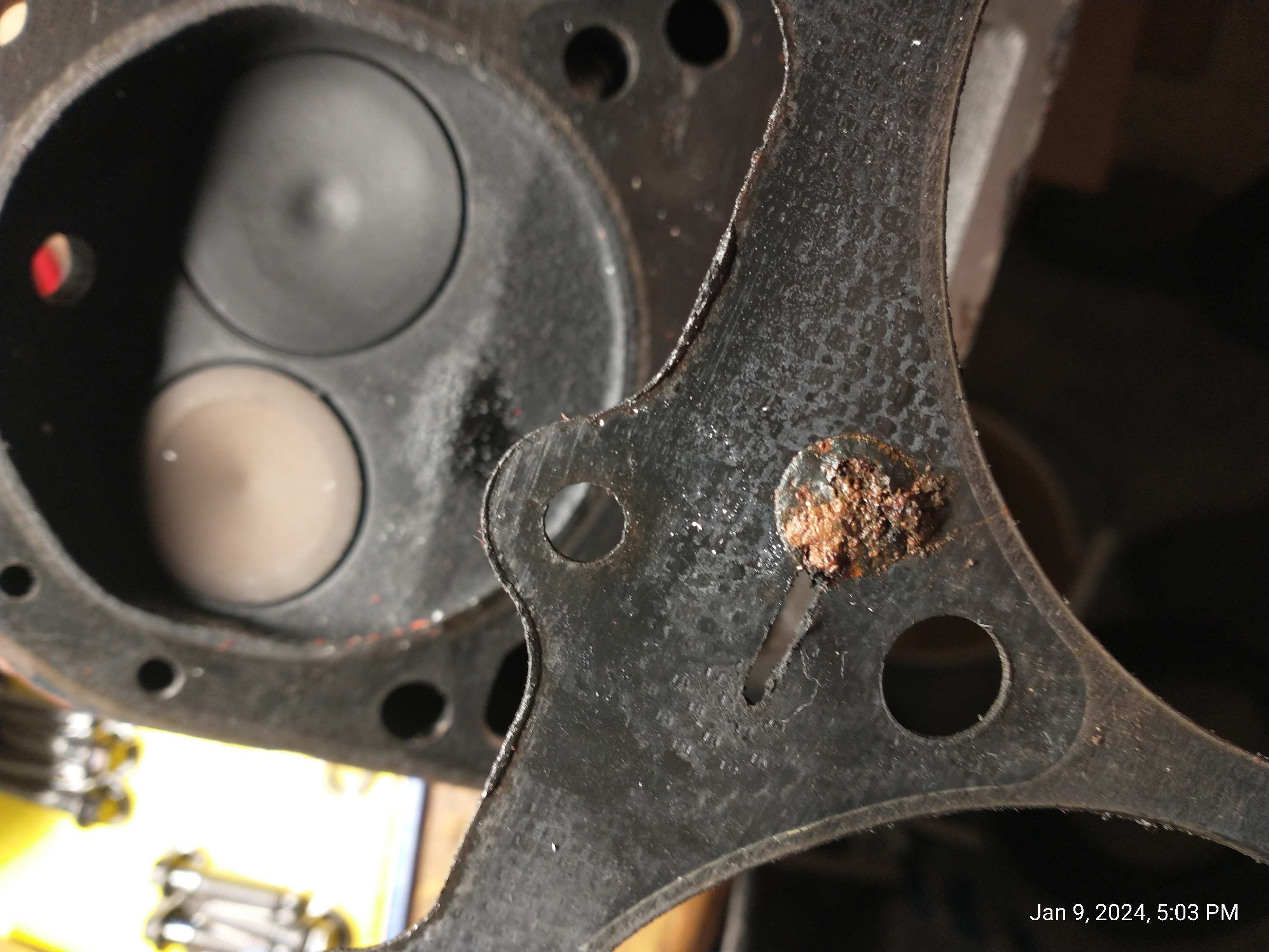

My cars temp seems ok but can't help but wonder about the updated aftermarket head gaskets that replace the top holes with slits like the BBC but aren't even over the passage. Most of mine were blocked shut by rust or the teflon coating from the head gaskets sticking to the block. I read where that's to force coolant to the back cylinders but why then in '75 or so did the blocks came with a figure 8 hole design, seemingly doubling water flow thru those passages...?
