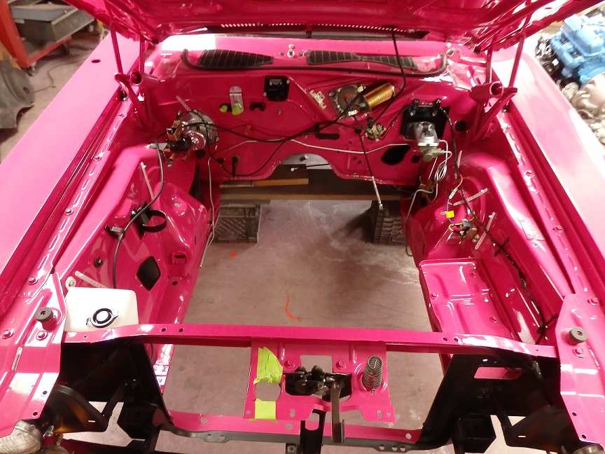

Does anyone have a diagram or pictures of the engine bay wire harness hanger locations? Basically what type of hanger goes where to secure the wire harnesses to the firewall & fenders. I’ve got a new hanger kit but it came with no diagram.

I'm restoring a 70 with a/c so I had saved this pic for a reference a while back, assuming you're doing a 72 a few of these may be in slightly different locations on your car - like one or two of the heavier black clips moved slightly on the firewall for 71 & up, etc. - but should give you a good idea of what goes where. Post some pics when you have everything where you think it should be and I'm sure we can all help you verify.

Super helpful EV2RTSE! It is mostly the firewall and right fenter area that I needed a reference.
