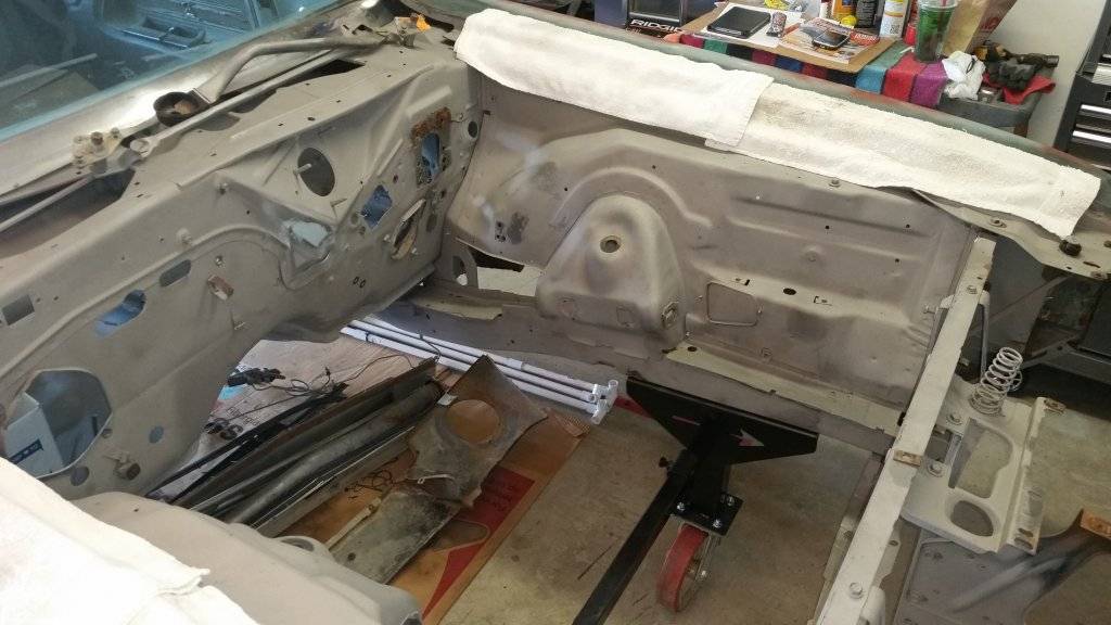

Here is a pic of the engine compartment

Thanks for that Moparleo.
Are there any pics of the inside of the engine compartment?

Not to be a smart a$$ about it, but where ever you want to. Probably at about where the firewall is would look ok.

Ok.
i got the firewall figured out.
It was just the sides where it meets the framerails.
your fenderwell shots were a big help.
thanks

I used the spray on duraguard and shot the rails complete except for the top surface which is easy to mask off. The firewall got shot up to the seam where the floor and firewall meet. Hope that helps.
