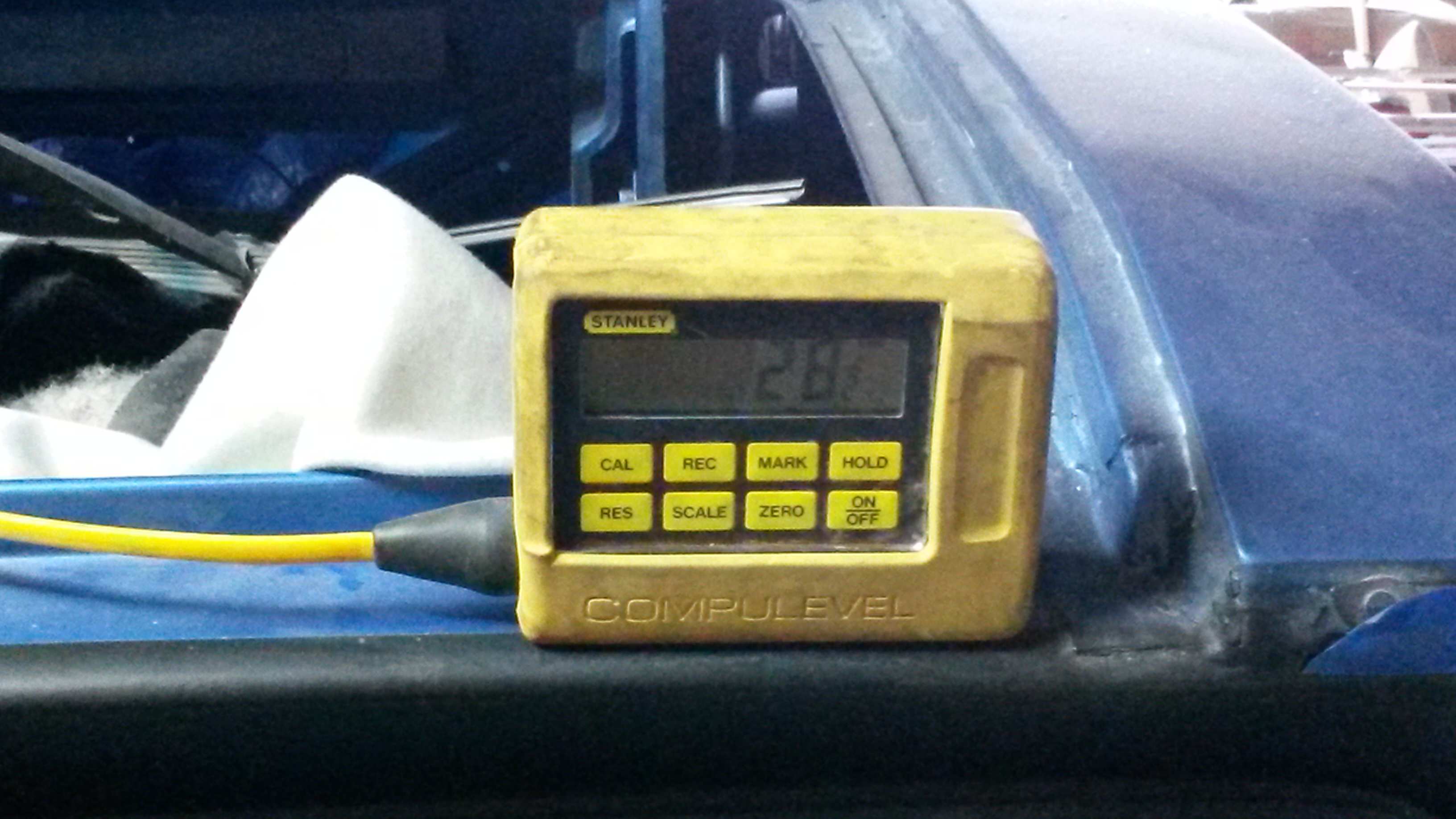

Are the photos showing the difference in height of the tail lamp panels?
In my current work situation, the heights of the tail lamp panel and trunk lid panel, and the heights of the filler neck panel and trunk lid panel are symmetrically matched.
In that situation, only the center of the left quarter panel is approximately 3/16 inch lower than the trunk lid panel.
