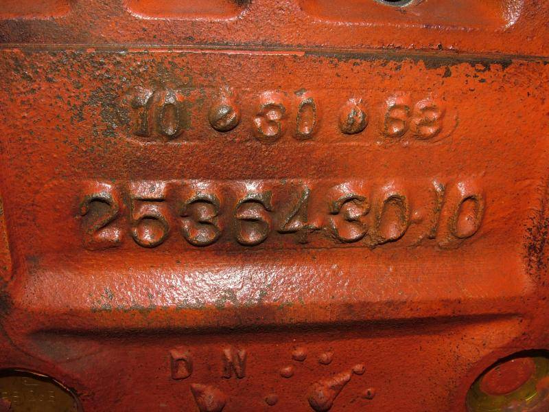

Just look at the side of your block. Just above the casting number should be the casting date. PIC attached. Sept 1970 is way too early for a 1972.

I would bet the block was re-stamped no way a block cast in June 70 should be factory in a 72 car but never say never

I agree the block was restamped. Post a pic of the stamping of the VIN.

well sadly I don't have to post a pic to tell you I was lied to about numbers matching everything matches but the motor...but at least I have the better motor I hope...
