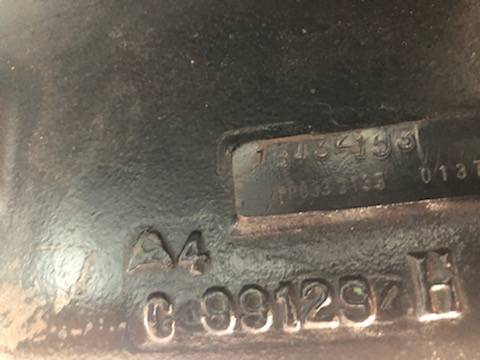

Interesting. Look how poorly the trans is stamped. The 2 is almost off the pad.
How do you read the lower set of stamping starting with PP? There’s a date in there isn’t there?
1 - 1971
B - Hamtramck Plant (built the car)
132153 - Car ID number
PP - New Process Gear Division Plant (built the trans)
833 - Manual 4 spd trans
3133 - 10,000 day calendar, Feb 24 1970
0137 - 137th trans built on Feb 24

1 - 1971
Wow. That’s amazing. Thank you.
Pretty early assembly date on trans for a vehicle assembled on September 8, 1970.

Pretty early assembly date on trans for a vehicle assembled in September 8, 1970.
Yep, I would agree with that. But maybe New Process built up several trannies ahead of time.
